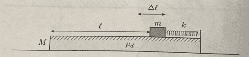

A block, with mass ##m_b = 1 kg##, is placed on a slab, with mass ##m_s= 4 kg##, which is able to slide without friction on the horizontal plane on which it is placed, as shown in the Figure. There is friction between the body and the slab characterized by a coefficient of dynamic friction ##μ_d=0.2##. The body is initially placed at the left end of an ideal spring, with elastic constant ##k = 600 N/m##, whose right end is fixed to the right end of the slab. The spring, initially compressed by ##Δl = 5 cm##, at a certain instant is released to expand freely. Assuming the bodies are initially at rest and knowing that the distance separating the body of mass m from the left edge of the slab is ##l = 20 cm##

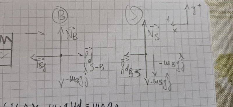

I'm taking as positive the left direction. I've analyzed both objects using the free body diagram and found that:

Thermofox said:
Homework Statement: A block, with mass ##m_b = 1 ## kg, is placed on a slab, with mass ##m_s= 4## kg, which is able to slide without friction on the horizontal plane on which it is placed, as shown in the Figure.
You could post the figure ...
There is friction between the body and the slab characterized by a coefficient of dynamic friction ##μ_d=0.2##. The body is initially placed at the left end of an ideal spring, with elastic constant ##k = 600 ## N/m, whose right end is fixed to the right end of the slab.
So: does the spring exert a force on the slab?
The spring, initially compressed by ##Δl = 5## cm, at a certain instant is released to expand freely. Assuming the bodies are initially at rest and knowing that the distance separating the body of mass m from the left edge of the slab is ##l = 20 ## cm

Please post your free body diagram(s?)
Are you saying block and slab are moving in the same direction ?
I forgot to post them, sorry

I didn't think that the spring was also connected to the slab.
"whose right end is fixed to the right end of the slab"
Say it to my mind....

haruspex said:
I assume ##v_{initial} ## and ##v_{final}## are velocities of the common mass centre, in which case …
… no. You cannot add velocities of the different bodies like that because the masses are different. What you can add are their momenta.
##m_s v_{s,f} + m_b v_{b,f}=0## because the system was initially stationary.
Thermofox said:
a) 0 kgm/s
b) 48 kgm/s
c)-48 kgm/s
d)-8 m/s
That's right. Now think of the slab and block (from the original question) as 2 parts of a 'bomb'.
The momenta of the 2 parts will be equal in magnitude and opposite in direction. So the velocities (and hence displacements) of the 2 parts are related.
##m_b v_b= - m_s v_s## => ##v_b= \frac {-m_s v_s} {m_b}## => ##x_b= \frac {-m_s x_s} {m_b}##?
Since i know the masses, ##v_b= -4v_s##. Now I just need to determine ##v_b (\text {or}\space v_s)## and I can do that by using the energetic balance: $$\frac 1 2 m_s v_s^2 -2 m_b v_s^2 - \frac 1 2 k \Delta l^2 = - W_{\text{friction}}$$
Is the work done by friction, ##W_f= \Delta l \mu_d g m_b##?
Yes.
haruspex said:
Yes.
Now can I say that ##W_{\text{friction}}= \Delta l \mu_d g m_b##?
I'm not sure because the work is done on 2 surfaces that are moving.
This means that the center of mass of the system is not moving and I can visualize that because the block and the slab are moving in opposite directions. But what would happen when the block falls from the slab. Is our system still valid or as soon as they detach, they can no longer be considered as a system?
  • #31
Yes.
Depending on the frame of reference you choose, you could consider that the block moves ##x## one way and the slab moves ##\Delta l-x## the other way. So the block does work ##\mu_kxm_bg## against friction while the slab does work ##\mu_k(\Delta l-x)m_bg## against friction. The total work done against friction is always ##\mu_k\Delta lm_bg##.
You understand that you do not need to consider that, right?
A system is whatever you define it to be.
Certainly it will behave differently after detachment.
  • #32
The question does not ask about what happens when the block falls from the slab. It wants the velocities at the moment before this happens.
  • #33
Yeah, I perfectly do. I was just a thought I had, nothing more.
Ok now I understand it, Thank you immensely!
  • #34
Yeah I do realize that, It was just an "if case" I had.
