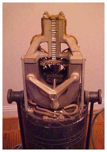

Hi here,
I am trying to make an efficient ribbon microphone motor.
My target is to get a highest possible output voltage so it can be plugged into a regular mic pre-amp.
It should have possibly flat output on frequences 20Hz to 20KHz.
I know that electric output depends on magnetic field B and velocity of a wire in it. (and velocity is proportional to frequency and amplitude.)
So target is to achieve highest possible B in air gap where ribbon oscillates.
I've made a model of motor using Gmsh and GetDP. It shows more than 1 Tesla in the gap, and as high as 2.5 T in core tip. I plan to use cobalt-iron core because of its high saturation capabilities. But I also read that it is not very good for high frequences like 20KHz because of Eddie currents.
My question is, should I consider to suppress Eddie currents that should appear in the core as a reaction on movind a wire in B field?
Is my understanding correct that Eddie currents should appear in this case?
Will be Eddie currents significant enough at high frequences (5KHz-20KHz) that I should take precausitions to suppress them?
I have this concern because all microphone/speaker motors I saw were made of just solid soft steel, not of electrical steel laminates like transformers are.
Is my concern about Eddie curents valid?
I am not sure how to calculate Eddie curents/losses in core for my case where a wire moves in mag field.
What portion of it will produce a voltage in the wire and what portion will impact mag field B so it will create Eddie currents in core? If such proportion exists, what it depends on? Does it depend on frequency?
Could you please advise?
Thanks,
Mark

Here on this picture B is saturated in inside tips of pole pieces, but usually saturation disappears in wider outer volume of pole pieces.
Will that not saturated field that is located in outside volume of pole be modulated by ribbon movements while the field in insider narrow pole tips is saturated?
Other words can modulations of B be transmitted via saturated field areas to farther not saturated areas?
Another thing, according to my GetDP model, B decreases below saturation point in very internal volumes of pole tips, that touch air gap, on surface and a little bit deeper. That means that very tips of poles are not saturated and flux can be modulated in them. Volume of these areas is not very deep, and area is not wide, but still it may impact system on high frequencies, I assume.
So, even despite of saturation in major part of pole, Eddy currents may appear on pole tips internal surfaces and a little bit deeper.

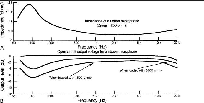

Consider relative currents in the ribbon for motor vs microphone.
Current that doesn't flow can't cause eddy currents elsewhere.
Hence the advice to present a ribbon mike with high impedance preamp.
A typical 250-ohm ribbon microphone may have an impedance modulus as shown in Figure 8.12A. As long as the microphone looks into a high impedance load, its response will be fairly flat. When used with a modern console having 1500 or 3000 ohm input impedances, the frequency response will be altered as shown at B. Moving coil dynamic microphones can also experience similar issues. This is a response problem routinely encountered today and frequently goes unnoticed.
courtesy this free book preview:
http://www.scribd.com/doc/100502271/Microphone
sound logical?
preamp is going to be tube preamp with very high input impedance, dozens of K Ohms, according to http://www.aikenamps.com/CommonCathode.htm
Does it mean there will be practically no current in ribbon, thus no currents in core?
That is what I believe.

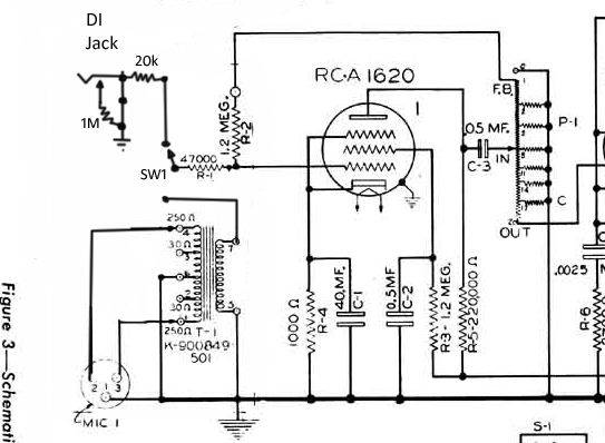

Here's an appnote for your audio circuit collection:
http://www.triodeel.com/7199.htm
I find it hard to believe that a ribbon mic (without a matching transformer - which they were always fitted with afaik) could have as high an impedance as that graph suggests. It only consists of a single turn of wire, effectively. Where could 250Ohms come from, let alone nearly 2k at low frequency. The magnets they used were old fashioned low flux type. Were they really like that in the early days?
Hmmm looks like you're right on as usual - the old timers used transformers..
http://www.coutant.org/ribbons.html
The active element is of course the ribbon, consisting of a very thin corrugated aluminum ribbon clamped under light tension and mounted between the poles of a strong magnet. The extremely low impedance of the ribbon (typically on the order of 0.2 ohm) is fed directly into a step-up transformer to match low-impedance lines (50, 250, or 600 ohms).
So - there's a transformer in the picture too ? the plot thickens...

So the old advice about connecting the ribbon microphone to a high Z preamp is to reduce the current demanded of it.
Doubtless those old-timers calculated the damping provided by electrical loading... and designed partly 'by ear'.

In your pre-amp schematic in last post, that input transformer I think provides noise rejection in addition to stepup. Pins 2-3 are differential input for the long microphone cord..
Here's all I could find on that transformer part number:
http://www.tomshardware.com/forum/48023-6-looking-transformer-parts
With today's opamps I would think you can get by with with one less transformer - but which one to skip?

Providing the optimum amplifier is not simply a matter of considering the volts. It's the Power that counts and how to match the source resistance (0.5Ω) best to the most appropriate amplifying device in the best configuration. The last thing you'd choose to do, I reckon, would be to use a bog standard Common Emitter, voltage amplifier, configuration. Common Base mode would probably be most suitable - or the equivalent thing with an OP amp. You want Volts out for Current Into a low input impedance. But I'm no expert in the details of low noise system design. It's never straightforward - I do know that! I'm pretty sure that you can do well enough without a transformer with the available devices.
