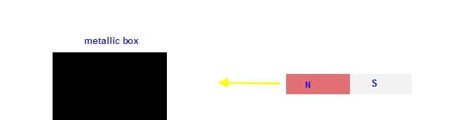

Please have a look on the attachment. The metallic block is stationary and the magnet is moved toward left at the speed of 1m/sec. It will induce eddy currents in the block because it experiences a time-varying magnetic field. But if the block is also moved toward the left at the same speed as the magnet then no eddy currents would be produced because there is no relative motion between the block and magnet. Do you agree with me?

Let's say that if a point on stator field completes, let's say, 400 degrees in one second then a corresponding point on the rotor completes 360 degrees. Is the difference of 40 degrees between these two corresponding points constant? If it's constant, it'd mean no relative motion.
It looks like that the difference is not constant. In first second, stator point covers 400 degrees and in next second, it covers another 400 degrees. Meanwhile, the rotor point covers 360 degrees in first second and another 360 degrees in the next second. The difference between the two points is: (2x400)-(2x360)=80 degrees. It means that the relative motion exists between the corresponding points. Please let me know if I have it right. Thanks a lot.
In this case there is a 40 deg/sec difference. Every second the relative position is changed by 40 deg. This means, that there is a relative motion.
So, again: at slip s≠0 there is a relative motion between stator electrical speed and rotor body. This relative motion between them is constant at constant slip.
This difference is 40 degrees per second.
Hence, relative angular velocity between stator and rotor is 40 deg/s and the slip is (400-360)×100/400=10%.

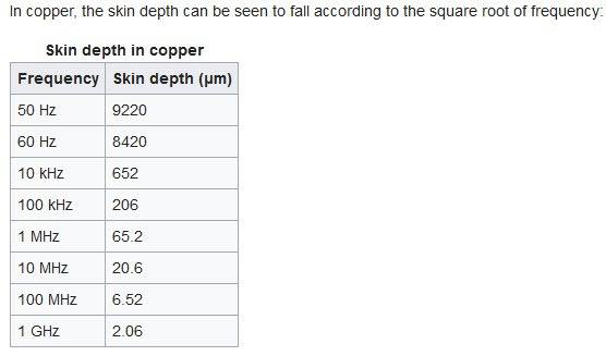

Hi,
I was reading further on eddy current and came across Wikipedia article on skin effect, https://en.wikipedia.org/wiki/Skin_effect. It says that the skin effect is due to opposing eddy currents induced by the changing magnetic field resulting from the alternating current. Its also says that at 60 Hz in copper, the skin depth is about 8.5 mm. The following table is an excerpt from the article.
Question 1:
Okay, at 60 Hz the skin depth in copper is about 8.5 mm but relevant to what? The skin depth is 8.5 mm if the copper conductor's radius is 20 mm, 100 mm or what? The article doesn't seem to mention this or I'm missing something obvious. Could you please guide me?
Question 2:
"Highly magnetic materials have a reduced skin depth owing to their large permeability μ_r as was pointed out above for the case of iron, despite its poorer conductivity. A practical consequence is seen by users of induction cookers, where some types of stainless steel cookware are unusable because they are not ferromagnetic." [Wikipedia]
I couldn't understand that how skin depth is related to the induction cooking. Then I reached the following section of Wikipedia article on Faraday cage: https://en.wikipedia.org/wiki/Faraday_cage#Faraday_cage
It says, "Faraday cages are Faraday shields which have holes in them and are therefore more complex to analyze. Whereas continuous shields essentially attenuate all wavelengths shorter than the skin depth, the holes in a cage may permit shorter wavelengths to pass through..."
This my understanding. In induction cooking, electromagnets generates EM waves which interact with a utensil. To full 'convert' those EM waves into eddy currents and hence heat, all the EM waves need to be captured by a utensil and none should pass through. If the utensil is made from a ferromagnetic material then it'll have shorter skin depth and therefore all EM waves are stopped and converted into heat. Do I make sense?
Thank you for your help.
