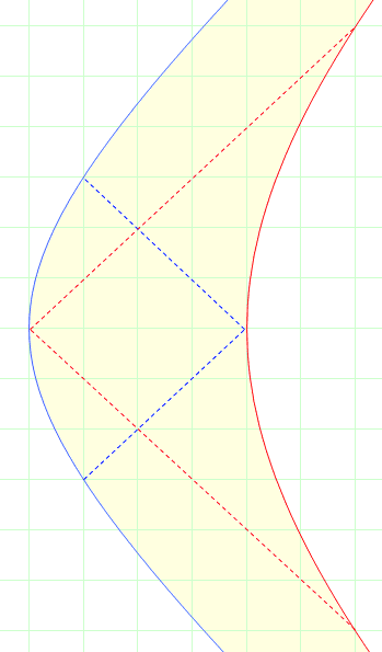

Are you claiming that radar distance and ruler distance between the front and back of a Born rigid rocket undergoing constant proper acceleration is equal ?
Furthermore, do you agree or disagree that rods around the perimeter cannot be Born rigid because they are rotating?
I think it actually is possible to impart an angular acceleration to a Born-rigid one-dimensional object, just not to a Born-rigid two-dimensional object. The argument that it's impossible to have an angular acceleration is given in Ø. Grøn, Relativistic description of a rotating disk, Am. J. Phys. 43 869 (1975), and I think it depends on the assumption that the object encloses some area.
I think the notion of a Born-rigid ruler is exactly equivalent to the notion of measuring distances by radar; anything that can be done with one technique can be done with the other. The difference is that radar (a) actually exists, and (b) doesn't trap unwary people into incorrect arguments.
Yes, I am. They could calibrate a short rulers using a radar measurement and when they lay these rulers end to end to measure the length of the rocket, the ruler length would agree with radar length of the rocket. If you are asking if the ruler length of the accelerating rocket is the same as the ruler length and radar length of the rocket when it was not accelerating, that is a more technical question, because the transfer from not accelerating to accelerating is not constant acceleration and Born rigid motion requires constant acceleration. A rocket with constant Born rigid acceleration was never not accelerating by definition.
If the ruler length and radar length length of a rocket is measured while it is initially at rest and not accelerating, it will find that its radar length is shorter after it starts accelerating, even with Born rigid acceleration. What it finds its ruler length to be depends on how and where the rulers are mounted on the rocket and how the rulers are accelerated. For Born rigid motion, every atom of the rocket has to accelerated by the right amount, so each atom technically needs its own rocket motor. If the rulers are accelerated in the same manner they will obviously not notice any change in the length of the rocket. However, if they check the calibration of the Born rigid accelerating rulers with radar, they will find they are shorter than when the rocket was not accelerating. Consider one ruler mounted only at the nose of the rocket and one ruler mounted only at the tail of the rocket. They overlap at the middle.When the rocket is not accelerating, they put a aligned marks on the two rulers where they overlap and another mark on the wall aligned with the first two on the rulers. If the rockets takes off and goes to Born rigid acceleration, and if no no special acceleration is applied to the rulers, the nose mounted one will stretch under the acceleration forces and tail mounted ruler will compress. Now while the two aligned marks on the rulers may still be aligned they will not still be aligned with the mark on the wall. This means strain and stress can be detected in a rocket that goes from a state of not being accelerated to a state of being accelerated even if the acceleration phase is Born rigid.

WHy would the radar length with rotation be longer than the ruler length?
WHy would the radar length agree with rulers with linear acceleration?
Aren't the clock rates different at the front and the back in a Born rigid rocket?
Radar distance longer from the Front to Back to Front , than from B->F->B ??

yuiop said:
Sorry yuiop, it has been a long time since I have seen such a demonstration of trying to maintain an untenable position by obfuscation and redefining.
Facts:
  • A Born rigid rocket with length X,remains X during constant proper acceleration by definition!
  • The radar distance measured by an observer at the front and at the back is different, the observer at the front would measure the distance longer and the observer at the back would measure a distance shorter compared to the rocket distance in an inertial frame.
yuiop said:
By the clock hypothesis, the ticking rates of the the clocks on the perimeter of the disk is purely a function of instantaneous tangential velocity. The same is true for length contraction. Those that say there is an additional effect due to acceleration over and above the velocity effects that requires GR to analyse are confused. Wikipedia is wrong on this point. It is a purely SR experiment. A real experiment was carried out that stored muons in a cyclotron at relativistic speeds. The time dilation (extended half lives) was exactly what SR predicts due to velocity alone, despite the fact the muons were subjected to centripetal forces of the millions of g. You can analyse the time dilation and effects as being due to velocity or due to pseudo-gravitational effects and get the same answers, but you cannot do both at the same time and add them together or get them cancel out. On top of that, the Schwarzschild metric does not predict length contraction for stationary rods that are horizontal to the gravitational field.
""WHy would the radar length with rotation be longer than the ruler length?""
You seem to have misunderstood my question , since all of the above was exactly my point.

This is shown clearly in the figure above. The line of simultaneity for the accelerating particles simply rotates about the pivot event
from http://www.mathpages.com/home/kmath422/kmath422.htm
As far as I can tell, the line of simultaneity pivoting about the origin is only true, if the clocks of the accelerating rocket nearer the origin are artificially sped up relative to the clocks nearer the nose. If the clocks are left to do their own thing so that they agree with local natural processes, the natural line of simultaneity would be tilted in the opposite direction and would not pass through the origin, no? With this artificial speeding up of the clocks nearer the tail, the radar distance measured at the nose would agree with radar distance measured at the tail. Agree?
This is similar to applying a correction factor to the frequency of clocks on GPS satellites so that they agree with clocks in land based receiving equipment.
No. Radar measurements are made using "proper clocks", not "coordinate clocks" and the front-back-front measurement will differ from from the back-front-back measurement. The attached diagram illustrates why. The time taken by the red signal (measured by the red observer) is much longer than the time taken by the blue signal (measured by the blue observer).
