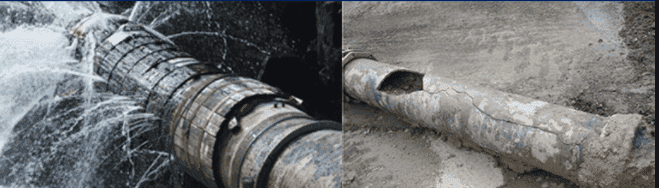

When the ball lands in the seat it will have a moving column of water behind it that is 4” diameter and at least 110 feet long. That will be a critical situation as the ball may be forced through the seat or the pipeline may split. Where will that pressure spike go while the water is decelerating. You effectively have a ram pump, but with nowhere for the water column to go.
Likes hutchphd and anorlunda
@Baluncore identified the critical problem. Here are some pictures of the possible result; water hammer damage.
Likes hutchphd
