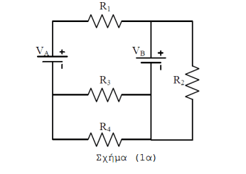

In summary, this student is trying to understand how the electric current flow in a circuit, how the resistance changes depending on the presence of batteries, and how to determine the current if one or both of the batteries are suppressed.
Solmyros
http://prntscr.com/3cmnbx
Va=20V R1=3kilo ohm R2=9kilo ohm R3=6kilo ohm R4=7kilo ohm
Vb=5V
It asks for the electric current for every resistance(R1-R4)
To be honest the thing i want most is to ask some questions rather that getting the solution.
The questions are the following:
a)The battery source has 0 resistance.As a result a short circuit is created and so the second battery(Vb) source goes out?
And now we have a simple circuit that has 4 resistances in a series?And we solve with the Ix=Va/Rx?
Or maybe the 2 electric circuits from the 2 batteries are added and then flow through resistance R2 and then it goes only through R3??(because R4 and Second battery Vb are out)
Well i really tried but i couldn't find an answer to my questions or i thought i couldnt.Only this way i can get some help for now.And i don't know if i met the requirements you asked.If you have time,please give an analysis over this.I prefer getting to understand how the whole thing with the 2 batteries work,how the electric current goes and how it is affected by the existence of the 2 batteries.
Thanks in advance

Not sure I understand what you mean. Are you attempting to use superposition to analyze the circuit?
If Va is shorted the resistances won't be all in series... try sketching the resulting circuit and simplify it step by step. Your diagram doesn't identify Ix or Rx. Can you explain what they are?
If battery Vb is suppressed (replaced by a short) then the circuit is changed. R2 disappears with the short as you've stated, but you need to consider how the resistor pair R3 and R4 are connected. Can you simplify the circuit?

As asked i tried to make the circuit after the short replacements and i found it really hard imagining how it should be.However let me share with you my guesses.
If Va is suppressed i reached somehow to the conclusion that R1 and R3 will be in series.And if we add these 2,then R5(R5=R1+R3) will be in parallel with R2 and R4.This conclusion may be silly but that is all i got
Now if Vb is suppressed,R2 would disappear because the electric current would prefer the "road" with no resistance,right?And the resistances won't be the same with above but with the exception that we won't have R2?
Well to be honest i doubt i got them right.
It would be nice if you explained me how the circuit would be if we put out Va and Vb.
Also if there are 2 "roads" a electric current has encountered.One road has resistance and the other has either a battery or an independent current source,wouldnt the electric current go only to road with the battery-indepedent current source,as there wouldn't be any resistance there?

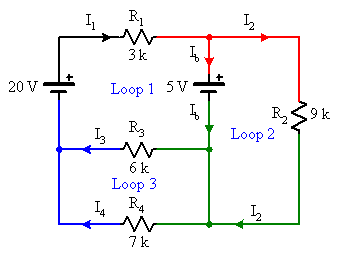

Superposition is a circuit analysis method that takes advantage of the fact that circuits with passive components form linear systems, and for linear systems the effects of separate stimuli (i.e. voltage or current sources) add linearly. So you can take one source at a time, suppressing the rest, and determine the currents and voltages that it produces throughout the circuit. If you add up all the contributions of the individual sources to each of those currents and voltages then you will have the their values when all of the sources are active at the same time.

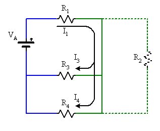

The problem there is that R1 and R3 won't be in series. You see that where R1 and R3 join there is another connection, too. That is, R4 connects to that junction (node) also, giving another path for the current through R1 to follow.
If you identify the individual nodes of your circuit (contiguous conductor "islands" where components attach) then you can see when there are more than two components connected to a given node. I've colored the nodes in the diagram above for you to see how they are identified.
Note that R3 and R4 are both connected to the same pair of nodes (Blue and Red). That means they are in parallel, and the current I1 will be divided between them as currents I3 and I4 as shown.
With Vb suppressed R2 gets bypassed (shorted) as you say. Then the currents are driven by Va. R3 and R4 are still in parallel.
In both cases you can write KCL to sum the currents at the nodes and KVL around the loops to form the equations you'll need in order to solve for the individual currents.

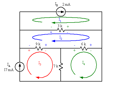

Ok now with your help i can see some light.Even though i don't know if i am ready i will try to make an attempt solving the initial exercise i posted here.I will try doing it step by step showing my way of thinking to see what is that i didnt understand good.
Well here is the problem again:
and here is the data:
Vb=5V
and It asks for the electric current for every resistance(R1-R4)
ok let's give a try:
(gneill scrolls down and goes to the attached file :P)
Ok this is my honest try.I have zero confidence about it though.Would be nice if you could tell me once again my mistakes and give the right analysis explaining your thoughts.
Vb=5V
On the first page of your PDF you claim that R3 is "out" because the path from the right end of R3 to R4 has no resistance. This is not true. All wires are taken to have no resistance and this doesn't "cancel" any components unless the wire shorts them out (is in parallel with the component). Because you've ignored R3 the loop equations that you've written are not be correct.
In this circuit the fact that R3 and R4 share exactly two nodes with their connections means that the two components are in parallel. They will both conduct some current.
For a beginning student who has probably just learned about Ohm's Law, KVL, and KCL, I would suggest labeling all the currents (much like I did in my diagrams above) and then writing KVL loop equations for the three obvious loops and KCL equations for the nodes (junctions). Then solve the simultaneous equations for the individual currents. Trying to guess the paths of currents is not the way to go. Just write the loop and node equations and solve.
I will give you a helpful hint: Note that Vb connects directly across R2. What does that tell you about the current through R2 no matter what else is going on elsewhere in the circuit?
Helpful hint huh? :P
i have some guesses but the answer to this may be something i am not aware of, even if it is obvious.
Maybe because it is directly connected to Vb and because you said "no matter what else is going on elsewhere in the circuit",it returns to Vb,instead of splitting into the other routes as well?
if this is actually true,why does this happen?
So the logic here is to just "write down" the currents that pass through every branch(not trying to find them like i did) and then through the equations i will know,right?
What is the potential difference across R2? What does Ohm's law say about the potential difference across a resistor?
That's the "entry level" approach to KVL and KCL analysis of a circuit, yes.
it is 5 volt.so I2 will be equal to 5/R2 mA?
Do you mean that?
Do you mean that?
Yup, if R2 is in kΩ. So that takes care of the current through R2.

Sir,first thing tomorrow i will try again to solve this exercise and hope to do it right and then go a small step further.Good night
Well unfortunately i got off schedule today and didnt have time to post the answer earlier as i planned.Now before i post the answer i have to ask something to see if i did a mistake...in the circuit you posted above,does
I1 equals to I3+I4?
and last but not least if i found a negative current,i am not wrong am i?
I1 equals to I3+I4?
Yes.
Not necessarily, no. A negative value may simply mean that the assumed direction of the current (the assumption concerning its direction that you made before performing the analysis) was incorrect. The magnitude of the current will be correct.
ok here it is once again.ehh i don't care about the exact results.i care about the equations and the logic.
also one question:
Lets say i have an independent current source in a loop.If i apply kirchhoff's loop law and take the equations about the loop,does the independent current source contribute in any way?i forgot to say that in the exercise i found that Ib is negative
  • New Doc 9.pdf
also one question:
Yes. It will fix the current in the branch that it's in. In general it can be tricky to us basic KVL when you have a current source in the circuit because you don't know to begin with what the potential drop (or rise) across the current source will be. You need to introduce a new variable to represent that unknown potential, or use a more advanced circuit analysis method (You'll probably see it in your studies soon when you cover mesh analysis. The concept is that of the "Supermesh"). The alternative is nodal analysis, which you should also cover.
I don't think it should end up negative. Vb will be putting out about 1.66 mA to drive the current through R2, but I1 from your first loop should be slightly larger, and it goes through Vb in the assumed direction.
I've looked at your PDF and your approach is good. There's a problem with your determination of I1 though. Re-do your reduction of the line marked (1). Something went wrong in going from

Exercise number 2
I found some things about the nodal analysis and the supermesh you mentioned earlier.Here is an exercise and my solution.I don't care about the results,just the logic and the equations matter to me.Take a look..
Also in the circuit you will see, i want to ask something.Lets call the independent current source(IA) X1 and the other one X2(IB)
X1,R4 and R3 are connected.So are R2,R3 and R4.right?
The question is: Are X1,R4 and R3 connected with X2 and R1?
And are X1,R2 connected with X2 and R1??
i was trying to colour the branches as you did earlier but i didnt know if they must have the same colour.Thnx in advance
  • New Doc 10.pdf
Yes, it looks like you've got the right idea in general, but there are a couple of things to watch for.
First, be careful about the signs of the potential changes due to the mesh currents. When you sketch in your arrowed loops to designate a loop current, remember that potential drops occur in the direction of the current when flowing through a resistor. Be consistent in this when doing your "KVL walk" around the loop in the direction of the loop current. The loop current of an adjacent (bordering) loop will usually be going in the opposite direction and will create a potential rise rather than a drop in that resistor from the point of view of your "walk".
The second thing to be aware of is that when an independent current source is located on the "outside" of a loop, that is, it belongs to one loop alone and is not shared by any other loop, the only current flowing through that current source is the mesh current of the loop. This means that the mesh current and the independent current source current are identical. They have the same value. If you know the value of the independent current source then that mesh current is automatically solved! When you write your mesh equations for the remaining loops you can simply plug in its known value where required.
In your circuit both IA and IB fall into this category, so mesh current I1 and I3 are solved before you even begin the analysis! Take advantage of this and use I1 = 2 mA and I3 = 17 mA when you build your equations for loops 2 and 4.
Yes. Any time you can find a contiguous wire path between two components they are connected to the same node.
The particular colors are irrelevant. I was simply using them to indicate and draw your attention to the individual nodes of the circuit.
I am not sure if i understand 100% the first thing you mentioned.
So if i understand correctly one loop current will create a potential drop,whereas the other one will create a potential rise.
But where i will need this information in the circuit?
I mean just now i was told to be careful about this,but i don't know how i can use this.
When you write a loop equation for mesh analysis, you take what might be called a "KVL walk" around the loop in the assumed direction of the loop current. When you encounter a resistor you add a term to your equation that represents the change in potential as you "walk" over that component. From the point of view of your walk, the loop current is flowing in the same direction as the walk, so that loop current will cause a potential drop across the resistor. But if there is another loop current through the resistor due to a bordering mesh, and its current is flowing in the opposite direction (which is usually the case if you automatically assume a clockwise or counterclockwise direction for all loop currents) then that other current will cause a potential rise as you walk across the resistor.
In the diagram of your circuit which I provided in my previous post, take a look at the colr coded "##+~~~~-##" labels on the resistors. They represent the potential changes across the given resistor due to the currents. The colors of these labels correspond to the colors that I gave the loop currents so you can identify which potential change is due to what current.
When you form your KVL equation you must be consistent in maintaining your "walk" direction and the signs of changes according your initial labeling. This will force the mathematics to be consistent, too.
