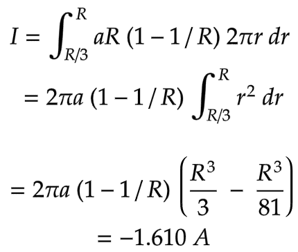

The current density across a cylindrical conductor of radius R varies according to the
equation J=α(r−r2/R), where r is the distance from the axis. Thus the current density is a
maximum J0 at the axis r=0 and decreases linearly to zero at the surface r=R in which α is a constant.
What is the current through the outer portion of the wire between radial distance R/3
and R. Take R=2mm and α=2*105 A/m2
J=α(r−r2/R)
I have attached my solution to this problem but I think I got the wrong answer.
I read your post and the attached attempt at the solution but I have problem understanding which exactly is the formula for the current density. Can you write it in Latex? is it $$J(r)=\alpha r (1-\frac{r}{R})$$
Though in the solution it seems that you use as current density the formula below
$$J(r)=ar(1-\frac{1}{R})$$
I have to say that both formulas seem dimensionally incorrect since the units of ##\alpha## are given as A/m^2
Likes etotheipi
zoyash said:
Homework Statement:: The current density across a cylindrical conductor of radius R varies according to the
equation ## J=α(r−r^2/R) ## , where r is the distance from the axis. Thus the current density is a maximum J0 at the axis r=0 and decreases linearly to zero at the surface r=R in which α is a constant.
Your formula says J=0 at r=0. I think you may have meant ## J =J_0
\alpha (R - r^2/R) ##. Furthermore, in order for J to decrease linearly with r the formula would have to be something like ## J = J_0 \alpha(R-r). ## Try again.
Well, @zoyash started with $$J(r)=aR(1-\frac{1}{R})$$
But then switched to $$J(r)=ar(1-\frac{1}{R})$$
Neither makes sense dimensionally and neither decreases linearly with r. Probably should be $$J(r)=a(1-\frac{r}{R})$$
Likes etotheipi and Delta2
