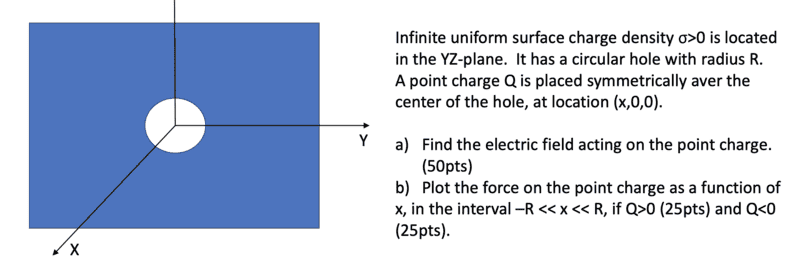

Infinite uniform surface charge density σ>0 is located
in the YZ-plane. It has a circular hole with radius R.
A point charge Q is placed symmetrically aver the
center of the hole, at location (x,0,0).
E=dq/r^2
I believe I have all parameters set up correctly to evaluate part A of this problem but I am unsure of the bounds.
I can't integrate from 0 to R because that part of this sheet has a hole there. I need to integrate from R to the other end of the sheet.
Im not sure how I would figure out the upper limit, the end of the sheet.
I thought about evaluating this as a ring first where dq= λdx , and setting the limits from 0 -2pi*r. Then I can use the electric field of that ring and convert λ = σdr. But then I would still need to integrate from R to the end of the sheet, which I don't what that is. Even if I did do that, that would give field of a disk, it doesn't account for the pointed corners of the sheet.
Likes Delta2
The Y-Z plane is infinite in all directions and so has no shape to speak of besides being flat. As such, your limit is infinity regardless of the direction you integrate in.
That does make sense. Then my approach wouldn't work. How can I approach this?
I am not sure in what I 'll be saying but I think an alternative approach to this is to:
  1. Calculate the E-field ##\vec{E_1}(\vec{r})## from a hypothetical circular solid disk of radius R. You might have work this in another problem of your book
  2. Calculate the field ##\vec{E_2}(\vec{r})## from a hypothetical solid infinite surface (ok this is easy and covered in most textbooks)
  3. The E-field from the surface with the hole is equal to ##\vec{E}=\vec{E_2}-\vec{E_1}##.

I figured it out using the superposition method.
But now I am curious, how can you approach this doing symmetry?
In part a we are evaluating the electric field at a point with perfectly symmetric amounts of charge in each direction. So the E field is just zero.

You're right, you're right, I misread (x, 0, 0) as being a point in the plane, not on the x axis. So to amend my earlier statements, at the point (0, 0, 0) the E field and force are both zero, but as the point charge is moved along the x-axis the E field and force acting on it become non zero.
So after doing all the work, I came out with
\frac{\sigma }{2\varepsilon }[\frac{x}{(x^2+R^2)^1/2}]
How do i go about ploting this as a function of x? According to my answer, E would be proportional to x, so would it just be a straight line from -R to R? This kinda makes sense since the field of a sheet is sigma/2epsilon

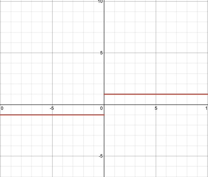

As x becomes large compared to R, we can ignore R, then we would have √x2, which is equal to x, and then x/x would equal 1, so E would be constant?
But that can't be right since you said earlier it won't be a straight line.
It isn't, its asymptotic. Essentially as you move further away from the missing disk, the electric field looks more and more just like the field from the charged plane, which is constant.
Likes guyvsdcsniper
Im an idiot. I should have said asymptotic. That was I was trying to say but for some reason I kept saying straight line.
So it should look like this right?
Electric fields are always continuous, so this cannot be correct. However, if you were to bend the ends of those two lines together at the origin that would pretty much be it. Near the disk the point charge is affected by the disk's presence, it's only further away from the disk that the magnitude of the E field becomes constant.
Likes Delta2 and guyvsdcsniper
That makes sense. Thank you so much for all your help and walking me through the thought process of this whole problem. I greatly appreciate it.
