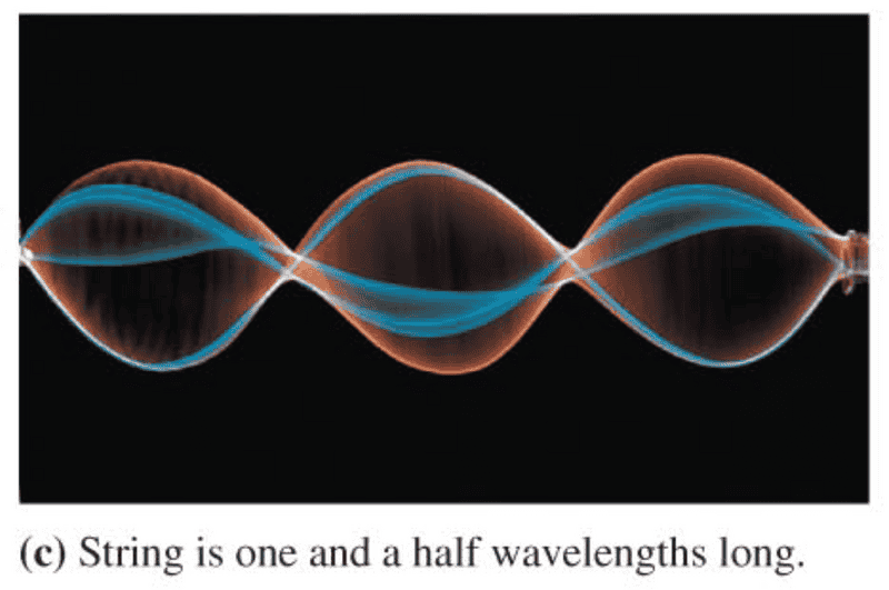

Is there anything special about EM waves in this question? Here's a time-lapse photo of a standing-wave on a vibrating string (from here):
By analogy, would you then ask:
"Could we say that a mechanical wave on a string encodes three-dimensional information of a string vibration-amplitude field into two dimensions (somewhat similar to a hologram)?"
What does that even mean?
