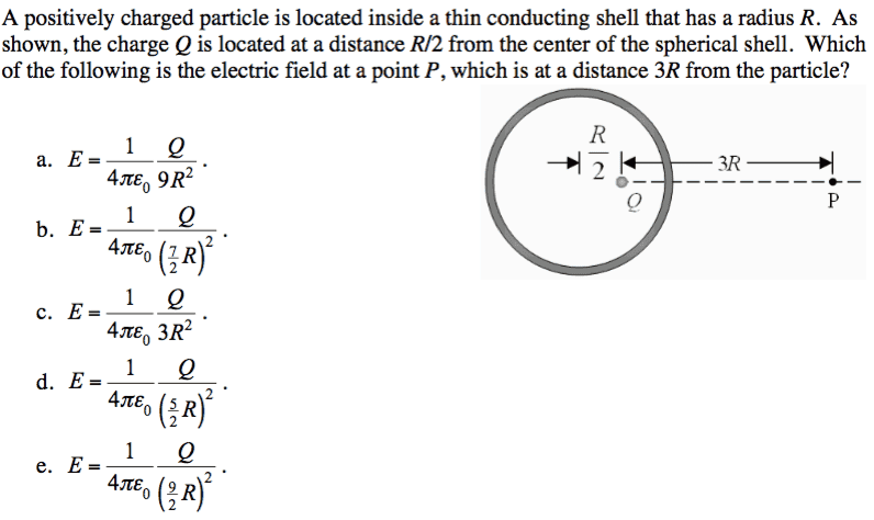

How would I do this question? I am having trouble figuring out what the radius is meant to be, why is it not 3R?
The charge is inside a conducting shell. What is the relevance of that?

Induces a charge in the inner surface of the shell?

Have you studied that? Or, learned any techniques to find the electric field outside an asymmetric charge configuration?

I've learnt Gauss's law, if that's applicable.

Gauss's law is useful. What can you say about the potential on the surface of a conductor?

In a way: you will have to argue why the required symmetry (*) is present.
spherical symmetry of the field outside the shell

It's uniform?

Yeah I'm not sure about that

Yes. The surface of the shell must be an equipotential. Now, the potential is fully determined by the boundary conditions (technically this is a uniqueness property of electrostatic solutions). You know that outside the shell a spherically symmetric potential is a solution, so it must be the only solution.
Now, you can apply Gauss's law.
