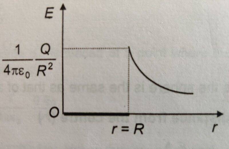

If a spherical shell conductor having a radius R is uniformly charged with a charge of Q, then what is the electric field at any point on its surface?
##E = \dfrac {kQ} {r^2}## where k is Coulomb's constant, Q is total charge on the spherical shell and r is the distance from center of shell of a point outside the shell at which E needs to be determined. The direction of E is always radial.
For all points within the shell E is zero.
When I look at the relevant equations, then there is no mention of field for a point on the surface of the shell, so it gets confusing. On the other hand, I feel the radial E will get stronger as we approach the surface of shell and magnitude of E will approach infinity.

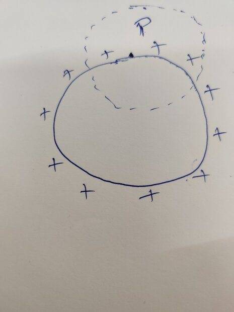

Can we use a Gaussian surface as shown in diagram if we were interested in finding electric field at P, where P is on the spherical shell and shell has negligible thickness? It seems we cannot use this Gaussian surface but not sure. There is something wrong with application of Gauss's law in below manner but cannot pinpoint what is wrong.
The Gaussian surface is denoted by a dashed line in the diagram while the real spherical shell by a solid line.The Gaussian surface is also a perfect sphere. Then we can say that such a Gaussian surface encloses some charge due to the part of actual spherical shell lying with it. We can then say that field inside this Gaussian surface is zero as is the case with a real spherical shell and P being a point inside this surface will also have a zero field.
a
Not sure what you doing there, by choosing a gaussian surface we can talk about the field in points of this surface, not in points on the interior of the surface. Also the surface you are using can't exploit a symmetry.
But still we know that field inside a spherical shell is zero and I am using that fact. This will be true in any situation. We don't need to use symmetry here.
I was trying to know why my argument is invalid.
Do you mean that Gaussian surface does not have a symmetrical distribution of charge on it? If yes, then that's the fault with my logic. I can only say that field inside Gaussian surface is zero if this surface has a uniform distribution of charges.
Regardless if the surface exploits a symmetry of the charge distribution or not, you cannot say anything about the field at a point inside the surface, Gauss's law (in integral form) talks about the field in points of the surface, not inside the surface.

As the graph in post #6 shows, the field is discontinuous at the surface. The difference between the field outside and the field inside (i.e. the discontinuity) is ##\Delta E=E_{\text{out}}-E_{\text{in}}=\sigma/\epsilon_0##, where ##\sigma=\dfrac{Q}{4\pi R^2}## is the surface charge density. It makes no sense to me to ask what the electric field is right at the surface.
Qualitatively, you can think of it this way. The electric field inside the conductor is zero. Electric field lines, represented by arrows, start on the surface where the charges are. Right at the tail, where one of these arrows starts, what would you say the electric field is and why? Your choices are

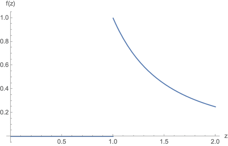

Thanks for the link. Yes, the passage you quoted seems to be the shrinking hole model. The article also addresses my question "what happens in-between" in the following manner:
The electric field is then discontinuous at the surface of a conducting sphere, leaping from 0 to σ/(2ε0) when we pass from points inside the sphere to any point at its surface, and then from this to σ/ε0 for points just outside the sphere.
I find this hard to swallow because I don't know how to reconcile it with the potential that is continuous across the boundary. We know from the Uniqueness Theorem that the potential is constant and given by ##V_{\text{I}} = \dfrac{kQ}{R}## in the region ##r<R## and ##V_{\text{II}} = \dfrac{kQ}{r}## in the region ##r>R##. The radial derivative of the potential is well defined in both regions and can be evaluated at ##r=R##:$$E_{\text{I}} = -\frac{\partial V_{\text{I}}}{\partial r} =0~;~~E_{\text{II}} = -\frac{\partial V_{\text{II}}}{\partial r}=\frac{kQ}{R^2}=\frac{\sigma 4 \pi R^2}{4\pi \epsilon_0 R^2}=\frac{\sigma}{\epsilon_0}.$$ It doesn't look that there is room for a factor of ##\frac{1}{2}##.

I don't have a problem with that reconciliation. If we take the proposed behaviour of the field as correct then we can integrate to get the potential, and it produces the standard result. Trouble is, we can change the value of the field at R to anything we like (short of a Dirac delta function) and that still holds true.
In order to go the other way, finding the field from the potential, we have to assume the field is continuous over the interval of interest. That is clearly not the case for an interval spanning the sphere boundary.
