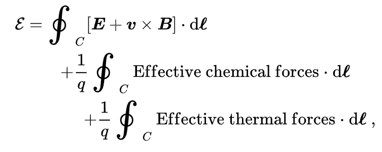

I've been reading through this paper to try and get a better understanding of how batteries work. The analysis there is fine (they consider a voltaic cell to charge a capacitor in order to derive ##\Delta V=\varepsilon##, and go via an energy route), but it doesn't really touch upon the fields inside the battery. I assume that there are no non-conservative electric fields inside the battery arising from time varying magnetic fields (this could be wrong...).
If I take A to be the negative terminal and B to be the positive terminal, then the EMF from A to B is the line integral of all forces (per unit charge), $$\varepsilon = \int_A^B (\frac{1}{q} \vec{F}_{chemical} + \vec{E}) \cdot d\vec{r}$$ Whilst the change in potential from A to B is $$\Delta V = -\int_A^B \vec{E} \cdot d\vec{r}$$ I am not sure how we can show from here that these two quantities are equal. To make matters worse, Wikipedia says this:
Inside a source of emf that is open-circuited, the conservative electrostatic field created by separation of charge exactly cancels the forces producing the emf. Thus, the emf has the same value but opposite sign as the integral of the electric field aligned with an internal path between two terminals A and B of a source of emf in open-circuit condition (the path is taken from the negative terminal to the positive terminal to yield a positive emf, indicating work done on the electrons moving in the circuit).[13] Mathematically:
There are quite a few things I don't understand about this. First of all, they use a field ##\mathbf{E}_{cs}## - is that to imply that they are performing a decomposition into a conservative component and non-conservative component ##\mathbf{E}_{ncs}##? And if so, why would the non-conservative component arise?
The only way I can make sense of Wikipedia's definition is to suppose that the electric field can be decomposed ##\vec{E} = \vec{E}_{cs} + \vec{E}_{ncs}##, and then asserting that ##\vec{E}=0## and ##\frac{1}{q}F_{chemical} = -\vec{E}_{cs}##. Though I'm not sure if this makes any sense at all.
So I wondered whether anyone could clear up what is actually going on? Thanks!

I see your point, though I don't think all hope is lost for a simple model. We consider a voltaic cell comprised of two electrodes, and at each electrode there is an EMF across the double layer.
I'm aware that there are many complications (electrochemical energies, Volta/Galvani potentials? etc.) however is there a simplified way of describing the means by which an EMF is produced across the electrode-electrolyte interface?
Would you also say that the Wikipedia derivation is incorrect?
ε=∫BA(1q→Fchemical+→E)⋅d→​
I think you doing a mistake here , considering the ##F_{chemical}## force in the definition of EMF. The EMF is simply defined as the line integral of the electromagnetic Lorentz force ##F_L=(\mathbf{E}+\mathbf{v}\times\mathbf{B})q## so the EMF is always defined as $$\mathcal{E}=\int_A^B(\mathbf{E}+\mathbf{v}\times\mathbf{B})d\vec{r}$$
I am not an expert in how batteries work but I think inside a battery chemical reactions happen that create separation of charges. We can macroscopically attribute the separation of charges to an ##F_{chemical}## force (though this is not really the case) and the result of separation of charges is a conservative electric field that cancels out ##F_{chemical}##. I don't think there is non conservative component of the E-field inside a chemical battery at least not when the battery doesn't have a current through itself.
Likes etotheipi
In that case we would have (I'll just call ##\mathbf{E}_{cs} = \mathbf{E}## from here on)
$$\varepsilon = \int_A^B \mathbf{E} \cdot d\mathbf{r}$$
whilst the Wikipedia definition has a negative sign in it for a strange reason (perhaps they are just negating their result so it comes out positive?). However I thought we must also take into account the chemical forces in the definition of the EMF:
I think here Wikipedia goes wrong. If we take the sum, and having in mind that the conservative electric field inside the battery, cancels out ##F_{chemical}## then the EMF of a battery would be always zero.

Maybe you were referring to @vanhees71's excellent post here where he discusses $$\mathcal{E}=\int_C \mathrm{d} \vec{r} \cdot (\vec{E}+\vec{v} \times \vec{B})$$ On another note, from what I have read I am not sure if performing the Helmholtz decomposition of the electric field as is mentioned in the post you quote is particularly physical.
Although I'm particularly interested in this case just in evaluating the EMF of the battery. If we perform a line integral of the Lorentz force from the negative to the positive terminal then we obtain a negative EMF, which is oppositely signed to the potential difference in the same direction, which appears to be slightly odd.
I also found another treatment here (starting at end of page 5) which includes the work done by a chemical force from the source in the equation for EMF. However they perform the integration around the whole loop and it's not then obvious to me how this relates to the EMF across just the battery.

Griffiths gives a slightly different treatment. He says that the force per unit charge ##\mathbf{f} = \mathbf{f}_s + \mathbf{E}## where ##\mathbf{f}_s## is in this case a chemical force from the battery, and ##\mathbf{f}_s = \mathbf{0}## outside the battery.
Furthermore, he says that for an ideal battery the net force on a charge is zero, so ##\mathbf{E} = -\mathbf{f}_s##. We can then write the p.d. from ##a## to ##b## as $$V = -\int_a^b \mathbf{E} \cdot d\mathbf{l} = \int_a^b \mathbf{f}_s \cdot d\mathbf{l} = \oint \mathbf{f}_s \cdot d\mathbf{l} = \mathcal{E}$$ where in the last step we have extended the bounds of integration to the whole loop since ##\mathbf{f}_s=\mathbf{0}## outside the battery, and we equate the final integral to ##\mathcal{E}## since $$\mathcal{E} = \oint \mathbf{f} \cdot d\mathbf{l} = \oint \mathbf{E} \cdot d\mathbf{l} + \oint \mathbf{f}_s \cdot d\mathbf{l} = \oint \mathbf{f}_s \cdot d\mathbf{l}$$ because the ##\mathbf{E}## field is conservative.
One thing I note is that the ##\mathcal{E}## is taken around the whole loop. This reasoning would indeed appear to imply that the EMF between the terminals of the cell is zero, since the net force is zero inside the battery. This is a little peculiar...

Thank you @anorlunda for quoting my post. It may have been my earlier one on the subject.
Yes, there are two sources of E fields inside the battery, one I call ##E_m## which is non-conservative ## (\nabla \times \bf E \neq 0) ## and the other electrostatic which of course is conservative which I call ##E_s##.
I introduced this fact as an effort to show more generally that every emf is associated with a non-conservative E field. I gave several other examples which require understanding of the separate sources of ##E_m ## and ##E_s## fields (cf. link below).
In a battery the chemical reaction generates an ##E_m## field which is used to move charge from the cathode to the anode against the ##E_s## field which builds up just as in a capacitor. Equilibrium between the two forces is reached when ##E_m = -E_s##. ##E_m## points from cathode to anode; ##E_s## from anode to cathode. So the net E field in the battery is zero.

etotheipi said:
One thing I note is that the EE\mathcal{E} is taken around the whole loop. This reasoning would indeed appear to imply that the EMF between the terminals of the cell is zero, since the net force is zero inside the battery. This is a little peculiar...
I think EMF should always be considered around closed loops, cause it then shows up which is the "real EMF" that is which force does the real work supplying with energy the circuit. In the case of the battery the conservative E-field does positive work in the circuit path, and negative work in the battery path so the total work in the total closed path is zero. The real work is done by the chemical force ##\mathbf{f_s}## the work of which around a closed path is not zero.
The same happens in the case of an AC-generator that has a rotating coil. There inside the coil the total force is again zero cause the ##\mathbf{v}\times \mathbf{B}## force is canceled by the force from a conservative E-field inside the coil. But around a closed loop the contribution from the conservative E-field vanishes and only the ##\oint (\mathbf{v}\times \mathbf{B})\mathbf{dl}## survives which is well known fact that it is the EMF of the rotating coil.
It's peculiar because it's wrong. I think you're misinterpreting Griffith. I could see nothing wrong in what he said, including every equation.
OK, by his annotation E is the conservative field (which I call ##E_s##) and ##f_s## is the emf-generated, non-conservative field (which I call ##E_m##).
Although numerically accurate I don't like equating E (meaning emf here) to V (which is p.d.). emf and p.d are separate entities and must be recognized as such even though they have the same units. An emf is always generated when some other form of energy is changed to electrical .##E_s## fields are always generated by charges. The flux lines begin and end on charges. There are no charges associated with an ##E_m## field (unless current flows of course).
You need to take the circulation of fields ##E## and ##f_s## separately. The circulation of ##E## is zero since it's conservative. BTW E exists outside the battery body also, from anode to cathode, same as inside, same direction and magnitude. So if there's an external circuit like a series resistor you can take your closed contour around the resistor and either inside or outside the battery body. If there is just the battery then the closed E loop is taken inside and outside the battery terminals. The result is of course zero in both cases.
But ##f_s## is really the emf-generated electric field even though lots of folks don't seem to like calling it an electric field (they're wrong! :smile: ). In any case when you compute the circulation of ##f_s## you get the emf of the battery, not zero, just as Griffith does.
You might refer to my blog at https://www.physicsforums.com/threads/how-to-recognize-split-electric-fields-comments.984872/

Oh my. This is not only wrong, it is obviously wrong.
Consider the usual open circuit measurement of a battery after all transients have ended. There is a non zero charge distribution that produces an E field in the battery. This E field is produced by a static charge distribution in the usual way so it is conservative and has an associated electrostatic potential.
There is also a chemical potential, usually called the EMF. Since the transients have all ended and the battery is in equilibrium then this chemical potential is equal and opposite the electric potential. It is therefore also conservative.
There is therefore no non-conservative potential in a battery in an open circuit.

etotheipi said:
But I thought there is only one ##\mathbf{E}## field; ##\mathbf{f}_s## doesn't appear to be an electric field here, since it's of a chemical origin?
There is room for semantic difference in the case of a battery but in all electrical effects ##f_s## is an electric field.
Please see attached excerpt from a well-known textbook (H.H. Skilling, Fundamentals of Elecric Waves, 2nd edition, 10th printing, pp. 73-75).
I am not sure about this. Griffiths says
The physical agency responsible for ##\mathbf{f}_s## can be many different things: in a battery it’s a chemical force; in a piezoelectric crystal mechanical pressure is converted into an electrical impulse; in a thermocouple it’s a temperature gradient that does the job; in a photoelectric cell it’s light; and in a Van de Graaff generator the electrons are literally loaded onto a conveyer belt and swept along. Whatever the mechanism, its net effect is determined by the line integral of ##\mathbf{f}## around the circuit:
There appears to be no constraint that this force per unit charge be an electric field. And indeed, most other sources I have consulted today echo Griffiths.
