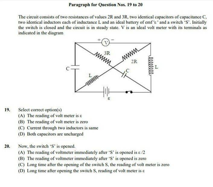

The circuit consists of two resistances of values 2R and 3R, two identical capacitors of capacitance C,
two identical inductors each of inductance L and an ideal battery of emf 'ε ' and a switch ‘S’. Initially
the switch is closed and the circuit is in steady state. V is an ideal volt meter with its terminals as
indicated in the diagram (diagram is attached below...)

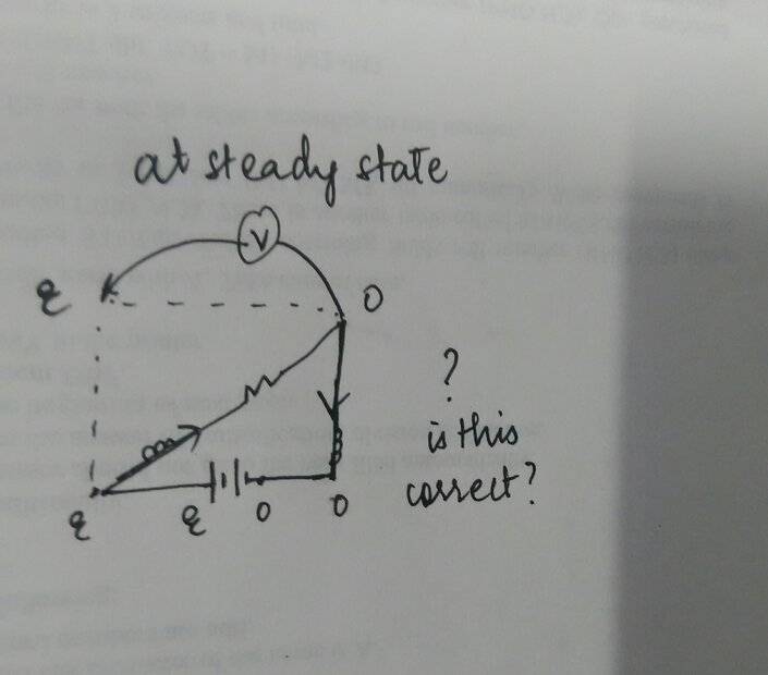

I've learnt that at steady state the capacitor is fully charged and so no current flows through that branch, and at steady state an inductor behaves like it's short circuited I.e. it just lets all the current flow through it. I guess the question is based on this concept only, not really sute if there are any specific formulas involved... I also know KVL(Kirchoff s voltage law) but I'm not sure how to use that here
I did try redrawing the circuit at steady state , but I'm not really sure. I have attached the circuit that I tried drawing, I assumed the branch with the capacitors to be absent at steady state since current won't flow through them anyway. With this diagram I get the correct answer for Q 19 , but want to know if the method is correct or not.
And please help with Q.20 I honestly don't know how to proceed.
(Attaching the question below too...)
Answers given 19 -AC , 20- AC
No, you got it by making two mistakes.
In the diagram you drew, one side of the voltmeter is not connected to anything, so it has no way to detect a potential difference. You should have got zero.
But I think you misinterpreted the original circuit diagram. In the centre, where the two lines cross in an X, you have taken the two wires as not being connected to each other. If that were the intention, it should show one wire as executing a small semicircle as it crosses the other. I believe you are supposed to take them as connected there.

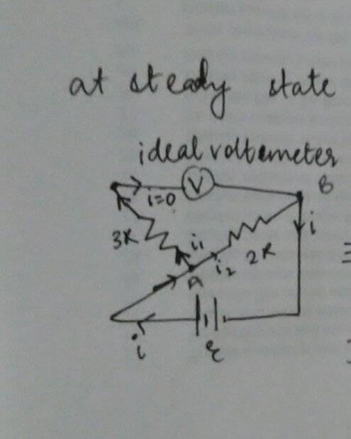

Oh yes yes thank you. I redrew the circuit... Now is it correct? Since the voltmeter is ideal ,current flowing through it will be 0( so in my diagram i1 = 0) , so can I say that the voltmeter is connected across the 2R resistor only and so will measure 'E ' as the potential difference?

I think you got it right now, both the equivalent schematic and the explanation.

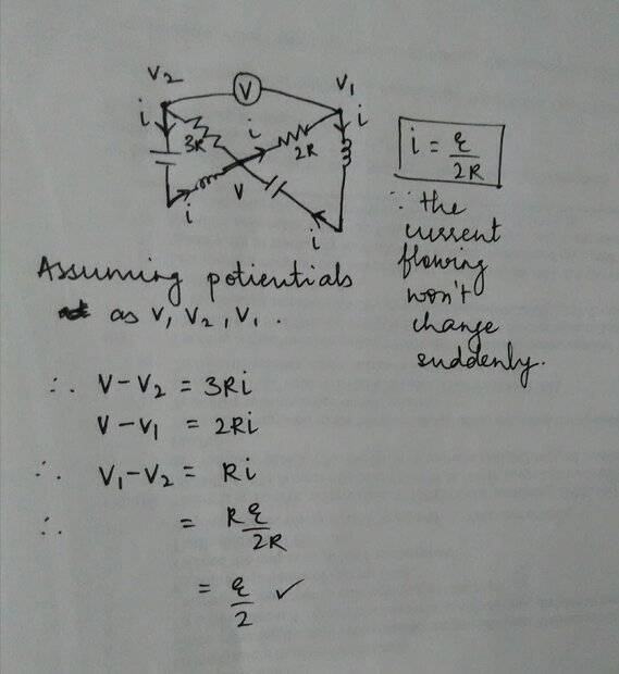

But what about option A ? I just know what currents through the inductors won't change suddenly when the switch is opened, but I don't know how to proceed & find the potential difference... Please help

Can you redraw the equivalent circuit when the switch is opened (effectively remove the EMF source).
As you said the current through the inductors will not change suddenly, in order to be more accurate, it will still be the same right after the switch is opened. But the current from each inductor will follow a different route. You have to redraw the circuit first to proceed to further discussion.
Yes I redrew it and I think I got the answer...is this the correct method ?
Likes Delta2
Yes I think your method is absolutely correct.

I just had a small doubt in the last circuit that I drew in the earlier post(#15) , If V is at a greater potential than V1 (since initially also current was flowing that way) then why does the current flow back from point V1 to V again from the right side of the loop ?

because it flows through inductor and capacitor from the right side of the loop. if we remove the inductor and capacitor and replace them with resistors, this circulation of current wouldn't be possible indeed. For resistors the current always flows from higher to lower potential but this is not always the case for inductors and capacitors.

More specifically, when capacitor is charging, current flows from the positive plate to the negative plate, hence from high to low potential. However when capacitor is discharging , the current flows from the negative plate to the positive plate that is from low potential to high potential. Similar results hold for the inductor.
When you do AC circuits, you will learn this in a bit different way: We say there that the voltage in the capacitor lags phase ##\pi/2## with respect to the current that flows within it and that the voltage of inductor is ahead phase ##\pi/2## with respect to the current that flows within it. The voltage of the resistor is always in phase with respect to its current .
