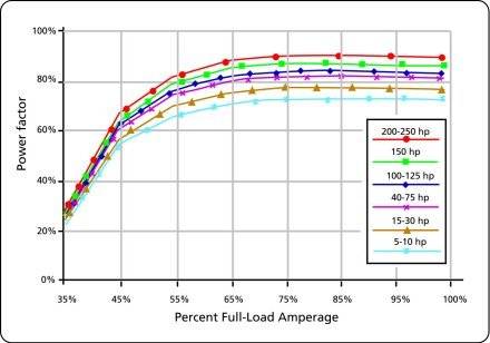

cos φ estimations get more shaky more you're off the nominal power of machines.
Yes, but if he has a name brand motor with performance curves, he can get very close. If not...
[edit] oops...looks like it was worse than I remembered. Below 50% load, it starts getting pretty bad:

Performance graph (p6).
Line current drawn at 460 V (266V phase to neutral) → Power factor (cos φ).
This should give you a good estimate of a true electrical power of the motor since Pel= 460⋅I⋅√3 ⋅cos φ
