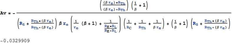

Alright. Well I start off by first finding the voltage at the base of the transistor, also equal to the input voltage of the first stage
[itex]V^{~}_{b_{1}} = \frac{(R_{Th}||βr_{e_{1}})V_{S}}{R_{S}+R_{Th}||βr_{e_{1}}}[/itex]
I can then find the current through the base of the first transistor
[itex]I_{b_{1}} = \frac{V_{b_{1}}}{βr_{e_{1}}} = \frac{(R_{Th}||βr_{e_{1}})V_{S}}{(R_{S} + R_{Th}||βr_{e_{1}})βr_{e_{1}}}[/itex]
I can then find the output voltage of the first stage
[itex]V_{O_{1}} = -βI_{b_{1}}R_{C_{1}} = \frac{-(R_{Th}||βr_{e_{1}})V_{s}R_{C_{1}}}{(R_{S} + R_{Th}||βr_{e_{1}})r_{e_{1}}}[/itex]
I can then find the input impedance of the second stage
[itex]Z = R_{Th}||(βr_{e_{2}} + (β + 1)R_{E_{2}}||R_{L})[/itex]
I can then find the current through the base of the second transistor using that the output voltage of the first stage is the input voltage of the second output voltage and the voltage at the base of the second transistor.
[itex]I_{b_{2}} = \frac{V_{O_{1}}}{Z} = \frac{(R_{Th}||βr_{e_{2}})V_{S}R_{C_{1}}}{(R_{S} + R_{Th}||βr_{e_{1}})r_{e_{1}}(R_{Th}||βr_{e_{2}} + (β + 1)R_{E_{2}}||R_{L}}[/itex]
I can then find the voltage at the collector of the second transistor
[itex]V_{C_{2}} = -βI_{b_{2}}R_{C_{2}} = \frac{β(R_{Th}||βr_{e_{1}})V_{S}R_{C_{1}}R_{C_{2}}}{(R_{S} + R_{Th}||βr_{e_{1}})r_{e_{1}}(R_{Th}||βr_{e_{2}}||βr_{e_{2}} + (β + 1)R_{E_{2}}||R_{L}}[/itex]
I believe that this is correct, however I'm not exactly sure how this helps. I don't know [itex]r_{e_{1}} or r_{e_{2}}[/itex] and can't find these values without[itex]I_{e}[/itex]. I need to find [itex]V_{e}[/itex] the voltage at the emitter of the second transistor in order to find the output voltage.
These equations seem a bit messy and I assume that I need to make some approximations? This has opened my eyes to what I was doing all along was down right wrong. I questioned just assuming that [itex]r_{e_{2}} and r_{e_{1}}[/itex] are equal to each other, which they are obviously not. I would like to fully understand this problem, I'm just not sure where to go from here.

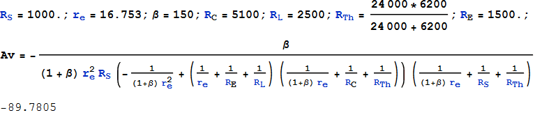

These posts have made me question a couple of more things.
So then my DC analysis for [itex]I_{B_{1}}[/itex] and [itex]r_{e_{1}}[/itex] is correct. Based off your posts, transistors have two betas [itex]β[/itex] and [itex]β^{~}[/itex] an AC value and a DC value. Interesting. Thus far I have assumed they are the same.
In my AC equivalent circuit, I need to find [itex]βi_{B_1}^{~}[/itex] I can't use [itex]I_{B_{1}}[/itex] in this calculation because I need the AC value [itex]i_{B_1}^{~}[/itex] which I'm supposed to get from my small circuit equivalent drawing?
I don't see how [itex]r_{e_{2}}[/itex] and [itex]r_{e_{1}}[/itex] are the same. I know understand that [itex]r_{e} = \frac{26 mV}{I_{e}}[/itex], where [itex]I_{e}[/itex] is the DC current and not the AC current. For the first transistor I used the formula [itex]I_{B} = \frac{V_{E} - V_{BE}}{R_{Th} + (β + 1)R_{E}}[/itex] and then found [itex]I_{E}[/itex] using [itex]I_{E} = (β + 1)I_{B}[/itex], thereby allowing me to calculate [itex]r_{e}[/itex]. I don't see how the DC current through the base could be the same for the first transistor and the second transistor because the second transistor has [itex]R_{L}[/itex], which the first transistor does not. Because I believe the transistors have different currents through the base based off this they would have different currents through the emitter and as a result different [itex]r_{e}[/itex]. I guess these conclusions are wrong but I'm not exactly sure why.
Yes, you had the right re1 all along.
There are two betas but the second beta is unimportant. It's OK to assume they are the same, and that the ac and dc betas are also the same.

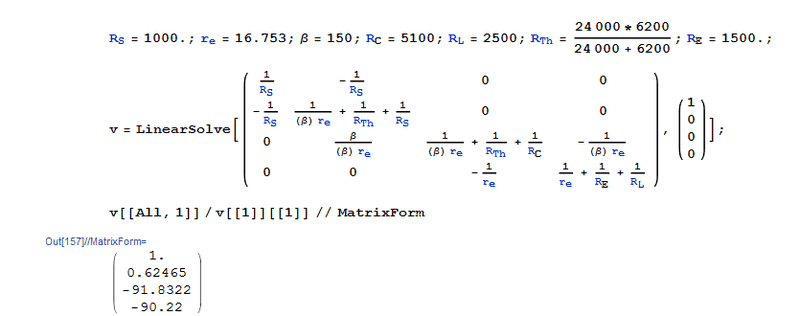

Your equiv. ckt. is a huge improvement! But use v for voltage, not V. V is a dc voltage, v is an ac voltage.
I would not split it as you have though:
1. find ib1 as a function of vs. That computation is independent of the rest of the circuit.
2. you now have 2 independent nodes, vc1 and ve2. Sum currents to zero at each node or use KCL or whatever to solve for ve2 which is your output voltage.
Sure! Very simple. vs generates what current ib1?
Not the correct expression for re. re = βVT/Ic.
Since β is assumed the same and both Ic are the same, re1 = re2.

If I evaluate what I got using the indicated values for the components, the result is:
If I evaluate your expression, the result is:
I can't tell you where your mistake is, but there is apparently at least one.
