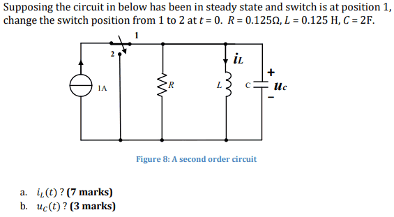

Source free Second order Parallel RLC Circuits. How to find functions for inductor current and capacitor voltage with respect to time after current source has been removed?
α=1/2RC, w0=(1/lc)^1/2, v(t)=(A1+A2t)e^-αt

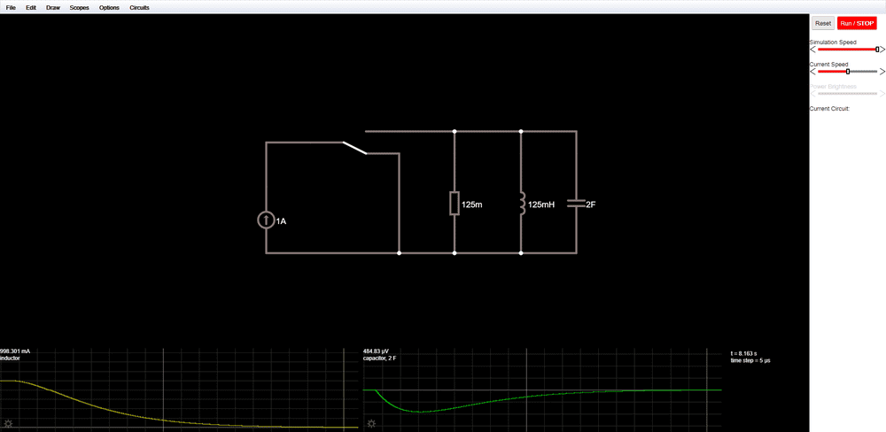

The inductor current curve and capacitor voltage curve should look like this after pulling the switch from which the circuit archived a steady state of 1 amp:
link to circuit: http://tinyurl.com/y4hq6c6u
The elements share a common voltage, u.
KCL says the sum of all currents = 0.
Form the second-order DE, then solve it.
Likes cnh1995
Can't I just use v(t)=(A1+A2t)e^-αt since the circuit is critically damped (α=w0) and solve for A1 and A2 based upon initial conditions?
When it's critically damped, that is the way to solve it.
OK, but How do I find A1 and A2 based upon the initial conditions?
You set t=0 in the general solution, and substitute the known initial conditions.
A2 is initial current or voltage
to get A1 you must differentiate the equation with respect to time
Find dv/dt or di/dt via KCL or KVL
the dv/dt or di/dt will come from the equation for the capacitor current or inductor voltage (basically ohms law for inductors and capacitors )
now you sub your dv/dt or di/dt into the equation you differentiated with respect to time

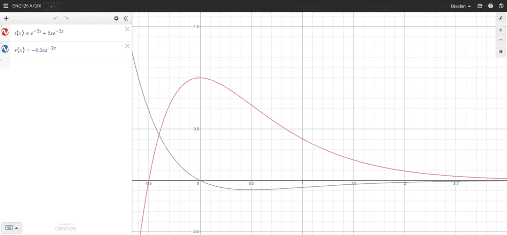

My functions for iL(t) and vc(t) have the exact same curves as the simulation:
Your equation for v(x) agrees with what I arrived at.
And what about the function for the current through the inductor iL(t)?
