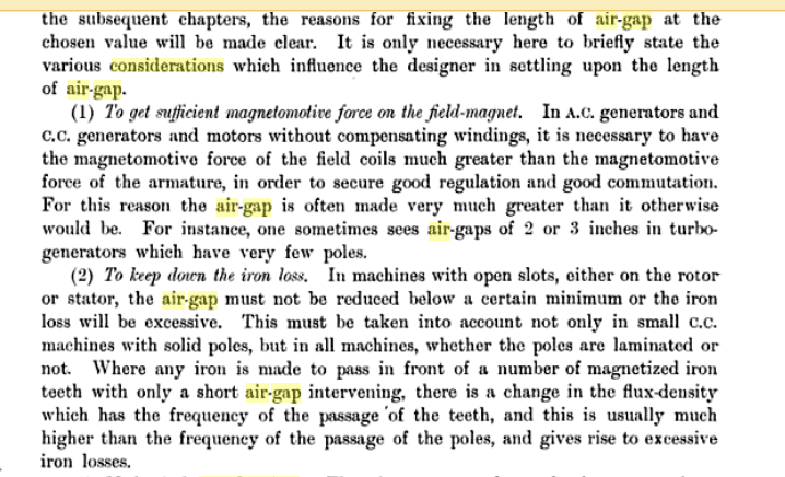

from a 1915 book:
Specification and Design of Dynamo-electric Machinery
By Miles Walker
(In his day Direct Current was often called Constant Current , "cc" instead of our familiar "dc")
https://books.google.com/books?id=FYdPAAAAMAAJ&pg=PA62&lpg=PA62&dq=motor+air+gap+considerations&source=bl&ots=7-aRQupePy&sig=n4QgT6Fz50Tna6uE8j_LnZhCoW0&hl=en&sa=X&ved=0ahUKEwisvLHG4dXJAhUE6yYKHc-6B4EQ6AEIRDAH#v=onepage&q=motor air gap considerations&f=false
so i guess you might summarize thus:
armature reaction and fringing flux play into choice of airgap .
old jim
