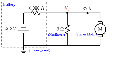

I did 12.6 V = 5.08I and found I=2.48 A, then multiplied 2.48A(5) = 12.4 V for part a.
I am stuck on part b, I seem to not be understanding the physics of the question. Now there is a 35 A that goes through the battery, but I would think the emf is constant at 12.6 V, so there can't be anymore potential drawn from it.
.08(35A) + 5(35) is not 12.6 V, so I am stuck

Wait, hold on. I don't interpret the problem that way.
The way I interpret the problem, the starter motor is taking exactly 35 A from the battery. And that's in addition to whatever current the headlights happen to be drawing at this point in time.
(I agree, the problem is worded slightly ambiguously. I don't think the problem is trying to say the battery's current is 35 A in addition to what the headlights drew before the starter motor was turned on. Rather I think it's simply proposing is that the starter motor is drawing 35 A. And that 35 Amps is is being sourced by the battery in addition to the current also going to the headlights, whatever that is.)
Yes, the battery does have a constant emf of 12.6 V. But don't forget there is also a voltage drop across the internal resistance.
That's not quite right. The current through the battery, and thus the internal resistance, is more than 35 A. Remember, a full 35 A is going to the starter motor. There is some more current in addition to that going to the headlights.
Here are a couple of hints.
  1. Draw out the circuit. Model the starter motor as a resistor. This resistor is in parallel with the resistor used to model the headlights. You already know the current going through this starter motor resistor: 35 A.
  2. Find a KVL that includes the battery and the headlight resistor; find the current through the headlights (this will take a little algebra, but you already know the current through the battery is 35 A more than the current through the headlights).
  3. From there it shouldn't be much trouble to find the voltage across the headlight resistor.

Somthing to remember while solving this one... Don't assume the headlamp current in "b" is the same as in part "a". The extra load from the starter will drag down the battery voltage.
Sometimes it helps to sketch the circuit:
The potential at the node labelled Vh would be the voltage across the headlamps when the starter motor is drawing 35 A.

Thanks everyone for the help. I was curious, why is information about the resistance of the starter motor not needed to solve this problem?
Because when you solve the two equations I mentioned earlier you don't need to solve for the starter resistance if you don't want to.

When calculating part (a) you used the resistance of the globes (plus internal resistance of the battery) to find the current through the battery.
You could then have used that current to find the Drop in PD inside the battery [2.48 x 0.08 = 0.1984 ≈ 0.2] thus of the original 12.6 Emf, there is only 12.4 left to drop across the globes.
For part (b) you were told the current the starter motor would draw, so you could already calculate that 35 x 0.08 = 2.8V would be dropped inside the battery due to the influence of the starter. SO already the PD across the battery is down to 9.8 V. the globes will mean a further ≈ 0.2 V so the final PD is a little over 9.6 V.
Had you been calculating what was "lost" in the battery, rather than what was dropping over the globes you would see that you didn't need the resistance of the starter (since the current drawn was already given).
Last question, is the voltage at "V_h" in post #7 the same as the voltage across the resistor with 5 ohms? If so, doesn't the current need to pass through the resistor to drop, yet at that point labeled V_h, the current hasn't reached the resistor yet.
Thank you
Yes.
Yes, it has. Assume the entire circuit is in steady-state. :wink:

If you are thinking of the current as leaving the battery and getting to the V_h label, it has already passed through the 0.08 Ω resistor. Thats why is has dropped from the 12.6 at the exit of the cell to the remaining 9.6 or so.
The remaining 9.6 will drop as the charges pass through either the globe or the starter.
