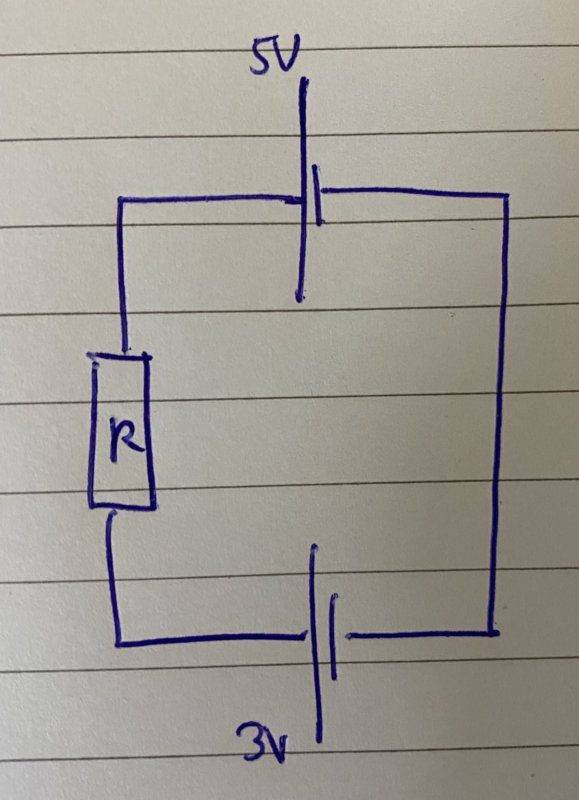

So if we draw a circuit diagram consisting of cells in different orientations, some should have positive EMFs and some should have negative EMFs. However, on circuit diagrams EMFs appear to always be labelled on cells as a positive value. Why is this?
There do exist some complications - if we don’t know the direction of current, then we also don’t know the sign of the EMF...

But if we set up a circuit with two cells connected in opposite directions, one should have a positive EMF and the other a negative one (I.e. we’re fixing one end of the reversed cell to do oxidation, etc.). However, both cells would just be labelled with a positive number of volts.
However, surely one should be negative?
What do you mean? Can you draw a circuit diagram to illustrate?
Likes etotheipi
For instance, usually we’d just call these cells of EMF 5V and 3V.
However, the EMF of the lower cell should actually be -3V, since the cathode is on the right hand side (smaller bar) in this configuration. But I’ve never seen anyone label EMF’s like this as negatives, even though it seems more correct to do so.
No, but I think common sense would tell you that one EMF should be subtracted from the other, as they are in opposite senses. The voltage across the resistor is 2V (rather than 8V, if the 3V cell was the other way round). Subtracting 3V is the same as adding -3V.
-3V with respect to what?
As you said, the orientation of EMFs in the closed circuit is important, and it is obvious that applied EMF between terminals of "R" is 2 V.

Let me put it in this way. With series connection of two battery cells of opposite orientation, and corresponding EMFs 5V and 3V , assuming R>>, the voltage delivered to the external circuit is E=+5V+(-3)V or V=+5V-(+3)V. The result is the same
You're right, at the end of the day common sense prevails and - given we know which is the positive pole and which is the negative pole - we can apply Kirchhoff's voltage laws and do everything we need.
