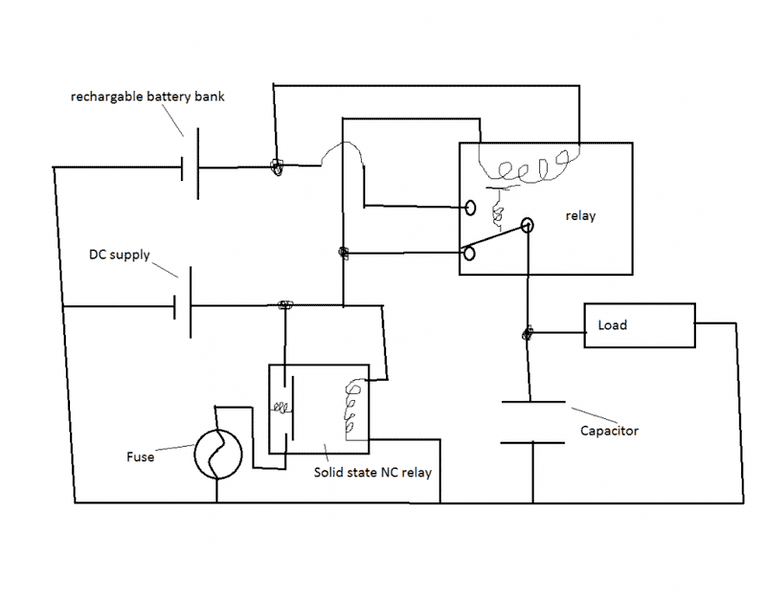

I was going to make a modem uninteruptable power supply, and I was thinking (possibly over complicated) that I could have a relay with the solenoid that has a potential over the battery bank and the power supply, so there would be near zero volts potential when the power supply was on (and charge the batteries to the level of the supply ~12v), then when the power supply failed a potential of 12v or so would be over the solenoid and cause it to trip.
I was wondering if there was a component that:
When the input is a voltage, then the output is a open circuit, and when the input is open circuit, the output is a Short. Would there be like an Opto-coupler that goes open circuit when the diode is on?
Or if there is a solid sate component that could do this all integrated, that I haven't thought of...

yeah thanks, but I want to totally disconnect the battery from the load, while keeping it totally charged.
I am also curious if there is a component that acts like that, like if there is an opto-coupler that is off when it's on and vice versa.
Thanks

That's not what I meant, they're not mutually exclusive, I was intending on having a capacitor to bridge the small gap in time between the relay flicking over. I'm aware of issues with USPs that I'm trying to design around.

And no, I'd be very surprised if there wasn't something much simpler like an opto-coupler with a NOT logic arrangement built in, however I'd like to know what other (higher rated) options there were, because I don't want to conceive capasitive or restive voltage dividers to drive a mosfets for something that should be simple for a solid state component now days.

Well if you have a capacitor to bridge the gap, the operation is still uninterrupted.
I just wanted something that could recharge but wouldn't dissipate charge, I suppose it would look something like this:
excuse simplicity and crudity.
Sooo...no good?
