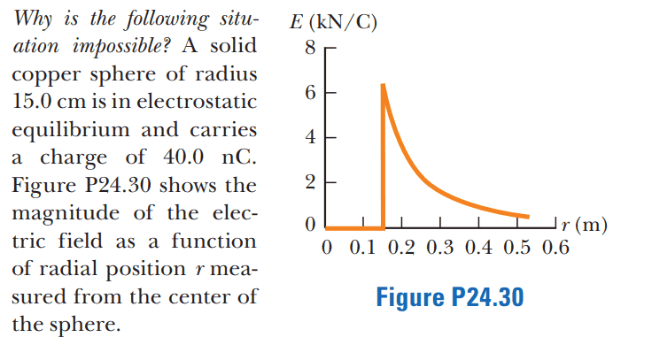

Electrostatic equilibrium problem

For this problem,
I don't understand why this is impossible. Can someone please help?
Many thanks!
Likes anuttarasammyak
What would be the magnitude of the electric field just outside the sphere?
Likes member 731016
Thank you for your reply @kuruman ! The electric field of a sphere is equivalent to that of a point charge so ## E = \frac {40 \times 10^{-9}k_e}{0.15^2} ##
Many thanks!
So why is the situation impossible?
Likes member 731016
Thanks for your reply @kuruman ! Thinking... Its got to me something to do with the electric field.
Yes. Look at the plot and then look at your post #3.
Likes member 731016
Oh thanks @kuruman ! The calculated value for the electric field at the surface of the charge is not equal to that value on the graph.
