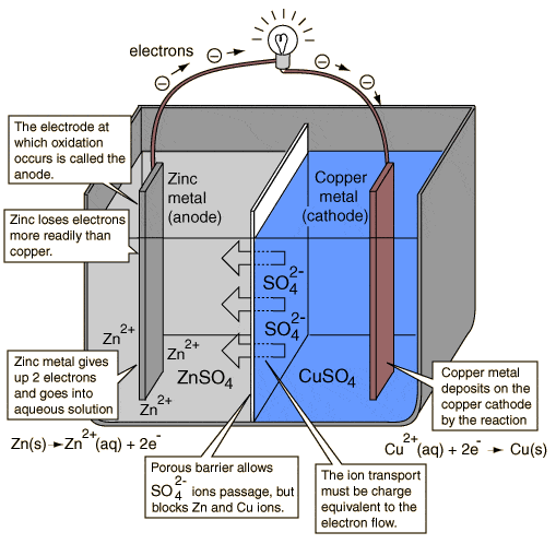

I understand Battery terminals are not points. But they create a driving force for electrons to move in an Electric Circuit.
If you see the above figure copied from "http://hyperphysics.phy-astr.gsu.edu/hbase/chemical/electrochem.html". I don't understand how potential is created in the battery terminals?
Potential is created by charges. Here we have Zn Charge and Cu Charge, How potential develops in the electrodes?
