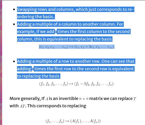

A blog post by Evan Chen https://blog.evanchen.cc/2016/07/12/the-structure-theorem-over-pids/ says that elementary row and column operations on a matrix can be interpreted as a change-of-basis.
I assume this use of the phrase "change of-basis" refers to creating a matrix that uses a different basis for a vector in its domain (as a linear tranformation) than in its range. Is that correct?
The linked post introduces a linear map T between modules, say from M1 to M2 . It says the map T can be "thought of" as a matrix (which it depicts) "for the standard bases of the two modules". This assumes such standard bases have already been agreed.

What confuses me is how to visualize the row-column pair of operations as changing the basis of the domain of the transformation with the column operation and changing the basis of the range of the transformation with the row operation. Using the example in the article, suppose my basis is ##B = \{e_1,e_2,e_3\}## and I want to change basis to ##C = \{e_1, e_2 + 3e_1, e_3\}##. The matrix for the column operation to change the basis in the domain is:
##A = \begin{pmatrix} 1&3&0\\0&1&0\\0&0&1 \end{pmatrix}##
So ##A^{-1} = \begin{pmatrix} 1&-3&0\\0&1&0\\0&0&1 \end{pmatrix}##
Is it supposed to be obvious that ##A^{-1}## changes basis ##B## to basis ##C## for the range of the transformation?
