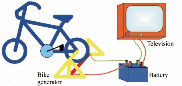

anorlunda said:
If you're planning for post apocalyptic life, a battery won't get you very far.
That depends... :wink:
https://academic.hep.com.cn//article/2012/2095-1701/2095-1701-6-3-210/thumbnail/hcm0000454589.jpg
