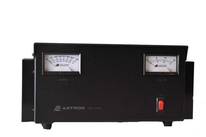

something like this should do
https://www.amazon.com/dp/B001YI95EY/?tag=pfamazon01-20

and it's why i posted that preposterous supply . (well, also partly because i found one last week at my metal recycle yard , cost me 30 cents a pound not quite twelve bucks)

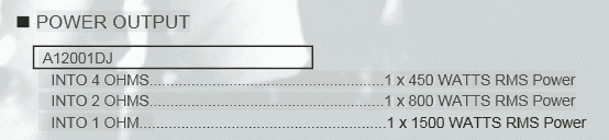

i just looked at the link anorlunda posted
http://audiobahn.com/phocadownload/Manuals/Amps/ClassD.pdf
that manufacturer publishes RMS watts.
1500 watts into 1 ohm is 38.7 amps
My preposterous supply would be about right for their AT12001DJ
Audiobahn looks like a name to respect.

hmm
450 watts into 4 ohms is 42 volts RMS, 60peak
which means that thing must have a power supply capable of 60volts and almost 40 amps, 2.4KW.
If so , even my preposterous supply would be way undersized for Audiobahn's AT12001DJ .
What size input fuse does it have ?

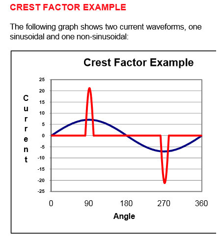

Sinewave of 8 volts RMS across 8 ohms is 8 watts
at the peak of the sinwave though it's 16 watts instantaneous.
If he can find a waveform with higher crest factor than a sine, what can he claim ?
programmablepower.com/support/FAQs/DF_Crest_Factor.pdf said:
it's limited only by his internal power supply voltage !
Red and blue traces have same RMS value but red one's peak is 3x blue one. He could claim 9X more "music power" than his honest competition's RMS for the exact same amplifier...
The worst of the abuses described in that TI paper is to calculate power using the internal power supply's highest transient voltage... liar liar pants on fire...
