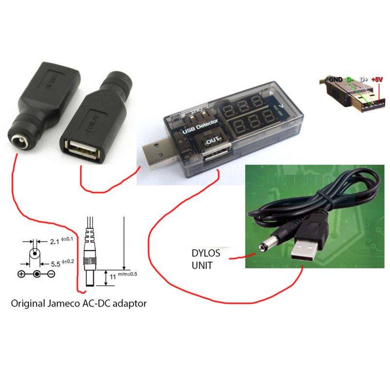

I have 6 discharged AA alkaline battery. I bought 2 NiMH rechargeable so I can remove the 2 alkaline and replaced them with the NiMH so I can see what happens in the USB ammeter/voltage when voltages goes below 6.8v. I just googled now it is hazardous. Thanks for the warning, I'm so ignorant.

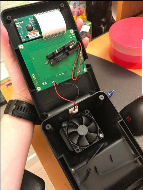

Here is the Dylos internal. I saw it shared by one user at amazon. The laser at the middle is aligned to the compartment below such that air is suck from the top to the bottom via the fan.

With my 7 AA rechargeable NiMH batteries I connected my USB ammeter/voltmeter.
I realized the USB ammeter/voltmeter is only calibrated for 5v. This is because when the voltage is 8.9v. The current is wrong. Using a multimeter. The current is 270mA instead of 200mA.
Do you know another device like the USB ammeter/volmeter that can accurately display the current?
What kind of circuit is it that can only show accurate current if it is 5v only?
At least the voltage is more or less accurate and I can predict if the rechargeble AA NiMH batteries are about to get discharged.
