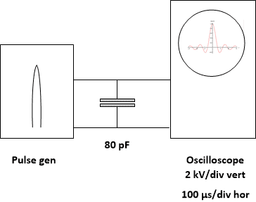

I am trying to calculate the energy within an electric field that is generated between two plates by a pulse but am unsure of what voltage value to use. The pulse is a sinc wave.
I am assuming I can still use the equation ## E= \frac{1}{2}CV^2 ##. I know the ##V_{rms}## and ##V_{max}## which is measured on an oscilloscope. The C value is measured by an LCR meter. I am thinking to use ##V_{rms}## as this provides the same work and energy as the equivalent DC value, however I am not sure as it is a sinc wave.
If I also know the frequency can I also calculate how much energy is within this electric field in 1 second by multiplying the Energy in one pulse by how many pulses occur in 1 second.

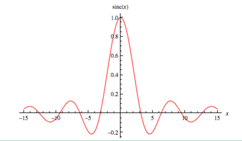

Sinc is partially negative. The integral is positive (##\pi##). I would use that.

If the pulse is ##\operatorname{sinc} x## the integral is ##\pi##
If the pulse is ##A\operatorname{sinc} x## the integral is ##A\pi##

Still don't see no picture ...
Of the setup. Of the pulse. And are we talking low, high frequency ?

What would you like a picture of? The setup is a pulse source connected to a capacitor and the voltage drop across the capacitor is measured.

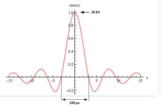

Using ##A π ## where A is the peak voltage of the sinc wave to find the energy in one pulse, then multiply it by the number of pulses in 1 second gives me more energy than the power supply delivers. Where am I going wrong in calculating the Energy within the electric field?
Perhaps in forgetting the time scale?
Ah so, it's not Aπ. It's the limits of the size of the sinc wave that I need to integrate between. If the pulse is 150us wide, then integrate between 0 and 150us:
## \int_{0}^{150} {A \, sinc \, x} \, dx ##

No. You want to scale the time axis
Scale the time on the oscilloscope? Or scale the time when calculating the integral? How do I scale the time when calculating the integral and to what?
I have the oscilloscope data. I cropped the data so I have one wavelength of the pulse. Are any of the methods below accurate in calculating the total energy:
1. Sum the voltages of every point recorded in the wavelength. Take the voltage total and divide by the number of points. This gives an average voltage per point. Use this to calculate the average energy per point. Multiply this by the total number of points in one wavelength to give the total energy per wavelength. Multiply this by the frequency to get total energy per second. Final value around 0.03J.
2. Calculate the energy per point using the voltage at that point in the whole wavelength. Sum all the energies at each point in the whole wavelength to get the total energy. Divide this by the number of points recorded in the wavelength to get the average energy per wavelength. Multiply this by frequency to get the total energy. Final value around 0.9J.
Each method gives a very different result. Capacitance is 80pF and Freq is 250Hz. Vmax is about 10kV. Pulse width approx 150us.
Are any of the above methods accurate? If not what would be the best method?

Easiest (if your pulse is really ##\operatorname{sinc} x## ) is to take the first zero point: ##\operatorname{sinc} x = 0## at ##x = \pi/2##.
[edit o:) ] that should be ##x = \pi##
If that is 10 ##\mu##s on your scope, you have the scale factor.
Do you understand what I mean ?

$$\begin {align*} \int_{-\infty}^\infty \operatorname {sinc} x \, dx &= \pi \Rightarrow \\
\int_{-\infty}^\infty \operatorname {sinc} \left (t\over a\right ) \, dt&= a\pi \end {align*}$$

What does the pulse look like ? Not like this ? :
If not, then what ? Post a picture of the scope image !

Do yourself a favor, post a schematic !
Very interesting. 10 kV capacitor ! Perhaps you also know the ouput impedance of the pulse generating device ? And of the oscilloscope input ? With a 10 kV vertical scale ?

The pulse is repeating, with a set amount of time at zero voltage, so I took one wavelength. Yes the pulse is very similar to your image but not exact.
What would the scope image and schematic provide you? When you ask for frequency are you asking for pulse frequency or some other frequency, can you be more explicit?
Oscilloscope 1MΩ impedance, Scope 900MΩ impedance. Not sure of the impedance of the pulse generating device but the resistance is approx. 9kΩ.
