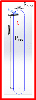

Hi,
I have a pipe that is unpressurized initially at atm internally with air. Inside the pipe there is a welded container that is vented at the top. The vent is made to have air pass through so that the internal pressure of the container eventually equals the pressure of the internal pressure of the pipe when it is pressurized to high pressures. The vents are there so that there isn't a large pressure difference. The walls of the container would fail if the vent wasn't there.
T=266F
Ppipe,initial=14psi
Ppipe,final= 1400psi
Pcontainer, initial= 14psi
Vcontainer= 106in^3
The pipe is then pressuriazed at a rate of 95psi/sec is this design good enough to prevent collapse of the container walls? In other words does the container equalize pressure fast enough to prevent failure? Assume a pressure difference of 200 psi or more between the walls of the container will fail it.
The vent comes off the container in the picture below:
https://ibb.co/hvz9qa

Only singular. 1 vent. The vent is shown in the picture with the diameter of the opening.
Edit: Also assume the pipe is a closed container
So, just to make sure I get the right idea about he problem to be solved:
The red box is the pipe and it's closed for all our purposes (how the pressure increases can be left outside our considerations).
If I treat this as a mathematician I'd set up the following problem statement:
$$P_{\rm pipe} = 14 {\rm\ psi } + 95 {\rm \ psi /s}\ \times t \quad {\rm for\ \ } t = \left [0, {1400-14\over 95 } \right ]$$ ##P_{\rm \ ves} (0) = 14 {\rm\ psi }## (this 14 psi surprisingly turns out to be atmospheric :smile:) and we want to check that $$\Delta P = P_{\rm \ pipe} - P_{\rm \ ves} < 200 {\rm \ psi }\ \ \forall t $$With that, the problem statement isn't complete: we need a flow into the vessel as a function of ##\Delta P## and we need an equation for ## P_{\rm \ ves} ## as a function of the holdup. The latter is easy : ideal gas law is good enough ##PV = nRT_{\rm abs}##. Brings us to a next level of detail: what happens to the temperature. Here I could enter only 211 F as the highest temperature, but it does allow entry in your funny units (sorry, couldn't reSIst :rolleyes: -- [edit] too hasty: in fact it does, sorry TLV!. Only 5/8" has to be converted to .625" and you don't get cubic inches out) and shows the equations used. Add them into your problem statement and get an altogether hideous differential equation for which I am way too lazy -- but you are welcome.
As a physicist I'd leave out the temperature business detail and still have a differential equation.
As an engineer I would be happy with treating this differential equation as a series of pseudo-steady states to get an impression of an estimated worst case:
The TLV link above tells me that if I wait 1 second before opening the vent, a pressure difference of 95 psi at 211 F though 0.625 " gives a flow of 2.6 Nm3/s;
(sorry, no cubic inch/fortnight available, but:) some work shows that's over 160000 N in3. In other words: the vessel catches up in no time.
As a blue collar mechanic (I'm not) I'd say: 5/8" is more than wide enough for a 2.75" diam vessel to keep up :smile: , even if it were five times as long; no worry at all.

The key to this is knowing the pressure drop-flow rate relationship for the 5/8" neck/vent. Without that, this doesn't seem doable. We need to get a blown-up view of the neck to determine it analytically, or it needs to be measured experimentally on a test rig. Of course, some experimental measurements would be preferable.
The diagram you made is correct for the problem I am talking about.Thank you all for your help so far! cubic inch/fortnight had me rolling on the floor.

What I'm thinking is this: Suppose, rather than having a short section of 5/8" opening, you had a 100' long section of hose. At the far end of the 100' section of hose, the pressure is rising at 95 psi/sec. Certainly, if this didn't lead to a 200 psi difference, then a short section would not either. And, we know how to calculate the results for the case of a 100' section of hose. So, the 100' section bounds the result for the actual situation. How would this grab you?
I actually simplified the opening to a straight tube coming off the vessel. In reality it looks like this:
http://imgur.com/a/Kd1tz
The domecap has slots cut into allow air to flow. The air travels to the top of an internal tube and shoots down into the larger volume portion of the vessel.
Do you think it would be good enough to simplify it as a 100' tube coming off the top? I know turbulence may affect it with the actual design.

There will be turbulence in the tube. In my judgment, it would be a very very conservative calculation.
100' of 5/8" is a hefty resistance.
But the dome cap in #9 sure looks a lot different (and less favourable) from what we saw in post #6 ! Is it true to scale ?
