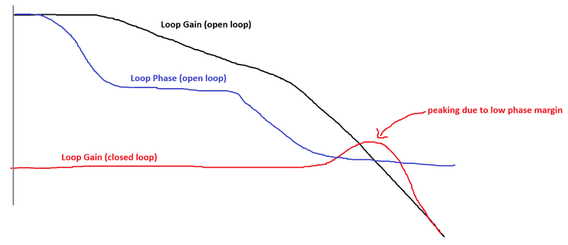

Thanks for the comments! Let me try to restate my question better:
i run a stability analysis and i get loop gain and loop phase. Whats the equation that combines these two plots as if it was still closed loop. Basically how do i get the LG/1+LG plot that includes the peaking that a low phase margin would cause in that plot. For example is it LG/1+LG+tan(phase)? (Thats not it, just an example of the form im looking for)
adding this plot to make sense of it. How do i combine black and blue plots into an equation that gives me red plot:

Just simply: LG = open loop gain (the black plot), LP = open loop phase (the blue plot). What is the expression that gives CL closed loop (the red plot) using LG and LP as dependent variables. I am certain it will include something like LG/(1+LG) but that does not consider LP (how it contributes to the peaking of the CL plot around LG = 0dB)

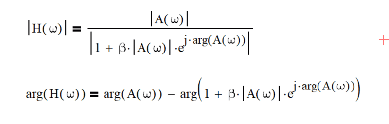

PS: Here's an answer, maybe you can figure out how to express it in a more insightful form:

I wasnt wanting you to do the algebra, i just didnt know that it was such a complicated task/someone had done it before.
For your |H(w)| equation, why is the complex exponential only in the denominator? shouldnt it also be a multiplier on the top as well?
That exponential of a purely imaginary number always has a modulus of 1. Since that equation is only for the modulus of H(z), it has no effect. On the other hand, in the denominator, it changes the modulus of the sum so it can't be ignored.

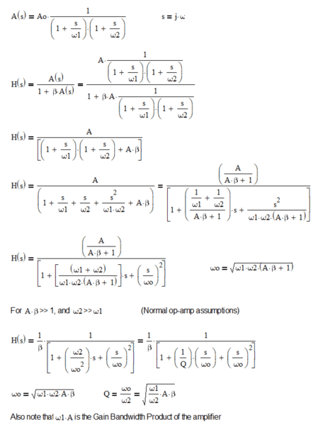

TLDR: modelling is better than brute force calculation.
There is a key difference in these two approaches. In order for you to calculate |H(ω)| at any given frequency ω, you must be given |A(ω)| and arg(A(ω)) at that frequency using the method in post #15. If you use the linear system model in post #11, all you need to know is a few key frequencies and a DC gain for the model, which are always the same for that system. I only need 4 constant parameters in this example to calculate the gain and phase at any of 1000 different frequencies. The other method would require 2000 pieces of data for the same results.
Then, if you want to change something, you'll have very little insight into its effect without repeating the entire calculation. For example, you wouldn't know that ##\omega_1 A \beta## and ##\omega_2## are the (only) two key parameters in determining the overshoot you are interested in. You also wouldn't know exactly at what frequency that occurs without guessing.

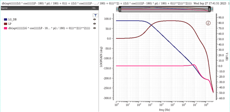

Ok i got it! It basically ends up being (x+yj)/(1+x+yj), where x = LG*cos(phase) and y = LG*sin(phase). It is a really complicated equation, but if you plug it in and take the magnitude of the resulting complex number, it gives you the correct waveform with the peaking and everything!
Thanks DaveE and company for the help. I have one more question that maybe im overthinking. I needed to take the magnitude of the complex number, but i was initially just taking the Re{} part. Its been a while since college, in what scenarios do you want the magnitude and what scenarios do you want the real part?
Mostly you'll want the magnitude. For example, when you represent gain and phase with a complex number (signals, impedances. amplifiers, etc.).
Sometimes you'll see in analysis people will make the math easier by starting with the assumption that only the real part counts, but using a complex number. For example you could say ##cos(\omega t) = Re[e^{i \omega t}]## instead of ##cos(\omega t) = \frac{e^{i \omega t} + e^{-i \omega t}}{2}##. In this case they don't need any phase information in their problem.
