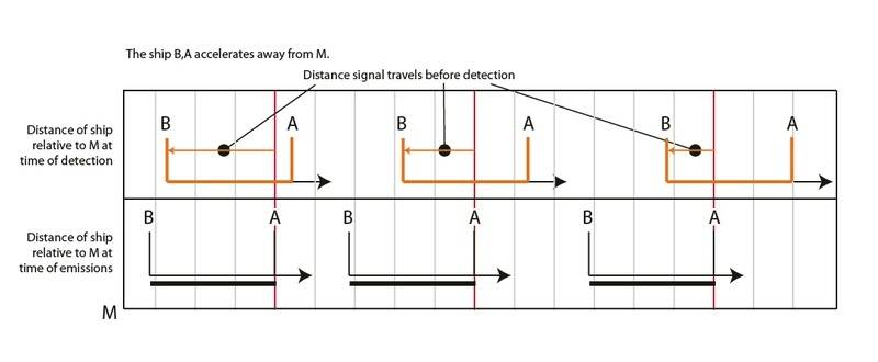

Please look at the chart posted below and let me know if you agree or disagree.
I think this will put it to rest.

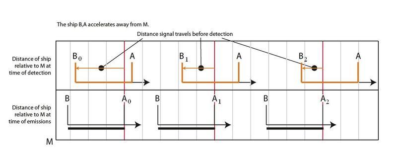

  • #61
Chrisc said:
Two clocks in a gravitational field separated by an altitude of x, exhibit constant time dilation.
Two clocks accelerating in free space separated by the length x of their ship, exhibit non-constant time dilation.
How is the principle of equivalence sustained when this fundamental measure of acceleration differs?
I agree with the drawing, it is exactly what you have been saying over and over and over. It doesn't support your claim.
It supports the claim that the time between A0 and B0 as measured by M is longer than the time between A1 and B1 as measured by M. That is not your claim. Your claim is that the time between B0 and B1 as measured by B is longer than the time between B1 and B2 as measured by B. This drawing doesn't demonstrate that, nor does anything you have written anywhere in this thread in either English or math.
  • #63
Chrisc,
from your diagram I would say that the relative velocity (v) between the emitter and detector ( separated by length L) at some time t is -
v = at - a\left(t + \frac{L}{c}\right) = -\frac{aL}{c} ( assuming at t=0, a=0 )
which is constant if acceleration a is constant. So the red-shift would not change over time.
I did this during my lunch break - could be wrong, or not relevant even.
M
  • #65
Thanks DaleSpam and Mentz114, it is now quite clear why you're disagreeing, and thanks for putting the event IDs on my image DaleSpam, it helps make the problem much more obvious. The issue is not math it is the justification of B's measurement.
My claim has always been that the time between A0 and B0 as measured by B, is less than B's calculation of H/c and larger than the time between A1 and B1 measured by B. Where H is the distance between B and A at rest with respect to each other. Before you take issue with the claim that B is even capable of measuring A0 with respect to his own clock, remember all the events of emission are pre-designated by A and B to occur at regular intervals according to the clocks they synchronized before moving to the front and back of the ship.
Since you agree the time between A0 and B0 as measured by M is longer than the time between A1 and B1 as measured by M, then you must agree that the time between A0 and B0 as measured by B is less than H/c as measured by B and longer than the time between A1 and B1. If you do not agree with this you must explain how B measures the speed of light between A and B to decrease over time.
Once again, before you begin to calculate the relativistic addition of velocities, the point is not how "you" will explain away the speed of light, with the knowledge you have of the situation, it is how B explains away the speed of light, as we are discussing the principle of equivalence not the principle of a God's Eye frame.
The only options B has to reconcile the time of detection with the agreed rate of emissions are:
1) reject the constancy of the speed of light.
2) consider A's clock to be running faster than his
He will likely pick 2. and conclude:
the force he measures on the ship is a) gravitational or b) inertial acceleration
The testing of light signals as described above will, over time, tell him:
the ship is in inertial acceleration in free space.
  • #66

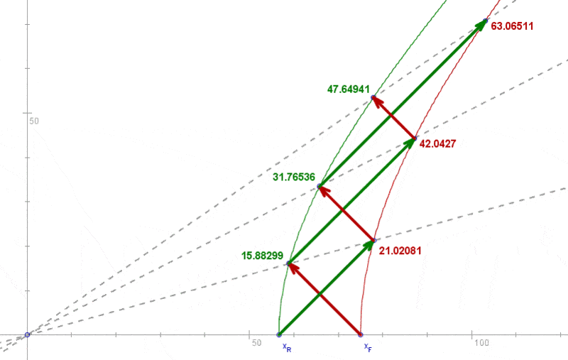

  • #72
kev, check DaleSpam's revision of my diagram in #62. I think it will bring you up to speed on my point.
Mentz114 said:
Your logic is too tortuous for me.
It's a strange way to communicate, asserting that if I disgree with proposition A then I'll be claiming that proposition B is true etc. How do you know what I'll be claiming ? Maybe your logic is faulty and I'll claim something completely different.
Mentz114, it shouldn't difficult or tortuous. I simply meant if you do not agree with the constancy of the speed of light then you are claiming the speed of light is not constant. Which in my opinion requires explanation.
This is a huge problem. If you honestly believe that this is the same claim you have been making throughout this thread then it is plain that you don't even understand the terminology. Your claim has always been that the time dilation of A relative to B is time varying. In this scenario time dilation is the ratio of A1-A0 as measured by A to B1-B0 as measured by B. It is not "the time between A0 and B0 as measured by B".
Since you are so fond of the "if you don't agree with X then you will be making the claim that Y" form of argument, then I will post my own:
If you do not clearly and rigorously derive your claim from first principles then you will be making the claim that your assertions are illogical.

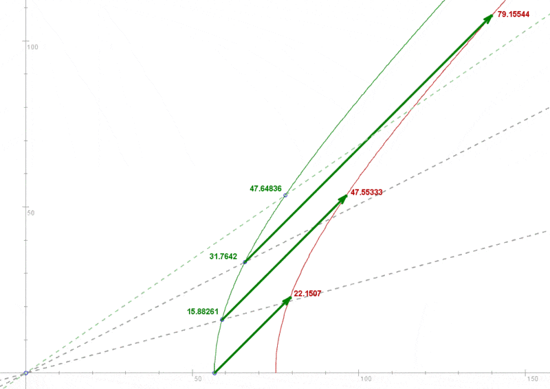

DaleSpam said:
The proper distance (in the accelerating frame) was stipulated to be constant in https://www.physicsforums.com/showpost.php?p=1743187&postcount=7". So it is Born rigid acceleration.
OK, I have uploaded a spacetime diagram for Born-rigid type acceleration. In the digaram it can be seen that signals sent at regular intervals of 15.88 seconds from the rear of the rocket (as timed by a clock at the rear of the rocket) will arrive at the nose of the rocket (in this example) at regular intervals of 21.02 seconds as timed by the observer at the nose of the rocket. In other words the time dilation and red shift of internal signals observed inside the rocket undergoing Born-rigid acceleration remains constant over time. I used the equation of acceleration described here http://math.ucr.edu/home/baez/physics/Relativity/SR/rocket.html which take length contraction, time dilation, syncronicity and changing acceleration over time (as observered by the non accelerating observer into account. (Almost none of these things are taken into account by the diagram posted by Chrisc.
On the other hand it can be shown that an observer at the nose of a rocket undergoing Bell type acceleration WILL see the clock at the rear of the rocket get progressively slower over time, while the the observer riding at the rear of the rocket will see the clock at the nose progressively speeding up over time. Therefore redshift of internal signals is not constant over time in this model, which can be described as the equivalent of a uniform gravitational field. The second diagram shows the proper time of the arrival of the signals at the nose of the rocket when signals are sent at regular intervals from the tail of the rocket undergoing Bell type acceleration.
  • #77
Thanks kev, these are excellent diagrams. The most important thing for Chrisc to note here is that the one effect that he repeatedly mentioned, the progressive reduction in time between emission at the front and reception at the back, is included in this diagram. That effect, by itself, does not imply a time varying time dilation.
The important thing for Chrisc to note here is that the proper distance is increasing. So the equivalent gravitational situation would be that H is increasing also. Since the gravitational time dilation depends on H then in such a case the time dilation in the gravitational field would also be non-constant.
There is no reason to expect that the equivalence principle would not hold in either case.
  • #78
Thanks kev, your diagrams are very helpful and address the crux of my question.
They also show my question should have been qualified in context of a "uniform" gravitational field.
DaleSpam, I take it you're saying I have compared the equivalence of a "uniform" field
with Bell type acceleration, instead of Born type. In other words an accurate comparison
of equivalence should be either "uniform field - Born type acceleration" or "non-uniform field - Bell type"
That does make sense, but I'm not sure it resolves the problem.
My question is a matter of principle. I am very stubborn when it comes
to principles (and I am grateful for your patience) which is why this thought
experiment has always caused me angst.
kev, in your description of Bell type acceleration you mention the observer
onboard the rocket would "consider" the rocket to be getting longer
over time. This is what DaleSpam has been telling me.
Can you explain or point me to where I can find an explanation
of the line of reasoning that justifies this conclusion of length contraction?
I was under the impression the length of the rocket could only be determined as a
measure of time, which would require some principle (or least metaphysical
modeling) to make the leap from decreased rate of time to increased length.
