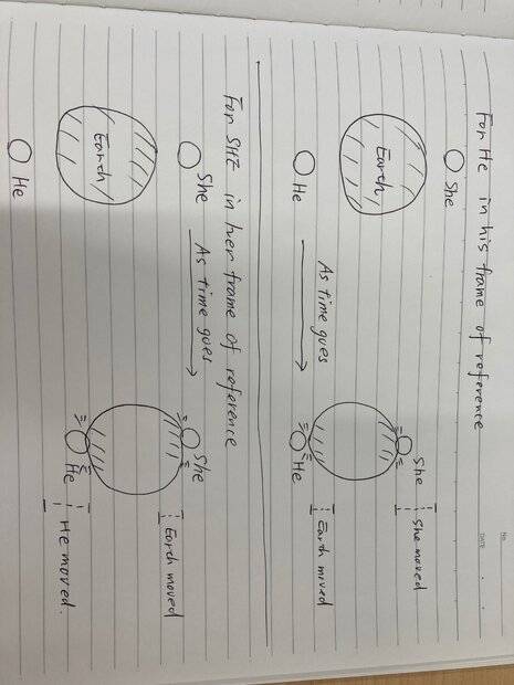

Re: post #12
One skydiver has his own frame of reference and another skydiver has her own frame of reference. They do not coincide but explain the events in good accordance.
For an example,
He observes the Earth coming to him with some acceleration and in its backside her coming with more acceleration.
She observes the Earth coming to her with some acceleration and in its backside him coming with more acceleration.
I don't get either of those explanations, at least not in regards to the question I asked (I don't have any physics background at degree level but I am learning more each day!). So if you were to chose one, would you say the person is accelerating down, or the Eather accelerating up? I do not believe this is relative to each other due the description of what "proper" acceleration is above which Dale explained.
Please find attached the sketch for my post #12. I hope it may help us for good communication.
An object on the surface of the Earth is subject to a force and hence proper acceleration. The object in freefall is subject to no force and has no proper acceleration. When measured from the accelerating reference frame of the Earth's surface, the falling object is accelerating downwards. Compare the house and car example above.
This is an I level thread, which assumes some knowldege of concepts such as local and global reference frames.
Either is fine locally (i.e. as long as you don't think about skydivers on opposite sides of the Earth). But globally you end up with something like "you are (coordinate) accelerating towards the Earth".
The fun bit is that the Earth's surface is genuinely undergoing proper acceleration outwards. It doesn't move anywhere, though, because we're in curved spacetime, and acceleration doesn't necessarily lead to movement except in flat spacetime...

If you want to understand GR you need to find a way to stop thinking entirely in terms of classical physics. Even SR is explicitly incompatible with classical notions of space and time.
Note that I fully understood your question.
Each point on the Earth's surface is accelerating outwards. But, acceleration is not motion. And, in curved spacetime, that continuous acceleration does not lead to any change in the size or shape of the Earth.
To analyse the entire globe you need a global frame of reference and that entails including curved spacetime. You can't pretend the entire spacetime is flat, anymore than you can pretend the surface of the Earth is flat. Even though, locally, it may be flat to a good approximation.
This is the price for abandoning gravity as a force. You can't just give up the gravitational force and carry on with Newtonian concepts. If you give up the gravitational force, you must adopt general relativistic spacetime.
Locally, by choosing inertial coordinates you may continue to apply a somewhat classical description of a falling object. But, that only works locally. Each skydiver may use their own frame locally, but these local frames do not extend to encompass each other.

mucker said:
My point was, if for example I skydive at north pole, then the Earth is proper accelerating in that direction, but if another person was skydiving from south pole then the Earth is proper accelerating to them too. The Earth can't be accelerating in opposite directions at the same time otherwise it would explode...Or… can it?
All the skydivers and the Earth have zero proper acceleration.

  • #35
anuttarasammyak said:
Re: post #12
For an example,
This is wrong, because neither skydiver's frame covers a large enough region of spacetime to include the other skydiver (or even the whole Earth--only a small portion of the Earth's surface nearest to the skydiver is covered). So neither skydiver can attribute "more acceleration" to the other skydiver than to the nearest portion of the Earth's surface.
  • #36
Ibix said:
But the surface, and any region inside except at the very center, does have proper acceleration outwards from the center, just to be clear
Thanks. Now I understand forces preventing every parts of the Earth free falling and keeping the shape of the Earth provide proper acceleration. For an example when I am standing, the floor push my feet to give proper acceleration g upward. Skydivers keep zero proper acceleration while falling but will start to get proper acceleration after unfortunate crash.
