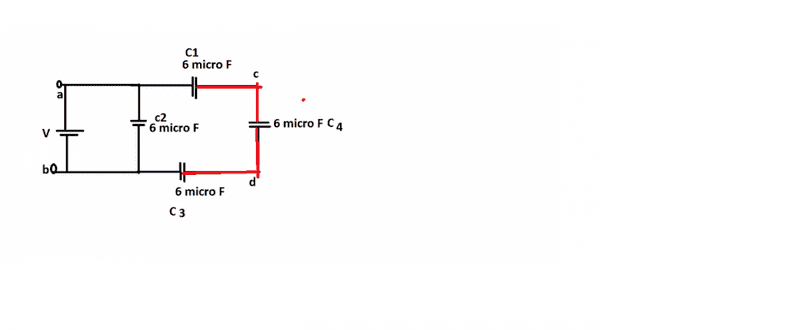

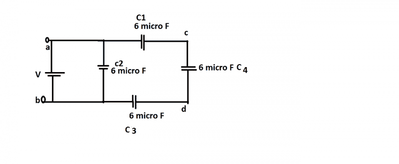

What is the Potential Difference Between c and d in This Circuit?
In summary: When you simplify component networks you lose analytical access to nodes that get absorbed into the replacement components. Sometimes you just have to leave some components unsimplified to retain access to nodes you need.
gracy
2,486
83
If 100 volts of potential difference is applied between a and b in the circuit .Find the potential difference between c and d.
2. Homework Equations
For Equivalent Capacitance in series
##\frac{1}{C}##=##\frac{1}{C_1}##+##\frac{1}{C_2}##For Equivalent Capacitance in parallel
##C##=##C_1##+##C_2##...
##Q##=##C####v##
[/B]

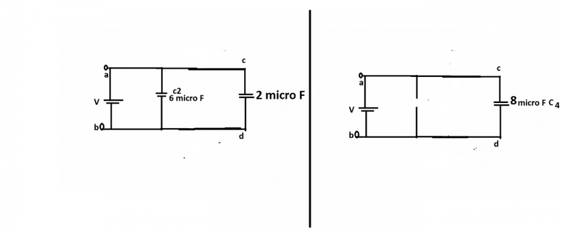

Equivalent capacitance between c and d (using series connection formula)
C1,C3 and C4 are in series
Ceq=2μF
this C eq and c2 are in parallel hence (using parallel connection formula)
Ceq'=8μc
This C'eq is in parallel with voltage hence it should have potential difference equal to 100 volts but it is wrong .I want to know why?
When you combined all the capacitors into one you "lost" the nodes c and d in the process. You simplified the circuit sown to a single capacitor that is situated between node a and b. In fact you lost c and d in your first simplification when you combined the three series capacitors into a single 2 uF capacitor. You mistakenly placed c and d node labels around it, but nodes c and d no longer exist in the simplified circuit. What you found is the potential across a and b, which you already knew since it's a given.
What you should do is first consider (as a slight but essential digression) a voltage divider that consists of capacitors in series. If you place a potential across a series-connect string of capacitors, how can you determine the potentials across the individual capacitors in the string?
Likes gracy

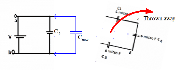

No,I deliberately place c and d .
You mean nodes c and d should not exist in the simplified circuit?
But why ?As I have clarified this earlier https://www.physicsforums.com/threads/equivalent-capacitance.845489/page-2
post #22 and #23
that we can place equivalent capacitors wherever I want and should replace other component capacitor with wire,I did that.

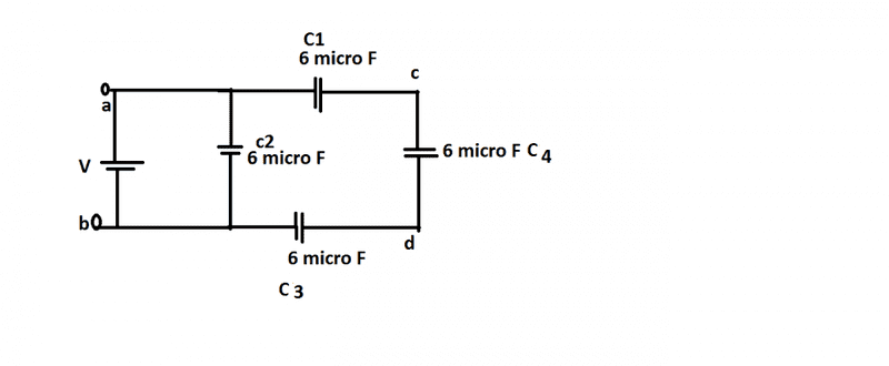

A 'series' combination of 3 capacitors is connected across 100V supply. You don't need equivalent capacitance for calculating the voltage across the middle capacitor (Vcd).
##Q##=##C####v##
View attachment 92911 [/B]
Ceq=2μF
Ceq'=8μc
C1 and C3 are not in between c and d. Also, if you want to calculate equivalent capacitance between C and D, your source should be between c and d. What you've calculated is the equivalent capacitance between a and b.
you mean voltage source?
Right.
You created new labels c and d where they were not previously located. In the original circuit c and d surrounded the middle capacitor in the string of three. You collapsed the string and moved the labels c and d to the outside ends of the string where it connects to the rest of the circuit. In fact your new labels c and d are identical to the nodes identified by a and b.
Right. They were abolished when you reduced the three capacitors. Effectively you cut off the branch containing the three capacitors and nodes c and d and replaced it with a single new capacitor. You lost c and d when you did that.
post #22 and #23
Likes gracy and cnh1995

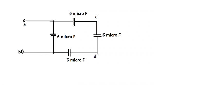

Here we need c and d so should I not simplify the series connection between C1,C3 and C4 ?
Yes. You needn't consider C2 too..
Correct.

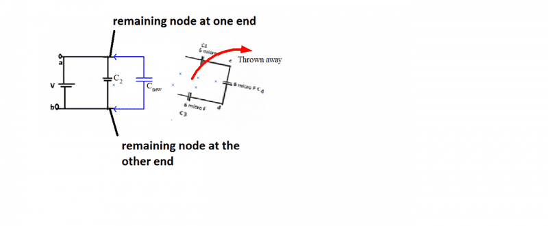

is blue node new node?It wasn't there previously?
The item in blue is new, yes, but there's no new node. The new capacitor connects to where the old string of three capacitors connected, and those two nodes existed before. In fact they are nodes a and b: just follow the wires to the labels near the battery.
Likes gracy

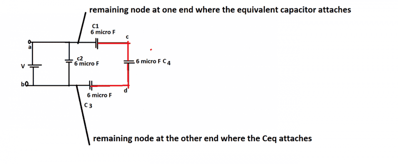

in post #9
gneill said:
Remember, when you collapse a series of components down to one then you will be eliminating any nodes that were along the path, leaving just the two nodes at the ends where the "new" component attach.
Red nodes-eliminated nodes
Blue nodes-new introduced wires with equivalent capacitor
Black nodes-nodes which are left at the points of attachment of the new (equivalent )capacitor at both ends
I understood where I was wrong.All thanks to you guys.How shall I proceed from here?
gracy said:
How shall I proceed from here.
:smile:
gracy said:
I understood where I was wrong.All thanks to you guys.How shall I proceed from here.
Just use voltage divider for the series combination in the original diagram.

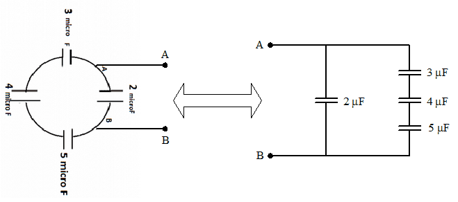

https://www.physicsforums.com/threads/equivalent-capacitance-circular-arrangement.845579/page-3
#post 51
It matters in that it would change the problem to a different problem. You can't determine the potential between c and d due to the 100 V at a and b if you place yet another source somewhere in the circuit. In fact, placing a source across c and d would force that potential to be whatever that new source supplies, and would be completely independent of the a-b source.
Likes gracy
Thanks.
gneill said:
it implies that you need a voltage source in order to determine the equivalent capacitance.
But I have seen some problems in which I was asked to determine equivalent capacitance between two points and there was no voltage source.
A source won't change the capacitance between nodes?
Then what voltage source does?
gracy said:
But I have seen some problems in which I was asked to determine equivalent potential between two points and there was no voltage source.
Then the potential difference must have been zero. Unless the voltage source was already charged capacitors and there were no paths for discharging them. Capacitors retain their charge if there are no closed paths for them to discharge through.
Perhaps you should post one of these problems as a new thread.
It provides a potential difference. In circuits where current can flow it provides the potential that drives current.
Likes gracy
  • #31
gracy said:
I had already posted.
As in here
I was asked to find equivalent capacitance in between A and B but there is no voltage source between those two points.
I think I am missing something.
It has been stated previously: a voltage source will not change the capacitance between nodes, and it is not required to determine the capacitance between nodes. That problem does not ask you to find a potential difference between nodes, just capacitance.
Likes gracy
