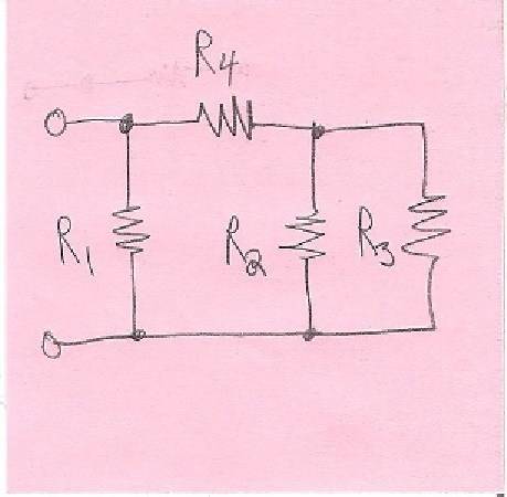

Find Req.
Series: R1 + R2 + ...
Parallel: 1/(1/R1 + 1/R2 + ...)
There's no solution for this one in the book but I'm thinking that I can break this up into two parallel sets. Parallel1 = (R1*R4)/(R1 + R4) and Parallel2 = (R3*R2)/(R3 + R2). Is that correct?

It's not exactly very easy figuring out that diagram, why not do it properly on paint and then upload the image?
Yeah it didn't keep the white space. Sorry
Your parallel2 is correct.
What is inbetween the right end of R4 and the bottom end of R1?
The same voltage?
Oh wait.. If I combine Parallel2 into the circuit as one unit it will now be in between the right end of R4 and the bottom end of R1.
If you consider R1 and R4 in parallel, it has to be connected to the negative terminal right? What's helping completing the circuit?
Parallel2
http://slimber.com/index.php?image=resistors.g80803
See if that helps you visualize it better
Sort of.. If it was drawn like that then would the solution be:
1/(1/R1 + 1/(R4 +R2) + 1/R3) ?
