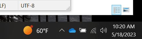

Maybe it's an unusual driver? What does the Device Manager show you for your USB eBook Reader device when you plug it in. If you look at the ^ icon in the lower right of the Windows toolbar and click on it when you first plug in the eReader, does it show that it's looking for a driver for it?
The one labeled "Show hidden icons"? Nothing special shows up there.
It's an ancient B&N Nook -- I don't see anything on their website about drivers.
Yes, the little ^ symbol at the lower right of the bottom bar in Windows:
If there is a new USB device plugged in, clicking on that symbol brings up a pop-up that lets you click on a little spinning icon to see what the install is doing. I use that to watch the progress of USB device installations, in case there is a problem.

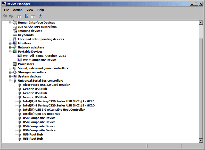

If you open the Device Manager and plug/unplug the device, do you see any changes in the devices listed?
Nothing that I can see.

My Dev Mgr looks like this when USB is expanded but I do not own this device.
