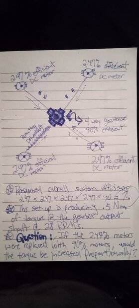

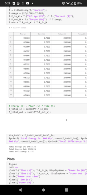

Please see the attempt sketch. Basically I have four very inefficient DC motors all commonly turning a single drive shaft at the center of the system. Currently these motors that are 2.47% efficient individually able to produce 5 newton meters of torque at 28 RPMs. So my question is this. If I replace those 2.47% efficient motors with a motor that is exactly the same but 90% efficient, can I use a multiplier of 36.4 to roughly estimate what the new torque value would be? (.5 Nm * 36.4 = 18.4 Nm)
Well, almost.
The gearbox has some losses you did not account for - for instance:
If that gear box is only rated for the original torque, the system efficiency will be Zero when the gear teeth break off! :oops:
Cheers,
Tom
That would be awfully low. So low that it's already suspicious.
Could you please tell us how did you determined the efficiency of those DC motors?

Another spin on this very weird question:
Electric motors are rated based on output power and rpm, not input electrical power so if you replace these 4 motors with otherwise identical single motor at much higher efficiency it will provide 1/4 the output power that the 4 motors do combined.
You seem to be approaching this problem backwards, but it is hard to tell because we need the rest of the story we aren't getting...

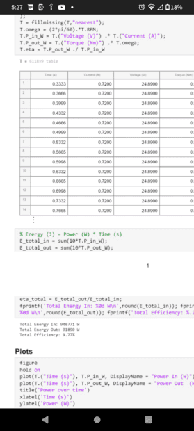

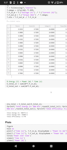

I'm strictly talking from an individual motor perspective..... let's just forget about the gearbox for the moment. If the existing motor is currently at 2.47% with the capability of producing .5 newton meters at 28 RPMs on a bench test, could we replace that motor with a 90% efficient motor and use a multiplier to presume what the new output to work would be?

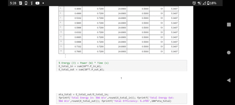

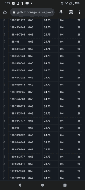

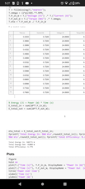

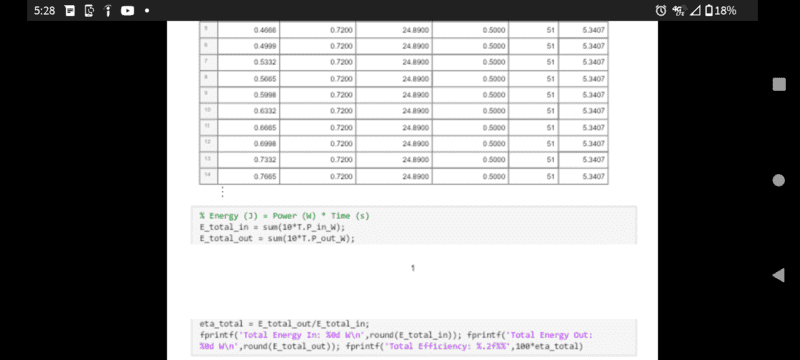

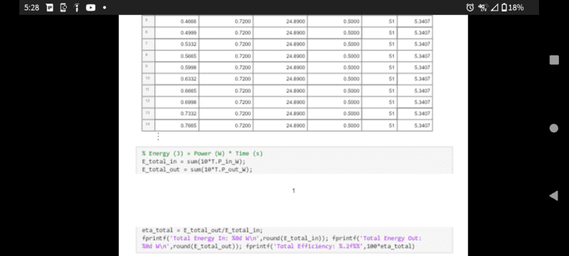

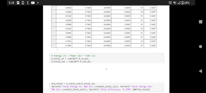

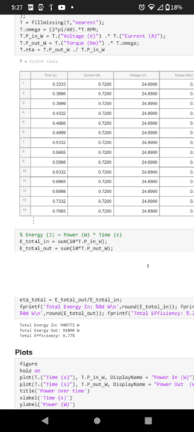

Sure, I used a digital torque transducer, an oscilloscope,, MATLAB, and some output data to come up with this efficiency number. Please see the attached screenshots.

Bench test set up was as follows:

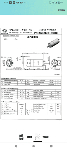

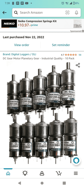

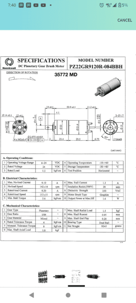

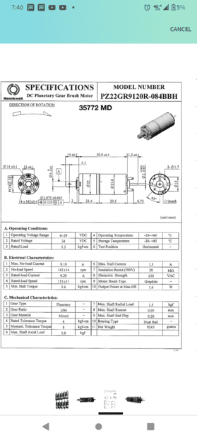

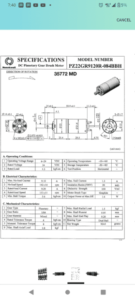

Please see attached spec sheet for the exact motor I'm using. Yes, I am pushing it beyond its normal operating capabilities to get it to do what I needed to do. I get that. I bench test this motor across a broad spectrum of RPMs and loading characteristics. I used a digital torque transducer and matlabs to process the data. I will also attach a screenshot of that information. To answer your question, I never said it was theoretical, I said is it possible to come up with a theoretical based upon a real world known efficiency. And that particular efficiency in my case is 2.47% efficient. Horrible I know, but just go with it.

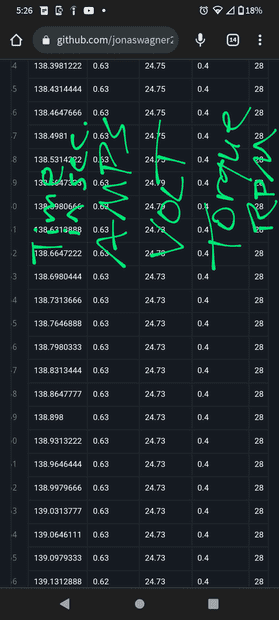

I label the Matlab data here so you can see what I was getting from the digital torque transducer

Trolling means not being sincere in your posts or images. I'm not able to decode your fuzzy images that you've uploaded. Please post links to your 4% efficient electric motor datasheet.

Here's the full report. Please see attached. The data points that are illustrated on the second page are just the first few seconds of the test. The entire file included thousands of data points over 200 seconds.
Are you able to open up that adobe file?
Did you get my response? I've given you everything that you asked for I believe.

Your motor is putting out near its rated torque according to its data sheet.
5.6kgf-cm = 0.55n-m
See:
https://www.justintools.com/unit-co...1=kilogram-force-centimeters&k2=newton-meters
Also, your motor seems to be over loaded or defective. 28RPM vs. 113RPM??
Datasheet says 113RPM @ 24V, and 5.6kgf-cm @ 0.2A
Your Test Data 28RPM @ 24V, and 0.4n-m @ 0.4A
Or perhaps your test setup has a problem.

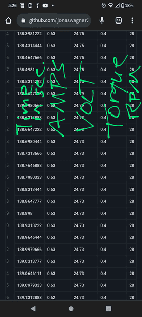

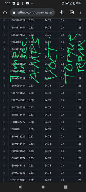

Well, the data sheet indicates much better efficiency than you measured. It may be because of how you are running or measuring it (edit: or motor fault as Tom suggests). Again, as I said, motors are rated for output power. So your best bet is to look at data sheets and find a motor that matches your requirements and buy that. You're approaching the problem backwards and I think applying constraints you don't know/guessed instead of what you do. .
I'm not sure what information you are looking at when tring to select the motor. And where are you getting this 90% efficiency number?

Yep. When I noticed you have no noise on your 'measurements' from the linked tables I could smell that there is a trick somewhere...
I won't comment on made-up data, since in this context that's about expectations and not about measuring anything. Next time please make sure you properly mark real and theoretical stuff. For theoretical purposes it's not that bad to make things up but against readers, colleagues and any audience you are expected to properly identify which is which and what is why.
IRL it's a career ruining type of issue. Mind it. Seriously.

Based on the provided information - 'I am pushing it beyond its normal operating capabilities to get it to do what I needed to do.' - you have proper, high efficiency drives operated far out of normal op range.
You need to reevaluate the requirements and get a motor which can do the job while operating within spec.
Unless specified by the manufacturer there is no way to tell what happens out of normal working envelope. And adding more variables won't help that.
If you bring any new '90% efficient' motor out of spec, it'll of course won't operate at the specified efficiency. You'll be back at square one.
