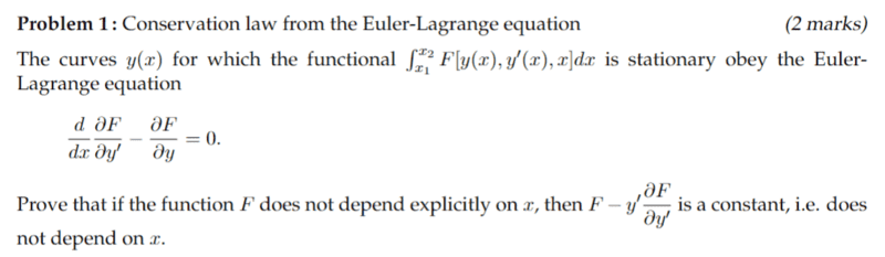

For this problem,
The solution is,
However, I have a question about the solution. Does someone please know why they write out ##\frac{dF}{dx} = \frac{\partial F}{\partial y}y' + \frac{\partial F}{\partial y'}y''## since we already know that ##\frac{dF}{dx} = 0##?
Thanks!
I believe you are confusing total derivatives with partial derivatives
##\frac{dF}{dx}## and ##\frac{\partial F}{\partial x}## are not the same thing.
  • Love
Likes member 731016
To expand in the above:
In general, without the condition ##\partial F/\partial x = 0##, we would have
\frac{dF}{dx} =
\frac{\partial F}{\partial x} +
\frac{\partial F}{\partial y} y’ +
\frac{\partial F}{\partial y’} y’’
by virtue of the chain rule for derivatives. Apply the condition to obtain what is in the proof.
