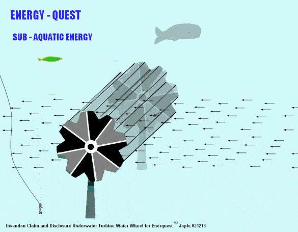

Hello, . .
I have this concept sketch, of a new configuration from what I have been seeing in,.
"wave energy", (in this case tide flow force energy), . .
I believe that generally speaking, as a concept, there seems to be
advantages.
Although this is just the water wheel without turbine in place, .
I'd like your take, . . ?

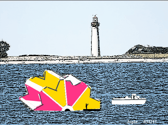

Water Wheel Concept Envisioned At Low Tide
In a way this concept is the opposite of the water wheel that was once used to power river boats, instead of energy turning it in the water, the water turns it into energy, with that in mind, my gut feeling tell me it will produce more energy that a turbine powered by a blade in the water, that resembles something like a wind generator.As seen here;

Regarding the “Turbine Water Wheel” diagram in post number one, and the diagram of a similar mechanism in post number three:
The cylindrical structure seems to be rotating counter-clockwise (from my viewpoint) and the water current seems to be moving from right to left. If these observations are correct, how does the wheel feel any rotational force at all? On the “upstream” or right side where the moving water first comes in contact it seems it would apply a force to upper half of the wheel in the counter-clockwise direction, as shown. But that same current is acting at the same time on the lower half of the wheel and applying a clockwise force. Would these forces not cancel out, resulting in ZERO rotation? Am I missing something?

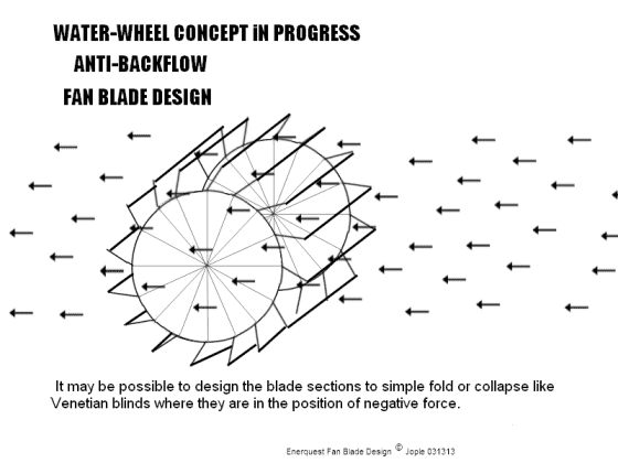

Your design has merit, though I would look into these potential problems; the first sketch appears to have two wheels with cables connecting them together, if so, would they survive the stress? Also the second sketch, if you think upon the engineering here, it is similar to a what you would see on a paddle steamer, this type of design requires a propulsion mechanism to rotate against the resistance of the water, and in doing so provides motion.
Also, it is similar to a water-mill, where the effect of cascading water on each blade provides motion as well as dynamic energy. perhaps if you installed it beneath a waterfall you would get year round energy that does not fall victim to a lack of wind or wave.
Bobbywhy, I think your right, there is a point of cancellation, it may be possible to design the blade sections to simple fold or collapse like Venetian blinds where they are in the position of negative force. Therefore allowing the force to push against the sectors that are it its path, and are the blades that will allow it to gain momentum, and prevent the negative force from cancellation.

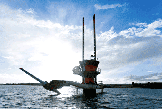

Underwater turbines exist and they typically look like wind turbines.
Yes I know that as I posted a picture post 4, . they do not seem to have virtuous power.

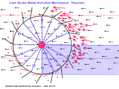

Hello Prima Terra & Bobbywhy, . .thanks for you feedback, . .
I am relating to a concept that might oppose the cancellation
or neutralization from counter force. Such as this;

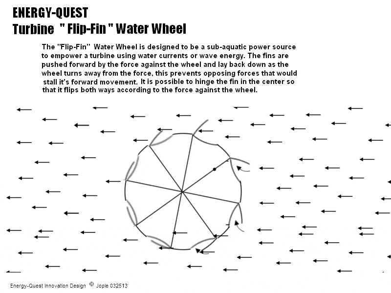

I believe the obstacle of negative momentum can be solved, and
there is no lack of force to turn it, whether it be on the surface, near the surface,
or under the surface, (wave or current).
The possibilities to give the wheel blades a mechanism, . . for maximizing on the water born forces against the wheel that will turn it, . . in my opinion exist and can be illustrated in the absence of demonstration, by the concept of blade extrusion or elevation from the wheel surface as the case may be. There also exist the capacity for the blades to act as flaps, rising and falling in a natural but beneficial way.
