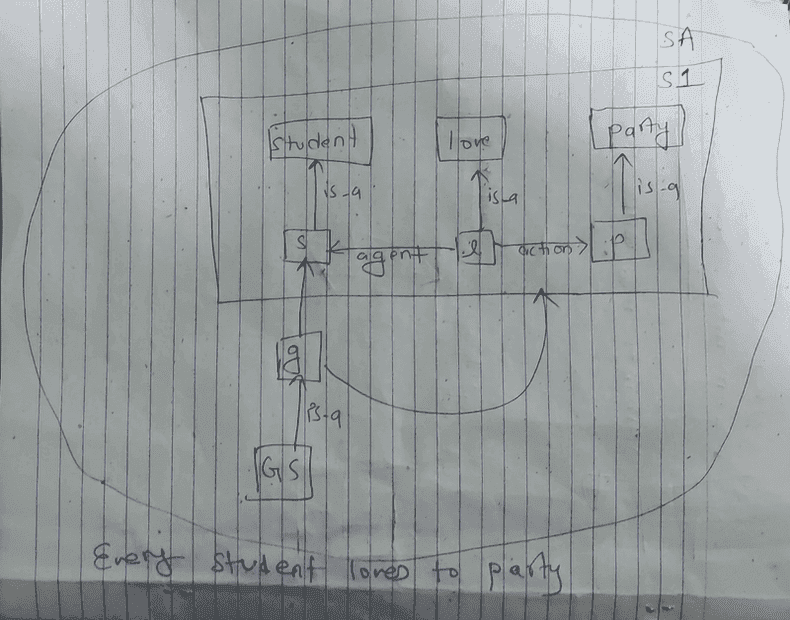

correct or not, why? why not?
none
1 example to represent the question in semantic net.
Second question-: every student loves to party. Represent this in semantic net.
The answer is below-:
Can you provide some context? What book is the solution from?
I couldn't find any reference or tutorial on the GS block diagrams that are shown and how they are generated from the semantic network of the sentence.
hmm not frm a book instead from slides. it is impossible for me to collect every possible book.
