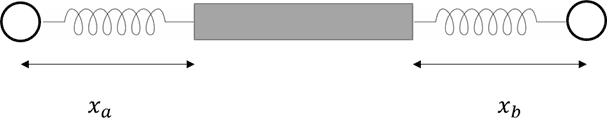

Two damped, unforced springs are weakly coupled and obey the following equations of motion: $$\ddot{x}_a +\gamma \dot{x}_a + \omega_{0,a}^2 x_a + \beta^2 (x_b - x_a) = 0$$ $$\ddot{x}_b +\gamma \dot{x}_b + \omega_{0,b}^2 x_b - \beta^2 (x_b - x_a) = 0$$ You wish to measure the difference between the two springs' natural (undamped) resonant frequencies: ##\Delta = \omega_{0,b} - \omega_{0,a}##. Your measurement will be complicated by the coupling coefficient β and the damping coefficient γ. Design a simple procedure for measuring ##\Delta##.
Assume for simplicity that ##\omega_0 = \frac{1}{2}\left(\omega_{0,b} + \omega_{0,a}\right) = 1\mathrm{kHz}## and ##\gamma = 125\mathrm{s^{-1}}## are known exactly. You are also given that Δ is of order ##2\pi\times 1\mathrm{mHz}## and β is of order ##2\pi\times100\mathrm{mHz}##. The uncertainty in either spring's measured position is determined by the spring's initial conditions by $$\sigma_x = \left(2.6\times10^{-7}\right)\sqrt{x(0)^2 + \frac{\dot{x}(0)^2}{\omega_0^2 - \gamma^2 / 4}}$$
Your answer should include a set of times at which to measure the spring positions ##x_a## and ##x_b##, a formula for ##\Delta## in terms of these measurements, and a standard deviation on the value of ##\Delta##. Optimal answers should have uncertainty ##\sigma_\Delta \approx 2\pi \times 10\mathrm{\mu Hz}## with as little as two position measurements. Numerical and analytical methods are accepted so long as the results are valid!2. "Honey, I shrunk the error bars!"

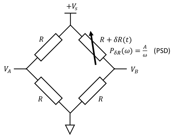

Consider the following bridge circuit, where the variable resistor sees "pink" noise (aka 1/f noise):
All 4 resistors have identical resistance on average, but the top right resistor fluctuates with a pink spectrum: $$P_{\delta R}(\omega) = \frac{A}{\omega}$$ where ##P_x(\omega)## is the power spectral density (PSD) of the function ##x(t)##. Each resistor also puts out thermal noise (Johnson-Nyquist noise). Find an expression in terms of the measured voltages ##V_A##, ##V_B##, and ##V_S## that is proportional to the fluctuating resistance ##\delta R## but is independent of thermal noise.
Some sample data is attached (filename is “pinkdatafinalfinal.csv”), where each voltage (##V_A##,##V_B##, and ##V_S##) is reported versus time in a CSV format. Extract the constant A as defined above and state your uncertainty on A, given ##R = 1\mathrm{\Omega}##. My solution has uncertainty on the order of ##1 \times 10^{-8} \mathrm{\mathrm{\Omega^2}}##. There are many methods for tackling this problem and some give higher precision than others.

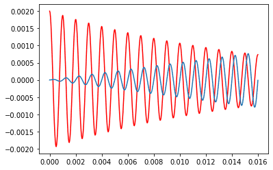

Since this is a coupled spring problem, the first step is to think about normal modes. There are two of them in this problem. They can be solved analytically, but you get more insight by taking series approximations (first order in ##\Delta##, and second order in ##\beta##). To get the normal mode frequencies, first take a Laplace transform of the equations of motion, and write it as a matrix:
$$\left( \begin{array}{cc} s^2 + \gamma s + (\omega_0 - \frac{\Delta}{2})^2 - \beta^2 & \beta^2 \\ \beta^2 & s^2 + \gamma s + (\omega_0 + \frac{\Delta}{2})^2 \\ \end{array} \right) \left( \begin{array}{cc} X_a(s) \\ X_b(s) \end{array} \right) = 0$$ For this to hold for any value of the Laplace transform vector, the matrix must have determinant equal to 0 at the natural frequencies of oscillation (i.e., the normal modes). You can solve for the normal modes analytically, or you can do it on paper more easily by dropping higher order terms carefully. Solving analytically and splitting s into real and imaginary parts ##s = \sigma \pm i \omega##, you get $$\omega = \sqrt{\omega_1^2 - \beta^2 + \left( \frac{\Delta}{2} \right)^2 \pm \sqrt{\beta^4 + \Delta^2 \omega_0 ^2}}$$ where ##\omega_1 = \sqrt{\omega_0^2 - \gamma^2 / 4}## is the damped resonance frequency for a single spring. Expanding the expression for the normal mode frequencies, $$\omega_{\pm} \approx \omega_1 - \frac{\beta^2}{2\omega_1} + \frac{\Delta^2}{8 \omega_1} \pm \frac{\sqrt{\beta^4 + \Delta^2 \omega_0 ^2}}{2\omega_1}$$. In the problem statement, you were given that ##\omega_0 = 1\mathrm{kHz}##, ##\beta \sim 2\pi \times 100\mathrm{mHz}##, and ##\Delta \sim 2\pi \times 1\mathrm{mHz}##. From this, you can conclude that ##\sqrt{\beta^4 + \Delta^2 \omega_0 ^2} \approx \omega_0 \Delta## with a truncation error on the ##10^{-4}## level. Therefore, the normal mode frequencies are, to very good approximation, $$\omega_{\pm} = \omega_1 - \frac{\beta^2}{2\omega_1} \pm \frac{\omega_0}{2\omega_1} \Delta$$, where the ##\Delta^2## term has been dropped since it is 4 orders of magnitude smaller than the ##\beta^2## term.
Notice in the above analysis that there are two normal modes denoted by the subscript ##\pm##. They are both shifted down from the uncoupled case by a common-mode shift of ##\frac{\beta^2}{2\omega_1}## and they are shifted apart by a splitting of ##\frac{\omega_0}{\omega_1} \Delta \approx \Delta##. This suggests that you can measure ##\Delta## by measuring the beat frequency of the two normal modes. To do this, you want to prepare both modes with equal amplitudes initially. The neat thing is, you don't actually need to find the normal mode coordinates. Because the equations of motion are symmetric under interchanging ##x_a## and ##x_b##, you know the normal mode eigenvectors will be identical under a parity flip. In other words, if normal mode #1 contains 90% of ##x_a## and 10% of ##x_b##, then normal mode 2 will contains 90% of ##x_b## and 10% of ##x_a##. (If this weren't true, then you'd have to conclude that the physical system discriminates between ##x_a## and ##x_b##, which it doesn't to leading order.) Thus, you know that any initial state where ##\dot{x}_a = \dot{x}_b = 0## and ##x_a = x_b## will contain equal weights in both normal modes. Thus, you can prepare that state and watch the beat signal in the quantity ##x_b - x_a##, as in the hints I shared. As I hinted, you can find this out with much less headache by playing with a numerical simulation.
Now that you have a way to measure ##\Delta##, you can get a frequency uncertainty by measuring the slope of the envelope of ##(x_b - x_a)e^{+\gamma t}## (see Figure below, where the red trace is ##x_a + x_b## and the blue trace is ##(x_b-x_a)e^{+\gamma t}##). The beat signal (with the exponential decay multiplied out like above) goes like ##x_0 \sin(\Delta t) \cos(\omega_0 t) \approx x_0 \Delta t \times \cos(\omega_0 t)##, which you can verify with the numerical code.
Thus, you can extract ##\Delta## by measuring out to near decay time (##T = \frac{1}{\gamma}##) at a point where ##\omega_0 t = 2n\pi## and taking the slope of the envelope divided by the initial amplitude. This gives an uncertainty on ##\Delta## of ##\sigma_\Delta \approx \gamma \frac{\sigma x}{x(0)} = 2.6\times 10^{-7} \times 125 \mathrm{s}^{-1} = 2\pi \times 5\mathrm{\mu Hz}##. This takes two measurements: one position measurement on each spring.

This one is mostly a data analysis problem. For starters, note that ##V_S##, ##V_A##, and ##V_B## are all noisy signals. A quick bit of Kirchkoff laws analysis will show that $$V_A = \frac{V_S}{2}$$ (it's a voltage divider). Likewise, since the other side of the bridge is also a voltage divider,$$V_B = \frac{R}{2R+\delta R} V_S = \frac{V_S }{2} \left( 1 + \frac{\delta R}{2R} \right)^{-1} \approx \frac{V_S}{2} \left( 1 - \frac{\delta R}{2R}\right)$$
Taking ##V_A - V_B##, $$V_A - V_B \approx V_S \left(\frac{\delta R}{4R}\right)$$
Finally, if we divide by ##V_S##, then we get $$\frac{V_A - V_B}{V_S} \approx \frac{\delta R}{4R}$$ Since this quantity doesn't depend on the voltages, only on ##\delta R##, it only contains the pink noise (no white noise mixed in).

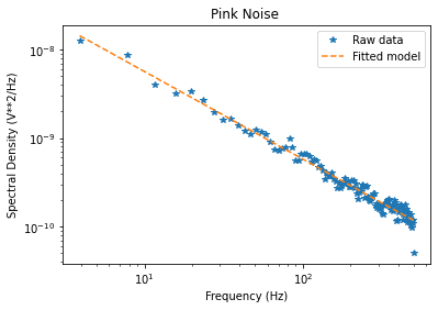

With that much worked out, the next step is to load the data into your preferred data analysis software and get an estimate of the power spectral density (PSD for short). I used python, because it's the free-est.
Step-by-step, what I did is import the data and take the ratio I defined above of the voltage columns. I then take a PSD estimate using the Welch periodogram method. Since the PSD of pink noise goes as ##PSD = \frac{A}{\omega}##, I find the constant A by doing linear regression on the logarithm of the data: $$\ln (PSD) = \ln A - \ln \omega$$ The estimated intercept from the linear regression gives the constant A.

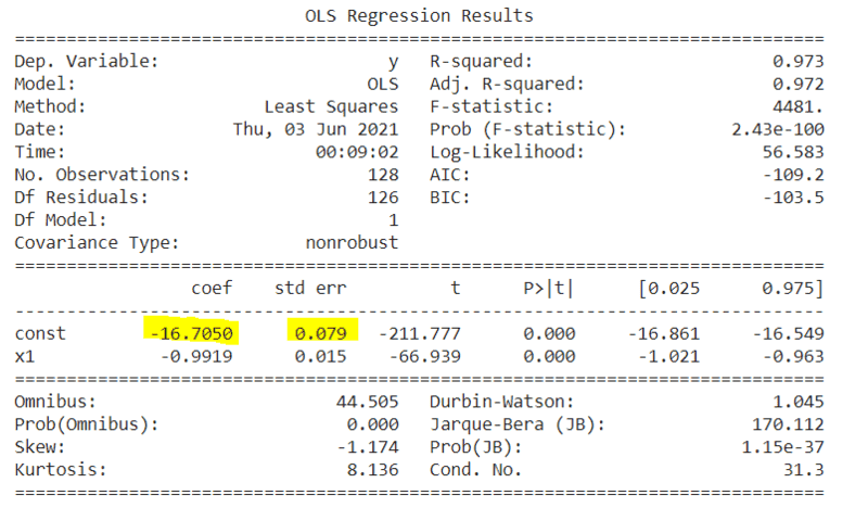

And here's my output results:
The results reported there don't include a factor of 2pi, so with that taken into account, my final answer was $$A = 3.49(28) \times 10^{-7} \mathrm{\Omega}^2$$
