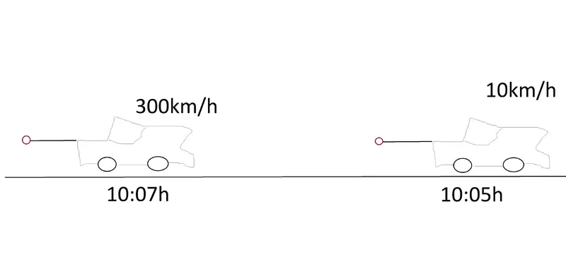

This is not homework question, I use numbers to easier explain my question.
Static pressure is caused by bouncing molecules in normal direction at walls, the faster air travel, the less force at normal direction(static pressure) and more force in direction of flow(dynamic pressure). Is this correct?
Atmospheric pressure is 101325 Pa, car drive at two speeds, first at 10km/ and then at 300km/h at flat road, at same altitude.
Is static pressure:
a) for both speeds same as atmospheric pressure
b) for both speeds lower than atmospheric pressure, and lower at 300km/h than at 10km/h
I think a) is correct answer, Bernulli cant apply here(faster speed = lower static pressure)
Is this correct and why here pressure dont drop with speed(as Bernoulli state)?
russ_watters said:
A. Is correct. Bernoulli says this: p is just p.
So it isnt less bouncing force from molecules in normal direction at higher speeds?
russ_watters said:
No. Unless you have something else in mind that you haven't stated you seem to be describing this:
https://www1.grc.nasa.gov/beginners-guide-to-aeronautics/pitot-static-tube-speedometer/
Yes static port at pitot tube show same static pressure for every speeds, so it show that static pressure dont depend on airflow speed.

A.T. said:
Speed is frame dependent, while pressure differences are frame invariant. So it wound not make sense if the later was determined by the former.
P1+1/2pv1^2=P2+1/2pv2^2
If I enter here v1=500km/h and v2=200km/h, p=1.2kg/m3,
P2 would be not same as P1
Why here Bernoulli is not valid?
user079622 said:
Yes that is good explanation. How can we use this analogy to explain pressure drop in accelerated flow?
We can't. Different situations are different.

So when I said "Unless you have something else in mind that you haven't stated...", this was it?
I want to find where can I use Bernoulli, why I cant use it...
What exactly is it that you don't understand? Bernoulli's principle obviously applies to both situations if you use it correctly.
This was what?
How would use it Bernoulli correctly for my first post?

Imagine you are compressing fluid in a piston cylinder assembly with the end closed . You push on the plunger; the water is pushing in any way it can to relive the elastic potential being stored in it. It cant move much(compress) itself, and the pipe is trying to contain it (so it is expanding). If the nozzle opens under this force of the plunger a flow begins to accelerate (from rest) as that elastic potential in the pipe walls and fluid is converted to kinetic energy of the flow. So the two things are coupled. Accelerating flow is the outcome of internal energy change to kinetic energy. In that scenario to ##t=0## the pressure will start high and decline as the flow accelerates out of the end of the tube. What I'm talking about is a time varying Bernoulli's to get a handle on how pressure is generally converted to kinetic energy, its easier to get a handle on this way. It's not "Classic Bernoulli" you encounter in steady flow (flow not varying in time) but it's an extension that I think helps clarify. Why this translates to steady incompressible flows that experience a change in their container shape is because of mass conservation. So for steady flow is spatially varying pressure, mass is entering across some surface at some rate and unless it's being stored or temporarily compressed it's got to exit. So it's using that internal pressure energy to accelerate the flow to satisfy the mass conservation constraint. So it seems that that mass constraint "decides" what must happen, and it takes from the available energy reserve it can alter.
$$ 0 = \frac{ d}{dt} \int_{cv} \rho d V\llap{-} + \int_{cs} \rho ( \boldsymbol {V}\cdot d \boldsymbol{A} ) $$
Bernoulli's is a special case of the First Law of Thermodynamics for a control volume:
$$ \dot Q - \dot W_s = \frac{d}{dt} \int_{cv} \rho \left( \frac{V^2}{2} + gz + u \right) d V\llap{-} + \int_{cs} \left( \frac{V^2}{2} + gz + u + \frac{p}{\rho} \right) \rho \boldsymbol {V}\cdot d \boldsymbol{A} $$
It's not hard to be "deceived" by it, there is much to study. I've been trying to chip away at it for many years myself.
Likes dextercioby and russ_watters
