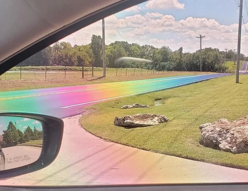

I found an image showing the same effect in Reddit:
Here is a link that mentions the polarization of light in the kind of meteorlogical rainbows that we are all familiar with. According to that posting, water rainbow light can be 94% polarized.
However, what I am seeing (and what is shown in the photograph) is not a water-based rainbow. the conditions outside have been warm and sunny - plenty enough to dry out any water. And the photo above shows the sheen in direct sub (note shadows of power lines).
Also, this is not the result of thin-film-interference. Notice that in the photo above, there is a hint of the color bands even in the concrete in the foreground.
And in my view outside, I also see the pattern resume from one side of a median strip to the other.

The photo above comes from this link. ...
... which is entitled "Polarized glasses creates effect of rainbow road".
It was posted 3 years ago - and several posters identified the effect as the stress marks you can see in some windows when wearing polarizing glasses. However, I think you can tell, that's not what it is.
However, I do believe that that side window is up. First because those windows don't usually roll completely down. Second, because that white "spray" looks like a reflection of the base of the windshield to me.
The color saturation in that photo is roughly double what I saw in the parking lot. I credit that to the "incidental polarization" of the building windows vs. the intentional polarization of the polarizing glasses.
And this color saturation is much better than the usual rainbow - likely because the fresh pavement provides a very dark background - in contrast to the fairly bright sky behind the usual rainbows.
