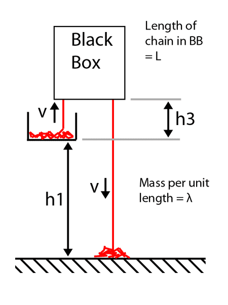

If I may, I would like to discuss a black box model for the situation. In the description of its expected behaviour, I partway follow the steps that were made in the paper. Looking at the figure attached to this post, I have adopted most of the symbols that are used in the paper. I have not used a variable h2 to denote the height the loop reaches above the container: rather, I have included a variable h3 (to avoid confusion) to indicate the height of the bottom of the black box above the chain links lying in the container, but that value can be set as close to zero as desirable. I leave the precise loop geometry unspecified and put a black box around that part.
Now, assuming that the chain has reached the phase where it is flowing along a stationary (stable) trajectory, its links are all moving at velocity v. All moving links of the chain move at this velocity, only their direction of motion is different at different points along the trajectory. If we consider the black box and the forces that act on its contents, we can say that both the chain segment entering it and the chain segment exiting it exert some vertical force T on its contents. These forces have to be tensional forces (chains do not transmit compressional forces - at least the type used in this experiment does not), and they have to be equal: if they were unequal, the contents of the black box would have a net torque acting on them resulting in an angular acceleration of its contents and a changing chain velocity. The other external force acting on the black box is gravity, acting on all the mass in the black box: F_g = M_bb * g = L * lambda * g. So, the sum of external forces acting on the black box is F_total = -2T -F_g = -2T - L * lambda * g.
Looking at the traffic in and out of the black box, we see a segment of chain entering it with an upward velocity and an equally long segment of chain exiting it with a downward velocity (after all, the mass inside the black box is constant over time). Per unit of time, mass M_in = v * lambda is entering the black box with vertical momentum P_in = v^2 * lambda. Mass M_out = v * lambda is exiting the black box with vertical momentum P_out = -v^2 * lambda. The change in momentum per unit of time is thus: P_out - P_in = -2 * lambda * v^2. This has to be equal to the external forces experienced by the black box:
2 * lambda * v^2 = 2T + L * lambda * g.
The tension force T can be calculated by considering the length of chain moving down from the black box to the ground. This entire segment moves at constant velocity v, but experiences a gravitational force of F_g1 = h1 * lambda * g. So the tension force T has to be equal to this (sum of forces on descending chain segment = zero).
Filling in the value for T, we get 2 * lambda * v^2 = 2 * lambda * h1 * g + L * lambda * g. Isolating the velocity term, we get v^2 = h1 * g + L * g / 2. This result relates the size of the loop (L being the length of chain in the black box) to the velocity of the chain.
To solve for v or L independently, we would need a separate piece of information besides what I've discussed here it seems.
