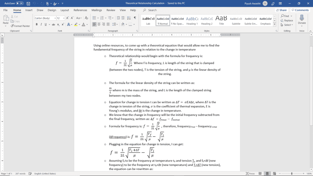

Hey guys, I am a 16-year-old high school working on an experiment to investigate the relationship between the frequency of the guitar string and the temperature of the air around it. Please help me understand my findings and correct any mistakes.
So, my apparatus consists of a basic wooden plank with a nail on one end and a guitar tuner on the other. I plan on using a heating lamp to control the temperature of the apparatus, which is placed inside an insulation box, and use a non-contact infrared thermometer to measure the temperature of the air around the apparatus and the string itself. Lastly, I'm using audacity to graph a plot spectrum and measure the frequency produced by the guitar string. I am currently trying to work on a theoretical formula relating to frequency and temperature, as this would compliment my experimental findings and allow me to have a better understanding of my experimental values. Furthermore, I would like to see if I can explain any discrepancies between the predicted theoretical values and the experimental findings. Currently, my formula relating the two variables is:
  • Assuming f0 to be the frequency at temperature t0 and tension Ti, and f0+Δf (new frequency) to be the frequency at t0+Δt (new temperature) and Ti+ΔT (new tension), the equation can be written as:
  • Δf = (1/2L)*sqrt([Ti + σEAΔt]/μ) - 1/2L * sqrt[Ti/μ]
  • ,σ is the coefficient of thermal expansion, E is Young’s modulus, and Δt is the change in temperature

Hey!
Yes, I did, I have attached the file below. It shows me deriving my formula. Please do let me know if you think it can be simplified further or improved!

Please post that file again as a PDF file, or as a screen capture picture? You can paste a picture directly into the posts.
I worry about cybersecurity, so I will not open a DOC file sent by a stranger over the Internet.

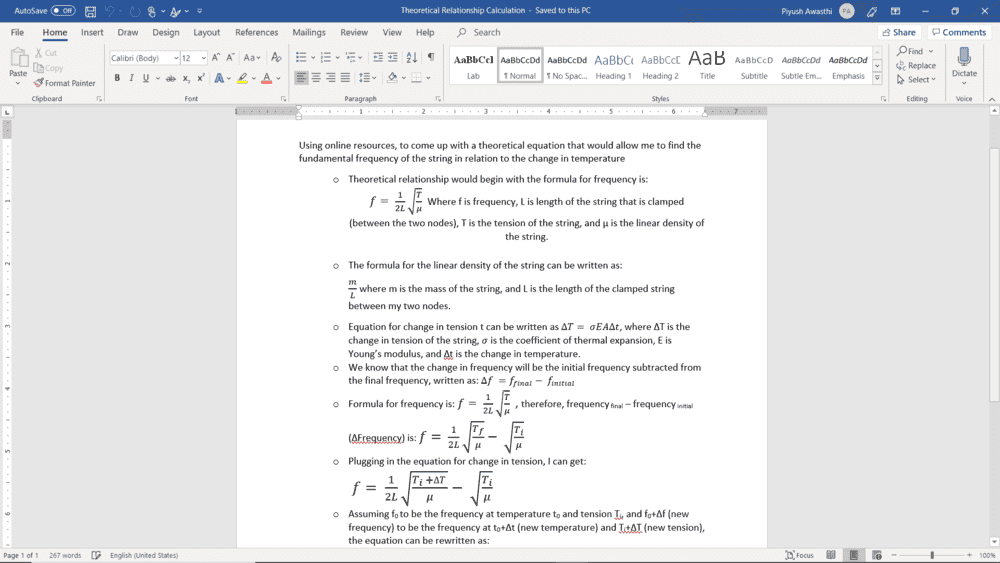

Shouldn't the tension decrease as the temperature is increased?
You seemed to switch from ##\alpha## representing the coefficient of linear expansion to ##\sigma##, correct?
Have you had calculus yet?

Yes the tension of the string will decrease with a change in temperature, which I am trying to model mathematically by relating tension to youngs modulus, change in temperature and coefficient of thermal expansion.
And yes, my bad but I did switch signs there.

So you have $$\Delta f=\frac{1}{2L\sqrt{\mu}}(\sqrt{T_i-\alpha EA\Delta t}-\sqrt{T_i})$$What do you get if multiply numerator and denominator of the right hand side by $$\sqrt{T_i+\alpha EA\Delta t}+\sqrt{T_i}$$and neglect the quadratic term in ##\Delta t##?

I'm sorry, I would end up with a quadratic right? But why do I need to do so, is ther esomething wrong with my current formula?
Be prepared for a surprise. I believe the CTE of wood is typically 30 ppm / °C along the grain. Piano wire is only about 10 ppm. The wood will get longer faster than the wire, so you can expect tension in the wire will increase with temperature.

Right. There would be no quadratic term. So what do you get?
Here's another interesting approach to consider. Since the initial frequency and tension are related by:
$$f_0=\frac{1}{2L}\sqrt{\frac{T_i}{\mu}}$$and the fréquency and tension after any temperature change are related by: $$f=\frac{1}{2L}\sqrt{\frac{T}{\mu}}$$if we divide the 2nd equation by the 1st equation, we obtain:$$\frac{f}{f_0}=\sqrt{\frac{T}{T_0}}=\sqrt{\frac{T_i-\alpha EA\Delta t}{T_i}}=\sqrt{1-\frac{\alpha EA\Delta t}{T_i}}$$Squaring both sides then gives:$$\left(\frac{f}{f_0}\right)^2=1-\frac{\alpha EA\Delta t}{T_i}$$Solving the first equation for ##T_i## in terms of ##f_0## and substituting into this equation then yields: $$\left(\frac{f}{f_0}\right)^2=1-\frac{\alpha EA}{4\mu L^2 f_0^2}\Delta t$$or $$f^2=f_0^2-\frac{\alpha EA}{4\mu L^2 }\Delta t$$Note that this equation no longer contains the initial tension or the present tension as a parameter, meaning that the tension does not need to be measured. The equation indicates that a plot of ##f^2## vs ##\Delta t## should be a straight line with an intercept of ##f_0^2## and a slope of ##-\frac{\alpha EA}{4\mu L^2 }## (which only involves the length and material parameters of the wire).
Assuming that @Baluncore's assessment is correct, the same kind of relationship will apply (i.e., s straight line relationship between ##f^2## and ##\Delta t##), except that the slope can be positive (or less negative), and will depend on the properties of both the wood and the wire.

Assuming that @Baluncore's assessment is correct, the same kind of relationship will apply (i.e., s straight line relationship between f2f2 and ΔtΔt), except that the slope can be positive (or less negative), and will depend on the properties of both the wood and the wire.
Wow, this took me a while to understand but yes this is a lot easier! It's just really complex algebra but it will remove one of the experimental parameters, therefore reducing uncertainty. And tension had been a really hard thing to measure for me because I was measuring the initial frequency to find the initial tension and then substituting for final tension for initial tension plus thermal stress. I will give this approach a shot too!
Plus, you are right it a linear function is a lot easier to analyze!
Oh also, I noticed I had a stray variable A in my initial calculations that does not signify anything. The formula for thermal stress is simply young's modulus, coeffecient of expansion and change in temperature
