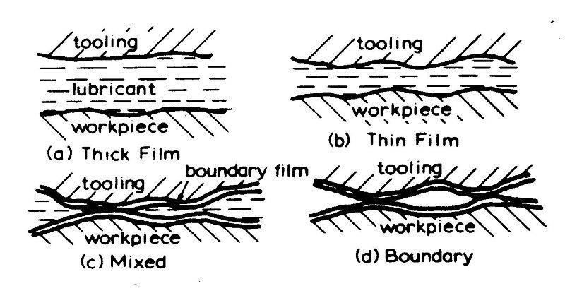

A theory of friction between two surfaces of similar hardness is that actual contact is between asperities (high spots). Since initial contact is point contact, the contact stress at points of contact is very high, about three times the yield stress of the material. See Case (d) in the diagram below, but without the lubricant film.
The two surfaces are moving relative to each other, and they are not separated by a lubricant film. The asperities weld at the contact areas, and are sheared off as fast as they weld. The high strain rate in the shear zone generates enough heat that sheared off particles burn up. These are the sparks that you see.
