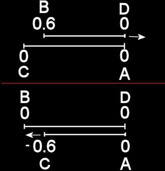

Clocks according to "Sausage" and "Roll", according to each when their midpoints pass and each sync their clocks to zero.
Top is for the rest frame of the "sausage", bottom is for the rest frame of the "roll" . Thin cylinder is the sausage and thick transparent one is the roll. Numbers are rounded to the nearest 1/10.
A bit later, when the midpoint clock of the sausage meets the clock just to the left of midpoint ( as shown in the image). Again top is sausage frame, bottom is roll frame.
Sausage frame: Clock in roll starts 0.8 ly away, and thus takes 1.3333 yrs to reach the midpoint clock by the sausage clocks.. It ticks off 1.3333 x 0.8 = 1.06667 yr during that time. when it started it already read 0.6 years, thus it reads 1.6667 years upon arriving at the sausage midpoint.
Roll frame. Sausage midpoint clock starts reading zero and 0.8 ly away. It take 1.6667 years to reach the Roll's clock and ticks off 1.3333 years in doing so.
Thus both frame agree as to what the clocks read when they meet. This works out to be true for any pair of clocks.
As to what happens if either undergoes acceleration until they are at rest with respect to each other:
If the sausage undergoes acceleration, then It will measure the Roll as growing in length and its clocks as matching each other in synchronizing. It will measure its own clock as going out of sync with each other.
The roll will measure nothing happening to itself or its clocks, but will measure the sausage as growing in length and its clocks going even further out of sync. At the end both will agree that the roll clocks are in sync, while the Sausage clocks aren't. they also would both agree as to the respective readings of any two clocks that end up next to each other.
The reverse happens if it is the Roll that accelerates, the roll clocks will end up out of sync and the sausage clocks will be in sync.
The upshot is that which of the two undergoes the acceleration does make a difference in the outcome, but both will agree as to what that end result would be.
Not sure why there is any asymmetry. In your second diagram why it appears different to the "sausage" than it does to the "roll".

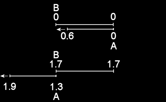

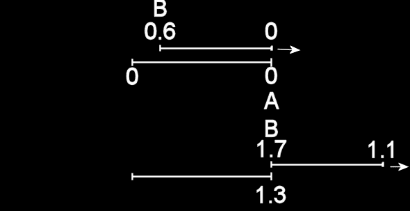

Call the clock on the Roll B and the One on the sausage A. Both scenarios start when the midpoint clocks are adjacent and read zero.
So, in the sausage frame we start like the top diagram and end as the bottom diagram.
The distance between Clock A and B is the same as the distance between Clock B and the roll midpoint clock. This is 1 ly in the roll frame, but length contracted to 0.8 ly in the sausage frame As B moves to the left to meet with A, A advances 1.3 yrs and B advances 1.1 yrs.
In the roll frame:
We still start as the midpoint clocks meet and read zero. But now, the distance between A and B is the distance between B and the roll midpoint clock as measured in the Roll frame and is 1ly. As A moves to the left to meet up with A, it takes 1.7 yrs according to the clock in the Roll frame and The sausage clocks tick off 1.3 years in that same time.
What about the two clocks that passed each other when both were 0. Will they show the same time, or will it matter which underwent the acceleration to be at rest with the other? If the latter then does the interval between when they were set to 0 and the acceleration?
In the roll frame:
Still not getting it. The top of each of the diagrams seems symmetrical but the bottoms seem different, and I am not sure why given the symmetry of their top. It seems like you are suggesting it makes a difference which is the "sausage" and which is the "roll". Is that what you are suggesting?

Each image is a set of diagrams showing two different times: When the "midpoint" clocks meet and both read zero, and then later when the "sausage" midpoint clock meets the next clock Left of the midpoint clock of the "pastry". So I don't see where you get any asymmetry begin the top and bottom diagrams in each image.
Maybe animations will help:
The pastry is the red line and its clocks are the red ones, blue represents the sausage and its clocks. Both the pastry and sausage measure their own clocks as being 1 ly apart and their clocks synchronized to each other. The starting moment in each animation is when two clocks, each reading zero pass each other. I'll limit the animation to just two clocks in each frame to keep things simpler.
First the pastry frame:
The rightmost clocks both start at zero. The sausage and its clocks move to the left at 0.6c until its rightmost clock aligns with the leftmost pastry clock. We pasuse to compare clocks. The sausage clocks are closer together than the pastry clocks because the pastry is length contracted. The left sausage clock reads 0.6 sec before the right one due to the relativity of simultaneity. (though this clock doesn't have an active roll in this situation.). Both sausage clocks tick 0.8 as fast as the pastry clocks due to time dilation.
Now the sausage frame. Note that we have not changed anything about the scenario, we are just switching the frame from which we are making the observations.
Both right clocks still start at zero. But in this frame, it is the pastry that is in motion (left to right), and undergoes length contraction and whose clocks undergo time dilation and are effected by the relativity of simultaneity. Thus the left pastry clock starts with a reading of 0.6 yrs, and starts only 0.8 ly from the right sausage clock.
Thus it only takes 1.33 yrs for the right sausage clock and left pastry clock to meet. During which time, the pastry clocks run at a rate 0.8 that of the sausage clocks and advance 1.07 years, and since the left pastry clock started at 0.6 years, it reads 1.67 years upon reaching the right sausage clock.
I am fine with the time dilation due to acceleration being proportional to the amount of time at a given acceleration thus as the time spent accelerating tends to 0 the time dilation due to it tends to 0. What I am not clear about is that if the central clocks were coloured red and all other clocks green, then when the "sausage" ship's red clock shows 100 minutes, what will the other ship's red clock be showing according to the "sausage" ship, and if one of the ships then accelerates to the others frame of reference, what difference does it make to the time found to be on the "pastry" ship's red clock which one did the accelerating?
After 100 minutes by the sausage clock, the pastry red clock will read 80 min. ( and be 60 light min away) according to the sausage. If The sausage clock then suddenly accelerates to come to rest with respect to the pastry, then the red pastry clock will jump to read 125 min, after they have come to rest with respect to each other.
If the sausage clock accelerates, first you have to decide "when" it accelerates. Does it accelerate when it reads 80 min and is 48 light min from the sausage clock ( and according to it, the sausage clock reads 64 min), or does it accelerate when the sausage clock read 100 minutes according to the pastry, and the pastry clock reads 125 min and is 75 light min from the sausage clock.
In the first case, it will still read 80 min after acceleration and the pastry clock will jump to 100 min.
In the second case, it will still read 125 min, and the sausage clock jumps to 156 min.

Whenever you start discussing acceleration and extended objects in relativity it can be very complicated. For example, there is something called the Rindler horizon, which limits what events an accelerating observer can measure in the direction opposite of his acceleration. The higher the acceleration, the closer to the observer, the Rindler horizon is. Now, In this scenario, where one is trying to limit the time of acceleration to an extremely short period, you have to assume an extremely high acceleration, and basically a Rindler horizon that, in effect, does not allow you to detect anything happening "behind" you.
To illustrate just how complex this subject is, here is a paper on the Rindler Horizon and its effects in different situations.
http://www.gregegan.net/SCIENCE/Rindler/RindlerHorizon.html
Now obviously, if the clocks weren't set and started from zero until the train started its initial acceleration, then the train observer would never say that they read less than zero. However, if we assume that the track clocks had been running in sync with each other and counting up from negative readings to zero until the train accelerated, then the train observer, could say that some given moment after it reached 0.6 relative to the tracks, that some of the track clocks had not yet read 0 (again taking to account the Rindler horizon)
In all honesty, I would forgo tying to examine scenarios which involve extended objects and acceleration until you have a much greater grasp on those which deal strictly with inertial motion. Adding accelerations at this point will not make things clearer.
Sorry for the late reply.
What I am slightly confused about is why in one frame of reference the moving clock reads 1.67 when it passes the next clock along, and in the other it reads 1.33. You seem to be applying a 0.8 time dilation from one frame of reference and not the other, and I am not sure why given the seeming symmetry of the situation.
What if the clocks showed 999 before the event of being set to 0 which was immediately followed by the event of the train accelerating? In such a case no clock showing 999 would be observed post the acceleration event I assume.

We are not considering how long it takes for a clock to move from one clock to the next in each frame according to that frame. For instance, if clock C of the pastry is next to clock A of the sausage, it will measure 1.33 yrs until clock B of the sausage reaches it. Just like in our example clock A for the sausage measures 1.33 yrs unitl clock B of the pastry reaches it. But when comparing the two scenarios above, there is no common moment between the two frames that both frame will agree on.
In the example we are working with we are starting from a common moment that both frames agree on (the passing of two clocks when they both read zero.)
And this moment looks like this in the two frames. ( I just noticed something here that might have added to your confusion. In my last version of these images, I forgot the minus sign in front of the 0.6 shown in the bottom diagram.) I further labeled two other clocks as C and D. :
The top diagram is this moment according to the sausage and the bottom is the same moment according to the pastry.
In both frames clock A of the sausage is passing a pastry clock D as it reads zero.
According to sausage frame clock B has already passed clock C on its way to its meeting with clock A, However according to the pastry frame, Clock C has yet to meet up with clock B. If we were rewind the top image back to when B is next to C, then clock C will read -0.2/.6 = -0.333...yrs, and clock B will read 0.6- (0.333...x 0.8) =0.333...yr.
Likewise, if you run the bottom diagram forward until C meets B, then B reads 0.2/0.6 = 0.333... yrs and C reads -.6+(0.333...x 0.8) = -0.333... yrs
Thus both frames agree as to what C and B read as they pass each other. But B passing C is not the same moment as A passing D in either frame.
In the sausage frame, it occurrs before[ A and D pass each other, when A reads -0.333... yrs and D reads -2.666... yrs.
In the pastry frame, B and C meet after A and D pass each other, when D reads 0.333... yrs and A reads 2.666... yrs.
All a result of time dilation, length contraction and the relativity of simultaneity working in concert.
Again, you need to pick one moment that both frames agree upon (such as clocks A and D passing each other) and then work from that moment in both frames.
To supply the symmetry you seem to feel is lacking, you could add two more clocks to the example above: clock F which is a pastry clock to the right of clock D and clock E which is a sausage clock to the right of clock A. Then if you consider what time reads on clock F when it meets clock E you get 1.333... yrs, (the same as clock A reads when it meets clock B), and you get 1.666... yrs for the time on clock E when it meets clock F ( the same reading as clock B reads when it meets clock A)
