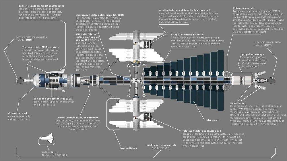

Why? Radiator mass. The greater the heat generated by a high performance rocket, the greater the radiator mass is required to radiate waste heat.
None of the popular scifi vessels look like this, and a sustained fusion vessel would likely have huge rad fins. Same goes for AM.
The way to avoid massive rad fins IRL is to increase the propellant mass flow, letting your propellant shed the waste heat away from the engine directly. The trouble with this is space is mostly devoid of propellant, so one cannot afford to burn it all up constantly.
Ways of getting high thrust with long burns and low fuel mass required tend to have high energy levels, that requure massive rad fins.
The conclusion is everything has a cost and that balances out any pwrceived advantage.
So what if I have a beam core rocket that allows me to thrust for hours on end... my cooling and rad fin mass cuts into my max thrust anyway. Lowering it.
Ironically the only spaceship designs that have highhigh thrust without huge rad fins are pusher plate propulsion types. The engine heat happens outside the vessel.
