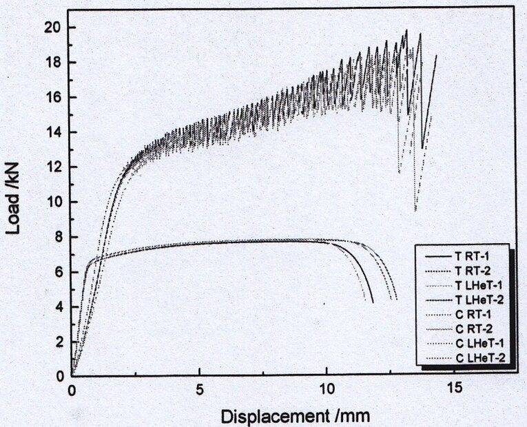

Hi everyone, recently I was working out an elasto-plastic model to make some residual stress predictions: see it here.
Recently I got some real tensile tests results from a lab, therefore I would like to extract a better stress-strain curve to plug into my elasto-plastic model using the Ramberg-Osgood equation. The problem is that I cannot get the Young's modulus that they claim to have obtained!
Here's the tensile test plot:
The stress-strain curve I would like to extract corresponds to the plots on the bottom part of the image (ultimate stress around 7.5kN).

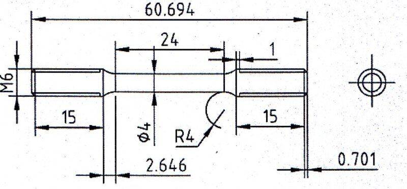

The geometry of the samples is the following:

  • ##\mbox{- Yield strength: } S_y=480\mbox{ MPa}##
    • from the plot we get ##6{kN}/(\pi 2^2)=477.5\mbox{ MPa}##. OK here!
  • ##\mbox{- Tensile ultimate strength: } S_u=615\mbox{ MPa}##
    • from the plot we get around ##7.5{kN}/(\pi 2^2)=597\mbox{ MPa}##. OK here too!
  • ##\mbox{- Elongation: } 54\%##
    • from the plot, we see that it has been elongated up to around 12mm, which, if we consider the length of the sample to be 24mm, it corresponds to these 50%. Also fine!
  • ##\mbox{- Young's modulus: } E=187\mbox{ GPa}##
    • I unable to get this result... from the plot, the displacement corresponding to the Yield strength (##@6\mbox{ kN}##), ##S_y=480\mbox{ MPa}## is around 0.6mm, which then leads to a strain of ##(24.6-24)/24=0.025##. Consequentially, this gives me an order of magnitude lower for Young's modulus: ##480/0.025=19.2\cdot10^3\mbox{ MPa}##, i.e., ##19.2\mbox{ GPa}##.
What am I doing wrong here?
Thanks in advance!
Where did the 187 come from?
This is the value declared from the lab report (it's not mentioned how it was calculated).
I was just trying to calculate it (and cross-check it) by myself based on the plot results.
Ah, this is a 306LN stainless steel.
Maybe there's a typo, and a decimal point was omitted?
No, for sure that it is not a typo. Also, for stainless steel, 190GPa are the "normal" values... I just don't get what is happening in the elastic part of this Load VS Displacement plot.
They have done other tensile tests on similar samples, and the values are also similar.
Typical strain values for steel at yield might be in the order of
0.002 rather than .025. Something funny with the decimal point here. Factor of 10. Something is amiss.
