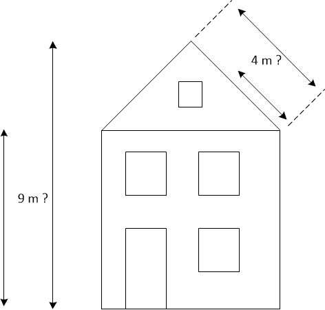

a man slides off a roof that makes an angle of 45 degrees below the horizontal. friction and air resistance neglig. he slides 4m, falls off and lands a certain distance away from the building. another man stands 4m away and is 1.2m tall. how far from the building does the falling man land and does he hit the man below?
i don't really know what to do here.
all I've done so far is found the horizontal component (u) of the roof he fell off of. i don't even think that this is relevant.
cos45=u/4m
u=2(sqrt2)
guidence?

Yeah the height of the roof was given.. sorry its been a long night.
The height of the roof is given as 9m.
I remember doing FBD diagrams where an object was sliding down an incline, and I recall that there was an x-component to the forces when gravity was the only actor. I suppose I should review that.
It was probably a bad answer on my part to say there is no x component of gravity because it all depends on how you define your axes.
Edit: I guess I tend to think as the y-axis being vertical and x-axis being horizontal, but that certainly is not always the case. And as a matter of fact, for the first part of the problem (sliding down the roof), it seems to make more sense to NOT define the axes as vertical and horizontal. I would define the +x axis to be in the direction of the downward slope of the roof.

OK, we've dealt with that. Now what about a little sketch of what's happening ?
Not so hard, or is it ? We do get another bit of input in post #10, but I still have a little something missing to draw the picture for you !
Is the 9 m the top of the roof ? Where does the 4 m start ?
