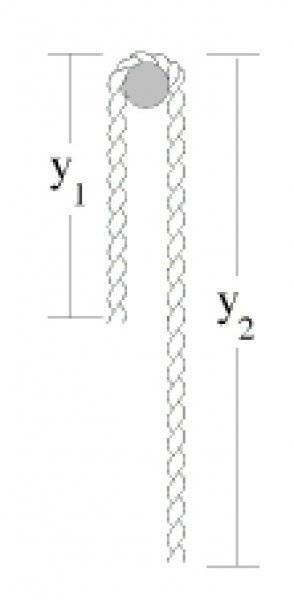

A limp rope with a mass of 2.4 kg and a length of 1.3 m is hung, initially at rest, on a frictionless peg that has a negligible radius, as shown in the Figure. y1 is equal to 0.44 m. What is the vertical velocity of the rope just as the end slides off the peg?
ΔU+ΔKE= Uο+KEο
U=mgh
Ke= .5mV²
I've gotten Vf=√2gh after having Vο equaling 0 m/s
mass cancels out throughout the formula
Shouldn't Δh just be y1?
but I'm still incorrect what i am I forgetting or doing wrong?

Can you show your detailed calculations? Also, I would have started with the centers of mass of the two pieces for the initial PE calculation, and compated that to the PE of the COM of the full rope just as it finishes slipping over the peg...

I'm just saying that my approach to this problem would be to find the initial PE of both pieces of rope (from the lengths and the mass that is hanging on each side). I would use the COM for each of the 2 pieces of rope. That gives the two initial PEs.
Then I would calculate the final PE with the whole rope hanging on one side, and use the full rope's mass at the COM for that calculation. The delta PE should give the KE gained (as you know)... :smile:
Can you try sketching the initial and final COMs (with lengths down from the peg and the masses in each case)?

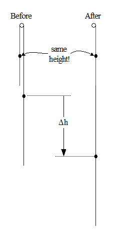

Here's my version of the sketch. Centers of mass for the rope segments are indicated by the black dots:

Ok so the left side's mass is (.44/1.3)*2.4 = .81 kg and its change in height is zero since the whole rope goes down by the length of the left height
and the right side's mass is (.86/1.3)*2.4 = 1.59 kg and its change in height is just the length of the left side
When you ask for final distance of the peg to the rope's COM do you mean the whole rope of the COM from just the right side?
And its mass is still 2.4 as a whole

For the system as a whole you can write (thanks to energy conservation): ΔPE + ΔKE = 0.
In this case the net change in PE is due to only the mass "y2" falling by Δh = y1, confirmed by visual inspection of the sketch. So calculate its change in PE.
The change in PE translates to KE via energy conservation. The KE applies to the entire rope (entire mass), so find the velocity accordingly.

You seem to be making your life difficult by blending changes in quantities with initial values. Really all that matters is the changes. Sometimes when things are complicated you need to detail initial and final positions of several objects in order to determine the changes, but here it's really straightforward: There's only one mass' change in position that matters.
You can pick out the relevant change from the diagram. You have one mass, ##m_{y2}##, which changes in height by an amount ##\Delta h = -y_1##. So ##\Delta PE## is ##-m_{y2}~g~ y_1##. Calculate its value.
Then change the sign and call it ##\Delta KE## (thanks to conservation of energy). After that you can write the usual formula for KE and solve for v.
Likes berkeman and Matt951
Thank you! I finally got the answer. I just keep on over complicating my formulas which makes everything so much harder than it needs to be
