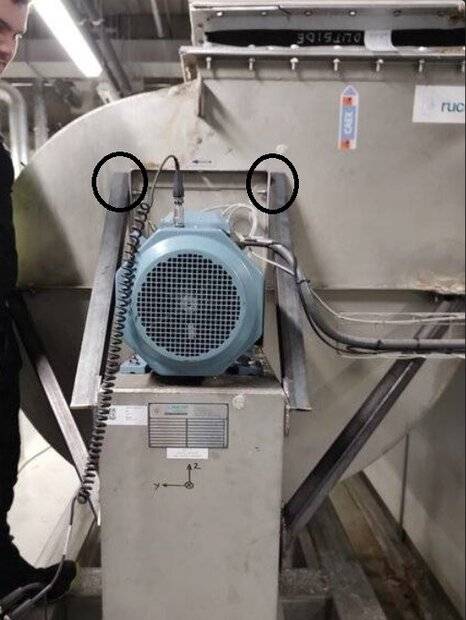

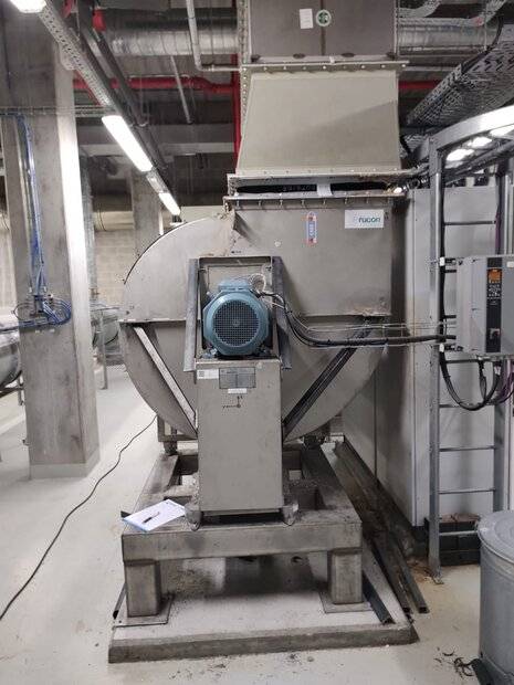

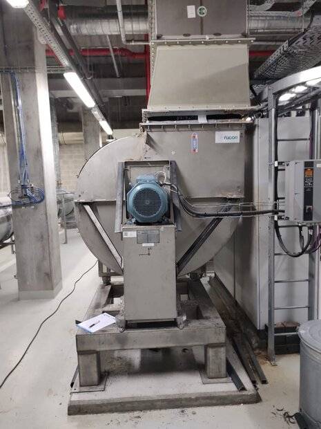

Hello everyone,
I am a student doing an internship at IMEC, Belgium. I am studying a fan driven by a motor. This fan-motor system goes into resonance at a control frequency of 36.2 Hz. This corresponds to 18.1 Hz impeller frequency. The operating range of this fan is 30 to 40 Hz, so we can't just skip these frequencies. We have tried several things to get the system to stop resonating, but nothing seems to work. We have already realigned the shaft with the motor. (Motor and fan are directly coupled) We've also tried replacing the impeller with a new one, replacing the bearings, adding reinforcements to increase rigidity, and we've even put better vibration dampers under the system. I don't know what else I can do, so I'm asking for your help. Feel free to comment with your findings. Thanks in advance!
Arno Vonck

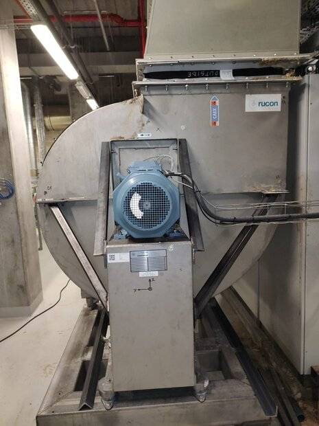

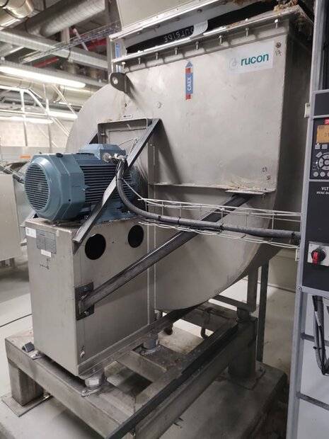

Could you post a picture of the system?

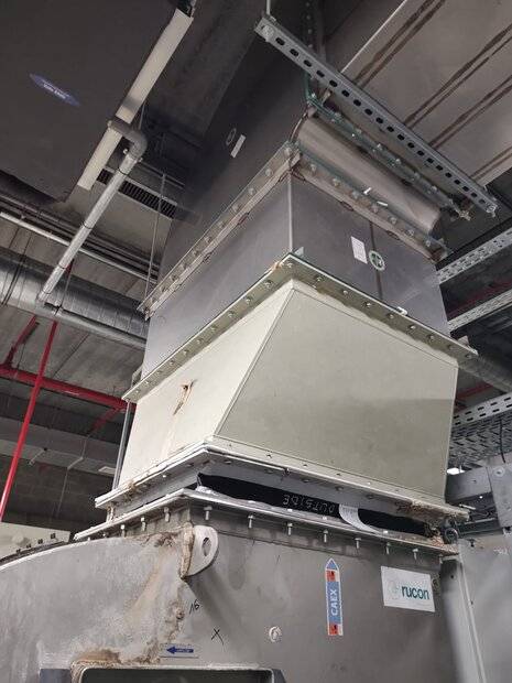

Does the fan operate in a duct? How long is the duct?
What type of fan or blower? How many blades?
Likes ArnoVonck and Rive

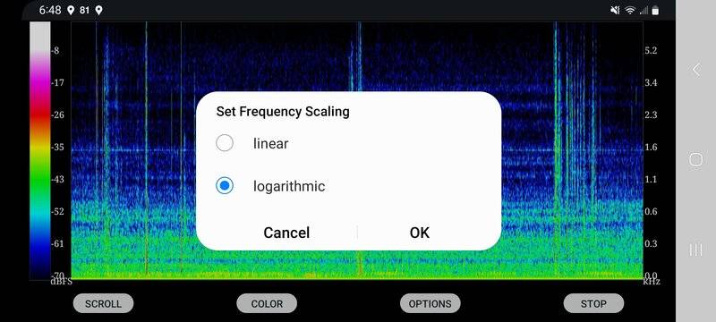

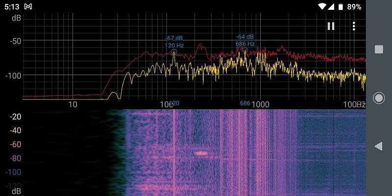

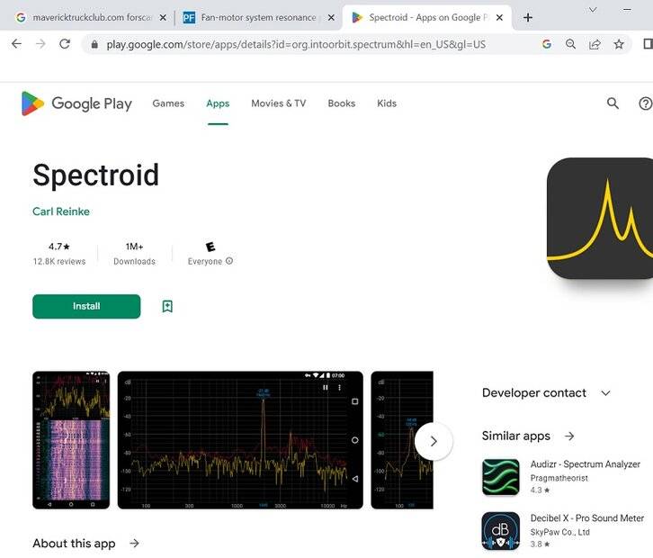

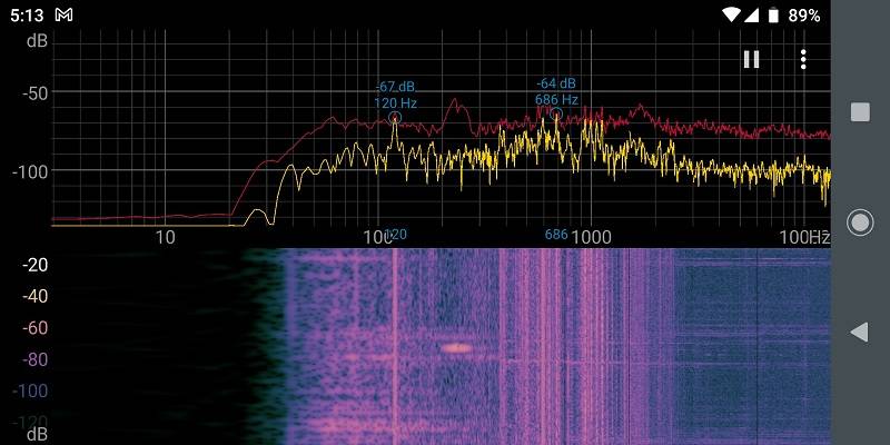

There are cell phone apps that display frequencies in the audible range. The screenshot below is from one such app. It shows the frequencies from a noisy fan on my heat recovery ventilator. The 120 Hz frequency is probably magnetostrictive vibration in the blower motor, and the closely spaced frequencies around 1000 Hz are from the noisy bearing.
A pair of similar screenshots from you would be very helpful. One at the bad speed, the other at a good speed.
Likes ArnoVonck, Rive, DaveE and 1 other person
Cool app! What's it called?
Lnewqban said:
Could it be that the fan is working on an oscilating or surging zone of its operational curve?
Does its perfomance vary while the resonance lasts?
That's my guess. If the fan is balanced there can't be any vibration/mechanical resonance, so it would have to be a surge problem. We'd need to see the fan curve and get a measurement of airflow and pressure to verify where it is operating on the curve.
In general, high pressure + low flow = surge.
Spectral Pro Analyzer for Android. In general it'd be a search for "frequency spectrum analyzer".
The app is Spectroid.
One of the reviews (boldface by me):
Frankly, this app helps restore my faith in humanity. Simple. Clean. Elegant, useful. No ads, no popups. I know the author points out he can't calibrate but just for fun, pull up an online tone generator on an adjacent computer and try comparing the results. I'm using this to debug some objectionable noise from some industrial fans. What a nice find. Thanks. Like a few others, I'd love the ability to record an audio clip along with the spectrum analysis. Not a big deal though. Bravo
Likes Rive, russ_watters and berkeman

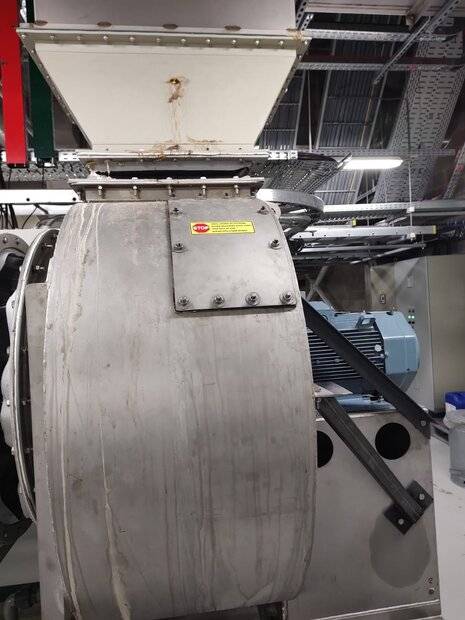

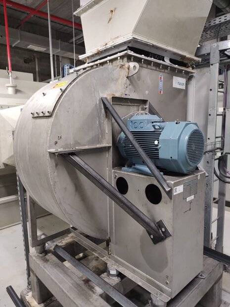

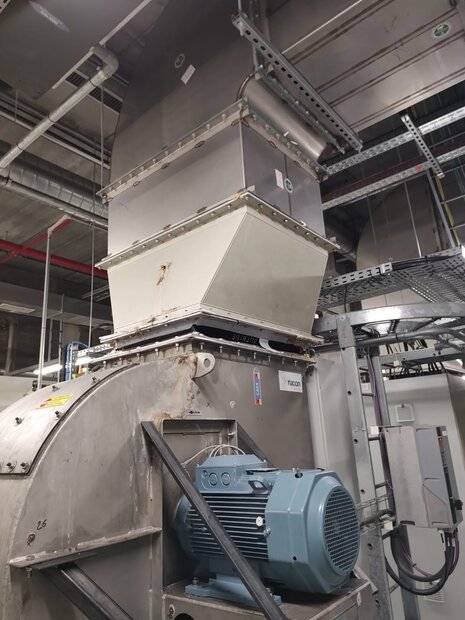

Do you have access to a strobe light? It might be instructive to slew around near resonance and at resonance to see what-all is moving. That may help to give you some clues as to how to decrease the movement and resonance(s).

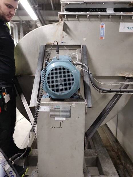

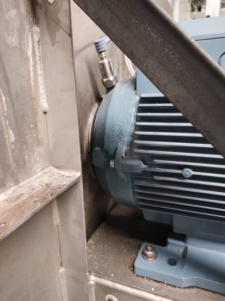

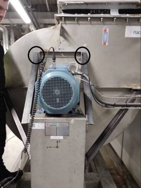

I do not have access to a strobe light, we did do motion amplification measurements and other standard vibration measurements on the fan and motor though. These told us that the 'snail house' and motor base were moving into eachother. I actually have some great videos of this but I just noticed you can't attach video's to a post. I added a picture of the motor-fan system though.
Thank you Lnewqban.
I may have phrased it wrongly. A frequency of 40 Hz coming out of the VFD, corresponds with a mechanical rotation of 20 Hz. Well, I would like to show you guys the videos we made, is there any way to upload them here? This way you could all see the way the system behaves when vibrating. I don't know about the oscilating/surging zone, I will look into this! I don't think the performance varies while the resonance lasts.

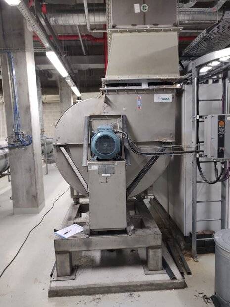

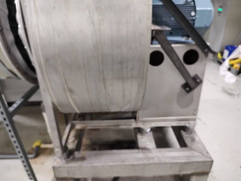

Exactly, the fan spins at 1086 RPM.
- Yes, 1086 RPM at 36,2 Hz drive frequency.
- I don't think these are pneumatic vibrations. I think it's a mechanical issue. Motor and fan are as it were, moving 'into' eachother whilst vibrating.
- The main resonance frequency of the system is 18,1 Hz (36,2 VFD frequency), when the fan rotates at this frequency, the system starts to heavily vibrate. This isn't the only frequency on which the system vibrates though. When I get the results of our new measurements I'll share them with you guys.

It pushes media into a duct yes. The media is NaOH. We've actually separated the duct once and let it rotate freely. The system still goes into resonance. It's a centrifugal fan (radial) with backward curve impeller type. I actually don't know the amount of blades and I can't find it in the documents available to me.

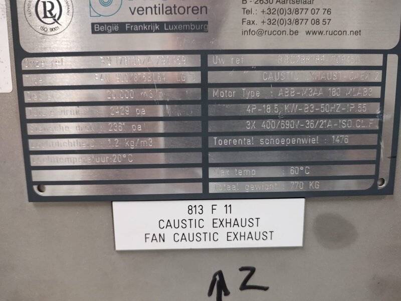

The nominal flow of this fan is 20 000 m³/h. I'm looking for the static pressure and fan curve, I'll upload it here when I find it.
Video 1:
Video 2:
ArnoVonck said:
The nominal flow of this fan is 20 000 m³/h. I'm looking for the static pressure...
This doesn't mean anything: they need to be measured (unless the engineer made a selection mistake, which is unlikely to be the problem here).
Does the document attached suffice?

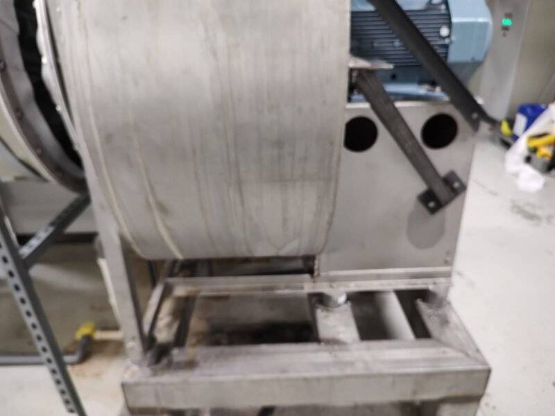

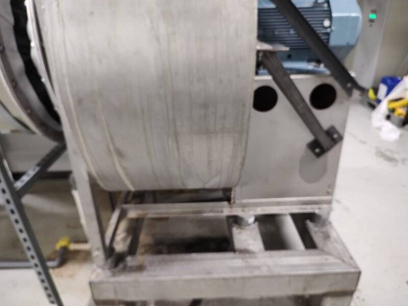

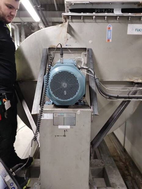

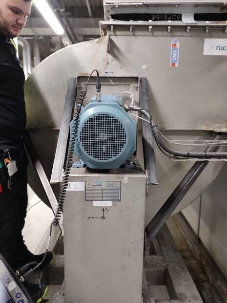

Thank you for the pictures.
Could you show some pictures of the coupling and bearings?
It appears that the blower is supported by its side plate, and that the vibration is flexing that side plate. If that's correct, the vibration will eventually cause the side plate to crack, with the cracks starting at the two points circled because those two areas are where the most side plate bending is happening.
Run the speed up and down through the bad speed while closely watching those two areas. It looks safe to touch there, so holding your hand there will tell you a lot. If the motor base is relatively still, the side plate close to the steel angles is still, and the side plate outside the circles is vibrating, then the problem source is almost certainly located.
Let us know what you find because that will determine the next step.
Also, balancing the impeller cannot hurt, and will almost certainly help. But it will very likely not cure the problem completely.

Yes the impeller has been replaced with a completely new one. Both have been balanced, statically and dynamically. I'm kind of rethinking the weights on the impeller to balance it out though. I might take them off and do a run-up again.
The fluid being transferred is NaOH dissolved in water. Its purpose: to bring the pH-value of water with low pH-value up. There is most certainly some deposits on the vanes. But the problem was already there before the build-up of these. I'm not on the company right now. But it's not that easy to show pictures of bearings and couplings since the place has to go in shutdown to turn the fan off. (It runs on 30 Hz now)
I'm planning a moment to do changes to the unit and keeping all of you guys' thoughts in mind to do them during this moment. I'll keep you guys up to date for sure though!
We've actually done a new vibration measurement on the entire motor-fan unit, on many different measurement points etc.. I'm still awaiting these results but these should be in by monday. Btw: The diagonal bars you see from motor base to snail house, together with the vertical bars from motor base to snail house weren't always there. We put them there on advice of RUCON (the manufacturer of this fan) because they thought it might help. It didn't..

... it's not that easy to show pictures of bearings and couplings since the place has to go in shutdown to turn the fan off. (It runs on 30 Hz now)
No problem, just trying to understand the arrangement of motor, coupling, shaft, air seal (if any) and bearings.
If not possible, pictures from different angles around the fan could help us.
It seems to be a cantilever impeller arrangement, which can make vibrations worse.
One of your pictures seem to show a solid bridge by-passing the isolation of duct-fan provided by the canvas connection.
Any luck with a video via YouTube?

  • #35
I'm sorry for the late answer. I've been on a holiday. I've went and took some pictures of the entire unit to maybe get you a better idea.
  • #36
When you run it a rated design rpm (1470 rpm), are you getting rated static pressure?
Are there other systems tied into the duct? I assume it's going to a scrubber?
Likes russ_watters and ArnoVonck
  • #37
Based on Video #2 in Post #17, it appears that the blower housing has a mechanical vibration at 18.2 Hz. Mechanical vibrations are analyzed as spring - mass systems. The mass in this system is the blower housing, the spring is the side of the housing in the photos, and the motor base is fixed. That's why the request for the test in Post #27. Sometimes, your fingers are all the test equipment that you need. This might be one of those times, but you need to run the test to find out.
If so, the remedy is simple. Weld on a pair of stiffeners as shown by the heavy black lines in the image below.
You can leave the angled braces where they are, or make new ones that connect the same location on the base to the top of the stiffeners.
The theory is as follows: Natural frequency = ##\sqrt{\left( \frac K M \right)}##, where:
K = Stiffness
M = Mass
Since we want to increase natural frequency from 18 Hz to a value above the maximum operating speed of 30(?) Hz, it is necessary to increase the ratio of K to M by about a factor of 4. Reducing the vibrating mass that much is not practical, but it is practical to increase the stiffness. The stiffness of a thin plate is very low, and it is easy to increase that stiffness by a factor of several times by adding the stiffeners shown.
Likes russ_watters, ArnoVonck and DaveE
  • #38
A thought: Those diagonal stiffeners ? Do they resonate ?? If so, can you add masses to 'quench' them ??
No we don't get rated static pressure. Indeed, it's going to a scrubber.
  • #41
I'm assuming your s.p. was too high, which was why it is currently being run at 1086 rpm? Or is it the vibrations just passing through 1086 rpm on the way to 1470 rpm the issue?
